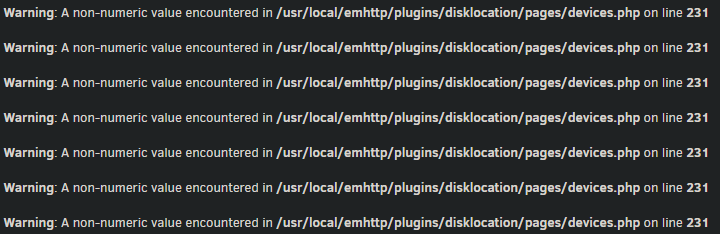

Just noticed this error message pop up on my Dashboard recently (Keeps repeating itself): Warning: A non-numeric value encountered in /usr/local/emhttp/plugins/disklocation/pages/devices.php on line 231
Went into that file and it is referring to this line: $smart_powerontime = ( !isset($data["smart_powerontime"]) ? null : "<span style=\"cursor: help;\" title=\"" . seconds_to_time($data["smart_powerontime"] * 60 * 60) . "\">" . $data["smart_powerontime"] . "h</span>" );
Everything still looks to be working fine with the plugin but I would like to get rid of the error message from my Dashboard if anyone can help please?
1 hour ago, Ronshizel said:
Hello,
Try to write "0" (zero without quotes) instead of "null" on that line and see if it disappears, then I'll update that on next release
Didn't work sorry. I changed it to zero and saved, exited. Error didn't go away so I rebooted. On reboot the zero changed back to null as well.
I don't see this warnings myself, but please try to replace the "!isset" with "!is_numeric" instead, and see if that helps?
Do not reboot, this will just reinstall plugins and all changes you have manually done.
Yes that fixed it! I also kept the "null" at "0"
Thank You

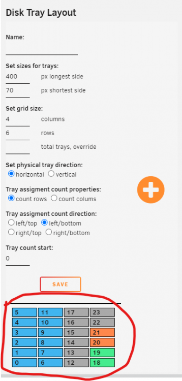

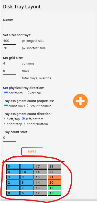

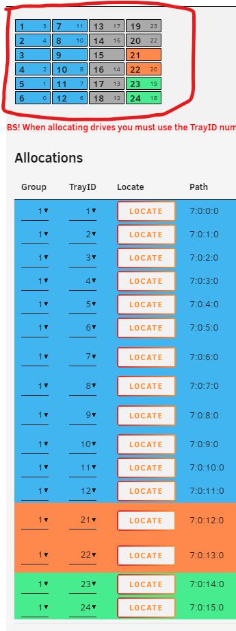

There is a problem showing the right disk order and showing the right assignment:
Any suggestions?
Thank you!
Any suggestions?
Thank you!
And what's the problem? You make sure to read that TrayID is not the same as the chosen numbering of the trays?
