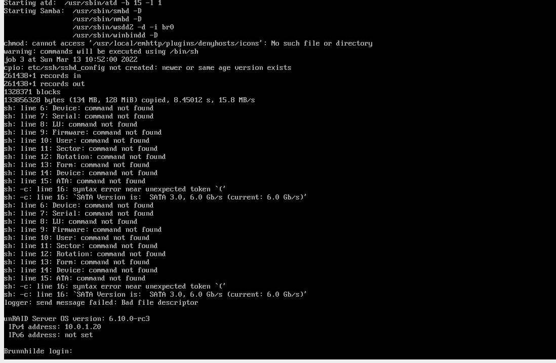

Console errors on boot after updating to 6.10 RC-3.
359817117_ScreenShot2022-03-13at10_56_02AM.thumb.png.67f19cfaad6e3c7ba0bc6e872ede3713.png
Plugin still seems to be working though.

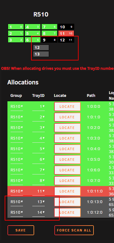

@olehj
Seems to be a little bug in the layout page.
The drive numbers are duping drive 12 when it should be continuing at 13 & 14.
image.thumb.png.4a3d17d794f5ecabacd2fb4a7e1e5fe2.pngimage.thumb.png.662aab0ebf08f58e93e2ea999ca49bb6.png

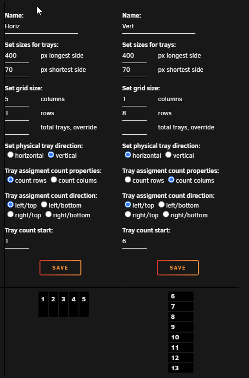

I may be daft, but is there a way to have a custom layout for disks.
In my server I have a 5 3.5" hdd into 3 5.25" drive cage at the top. and then 8 hard drives stacked one on top of the other underneath that.  Like so -
Would it be possible to do a layout like that or do I have to use the standard rows and columns
Edited by go69cars
I suspect you could create two layouts. One horizontal and one vertical and assign the drives appropriately.

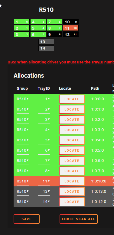

Update 2022.05.03
  • Commit #180 - BUG: Wrong numbering in the layout if using tray override - and please don't use tray override, just add another group. Count assignment still bugged if not using default, but won't affect assigned drives.

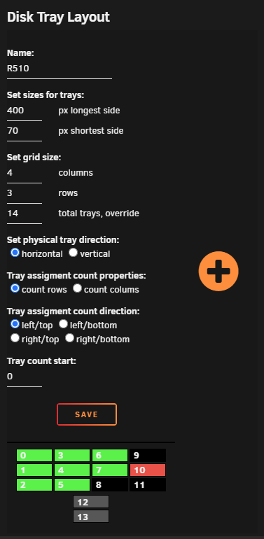

On 5/2/2022 at 6:26 PM, olehj said:
Update 2022.05.03
@aglyons
Curious, why don't use tray override? If we shouldn't use that, why is it there? What was its intended use case?
That setting was actually perfect. I have 12 external trays on the R510 chassis with two internal 2.5" bays. Creating a whole other layout for 2 drives seems overkill.
I didn't think this issue would really affect anything, I saw it more of a cosmetic concern.
Edited by aglyons
Try the fix and see if it helped you.
The override was part of the initial release before the groups were even added to provide with some alternative. There's no overkill, speed limits, or excessive data involved creating multi-groups. Override has mainly stayed there for backwards compatibility really. - I do consider deleting it in the future.
YUP!, good to go.
21 hours ago, wgstarks said:
Boot errors with unraid 6.10-
1030932944_ScreenShot2022-05-17at6_48_09PM.thumb.png.230fe4946910e3bfbe546a3029c95043.png
I posted these a while back but thought I should repost now that 6.10 stable is released.
As far as I can see from the logs, Disk Location installs as it should. However, I see some weirdness with whatever this is: "Mercury Elite Pro Elite Pro"
Does not seem related with this plugin, and I can't recreate the problem. The S.M.A.R.T. data on that disk, or kontroller, or whatever it is, is likely causing the issue.
Sorry, nothing I can do.
Ok. I was informed that those lines of code were from the disk location plugin so I was just reporting the errors. Not an issue for me.
