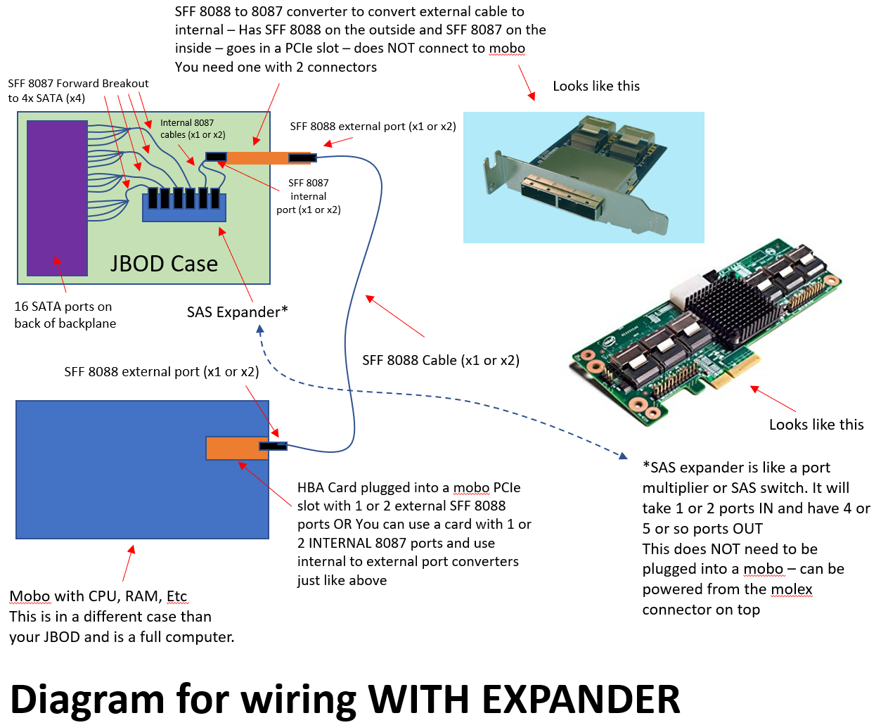

  2. why not just run external sas to a sas expander in the apple xraid chassis from your current server. You could retain your current power supply and just use it as a storage enclosure. Attached a picture of how that can work

  12. yeah expander cards work just like a dumb network switch. Just input one sas cable in and then sas cable out to the rest from expander card. If you are not using any SAS drives you could use two cables in and one would work as a failover (with sas drives it tries to do dual mode sas which unraid doesn't support and you end up with drives listed twice with different addresses)
  13. None of my Sas drives show up. Attached lsscci -ug output. I know you havn't updated the plugin yet but just posting now that 6.10 is stable lsscsi ug output 5.21.22.txt
  14. This listing looks like the same card as the tri-mode based on comparing specs but i guess it could be a knockoff. - https://www.ebay.com/itm/284672380344?mkcid=16&mkevt=1&mkrid=711-127632-2357-0&ssspo=JnVW1VgjTbK&sssrc=2047675&ssuid=&widget_ver=artemis&media=COPY Another possible route to go would be to just use a 12g sas expander card and a much cheaper 12g sas card like a 9400-8i. I'm running single sas cable 12g into a backplane and still max out drive speeds just fine with tons of drives including 4 ssd sas and 3 sata sas
  15. yes. There is no way to interface with your drives without a sas card. The expander doesn't provide anything other than making more sas ports for you to connect stuff up with The expander card can just be put in whatever slot it fits in. The smaller the better as it literally is only getting power from the pcie slot. You don't need to use the external port for it at all. Just connect your sas card into whatever expander port is easiest. Sounds like you want to go sas internal 8087 to sas internal 8087
