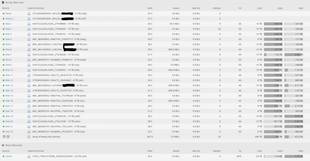

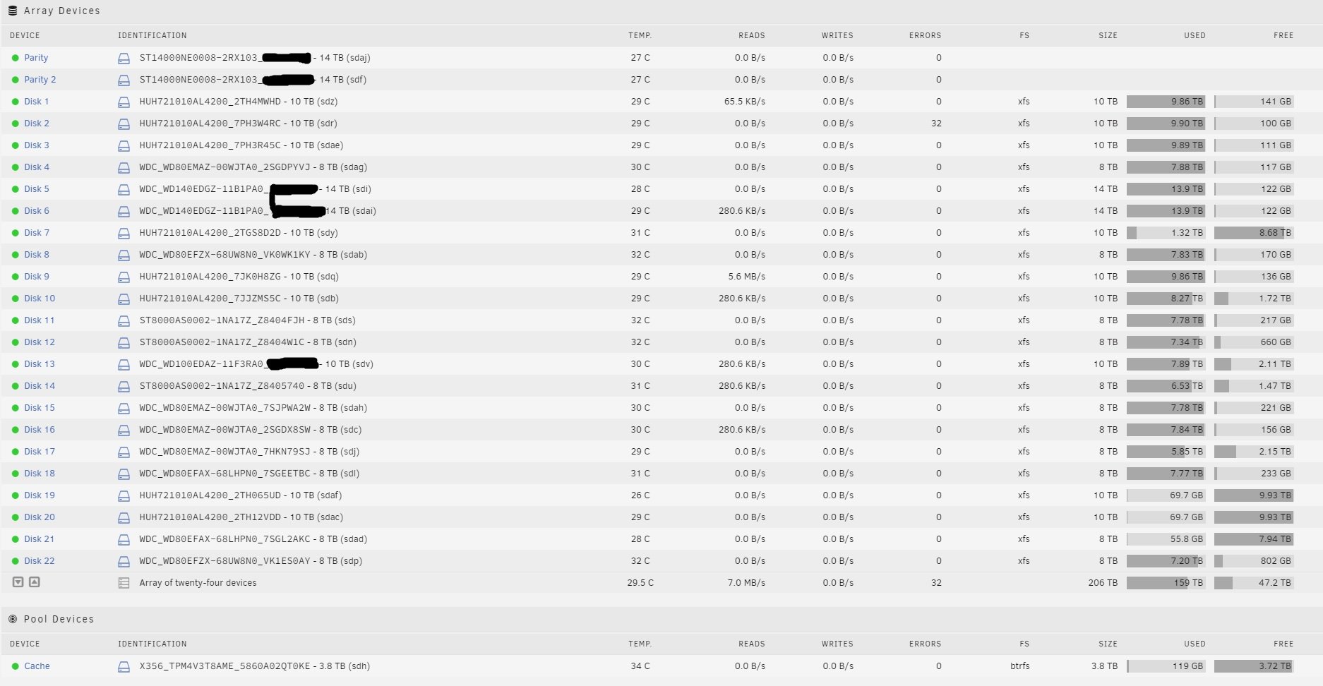

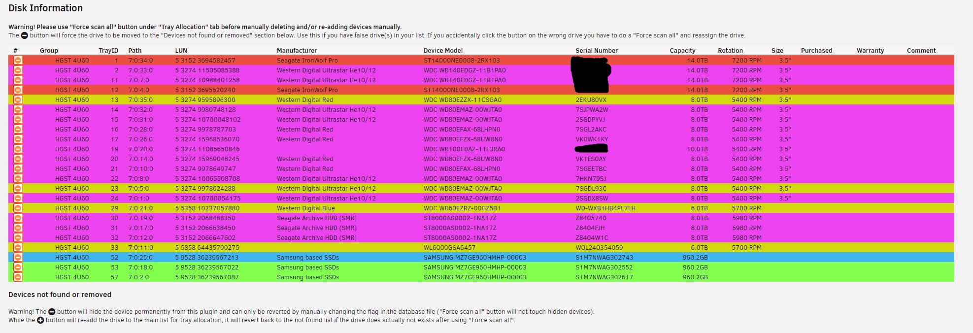

  4. @olehj Yay that worked! I now see all 30+ drives after spinning them up and scanning. Now to reload the backup I made and sort them to their slots. Thank you for all your hard work! Enjoy some beer
  5. Yep everything is up to date. I backed up then deleted the database and it still shows the same drives from scan when I tried it checked with smartctl -all /dev/* and they all have different serial numbers, vendors, product, revision and logical unit ids I've attached 4 drives i checked with smart with all info (not worried since they are old). Two 10TB HGST sas drives and my two main 3.84TB ssd sas drives unraid smart data 6.6.22.txt

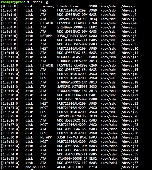

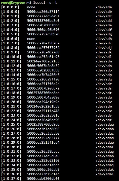

  11. lsscsi -u -b output and lsscsi -g output attached along with smartctl output that was sent to txt files. SG29 is a sata drive that is working, SG30 is a SAS drive that is not smartctl-sg29.txt smartctl-sg30.txt

  13. None of my Sas drives show up. Attached lsscci -ug output. I know you havn't updated the plugin yet but just posting now that 6.10 is stable lsscsi ug output 5.21.22.txt
