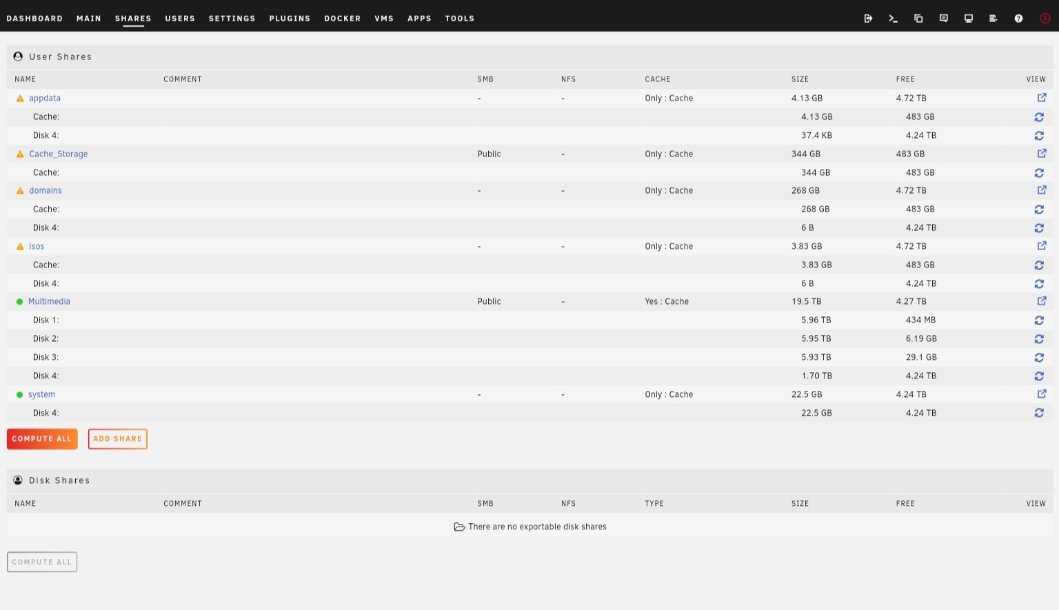

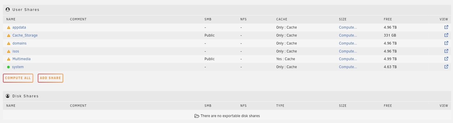

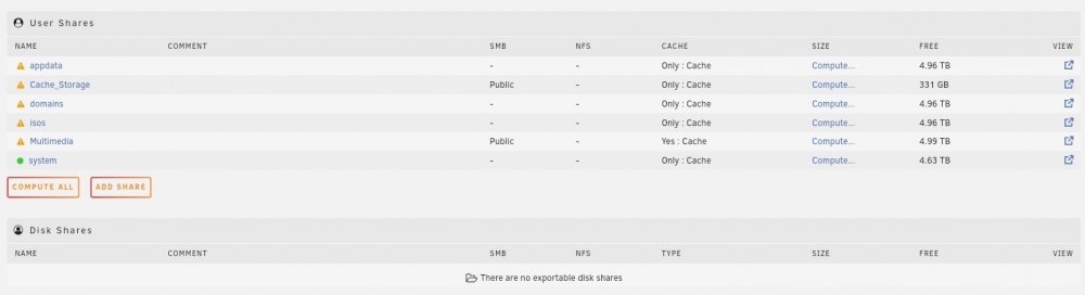

  2. I have another issue. I tried to add another cache drive as I wanted two separate cache. I added it as a pool by mistake, I then created a separate pool and added them separately so I had two cache pools now. As they were acting as one pool before, they had the same data on, I deleted the data off of the new one - it deleted from both! (even though they're separate pools). After I got over the fact that I have to install/set up everything again I restarted so that unraid could build the share folders again and both pools are acting as one, I have the shares on both caches but on the share tab they are only assigned to cache 1. diagnostics-20220904-1837.zip
  3. All sorted Thank you for helping my fix a problem that I didn't even know I had. Just to confirm, the reason I had to turn off docker and vm was so that they would create new images in the right place? (that's what I did)
  4. Appdata, domains, isos and system should all be on the cache drive only, I didn't want any of those on the array. When I completely reinstalled unraid I had those shares on my cache drive which were not touched, I then deleted the new versions of those shares from the new install of unraid so that I could use my existing shares... if that make sense. I messed up, didn't I?
