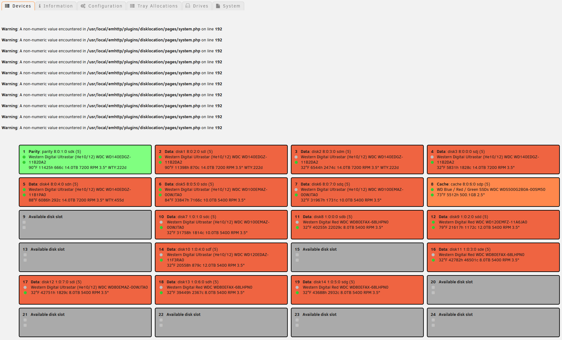

Love the plugin, running the latest version 2023.04.04 on unRAID v6.10.2, but I'm getting an error message now:
Warning: A non-numeric value encountered in /usr/local/emhttp/plugins/disklocation/pages/system.php on line 192
Everything seems to be working fine for me but I did search for the error here and this has happened before and was fixed with an update to the plugin.  That thread is located here and was fixed with Update 2019.02.18b: Commit #53 - MINOR ISSUE: Found the actual line, checks for disksize value before calculating human readable size.
Any ideas?
UPDATE 1: All of the drives are active now and the error message went away, not sure if that helps debug the issue or not.  Please reference the second image.
UPDATE 2: Figured that it was a good time to upgrade to unRAID to v6.11.5, while all drives were spinning after rebooting the system the error message went away.  As soon as I spun four disks down the same exact error message popped up again.

FIXED
6 hours ago, FlamongOle said:
New minor update, should fix the above problem as well.
This did indeed fix the non-numeric value issue.  I have updated my post to reflect this.
Thank you for the quick response.

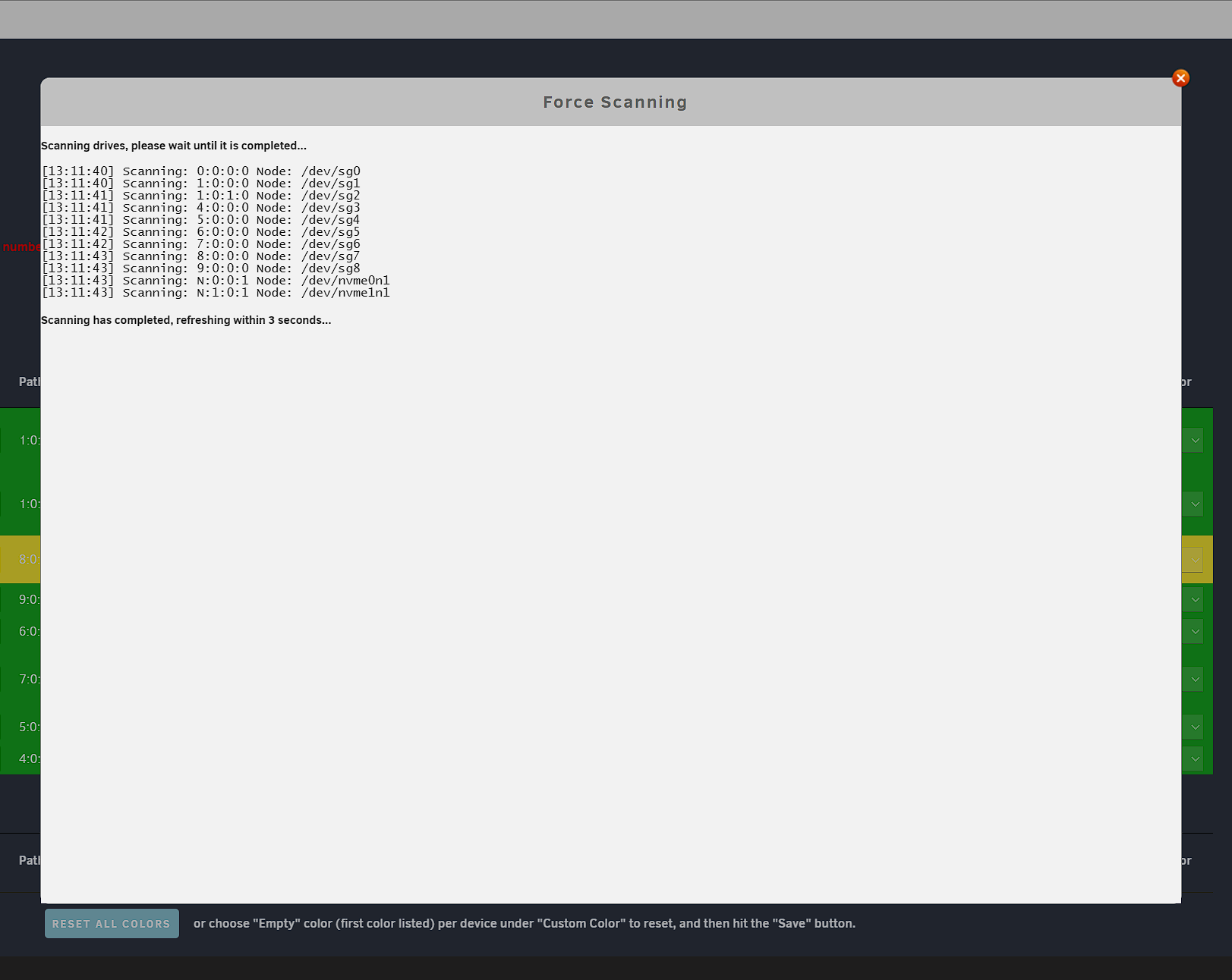

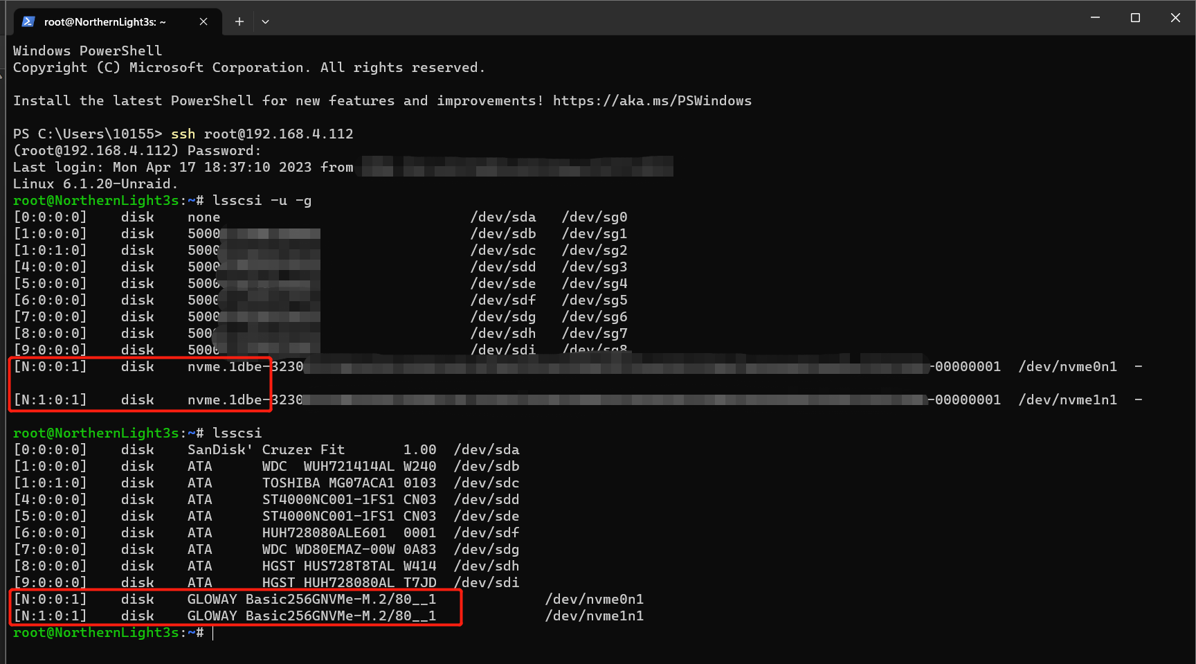

I see someone on github also mentioned about NVME ssds not showing up. I have the same issue here, where the NVME drives can't be recognized by your handy plug-in. And I have the output of "lsscsi -u -g" and "lsscsi":
I am currently running UNRAID 6.12.0-RC2 with 2 identical Gloway Basic 256G NVME ssd cache, and force scan can successfully find my 2 nvme drives, but it just can't be find under "tray allocation" tab. image.thumb.png.9c0d0594bacb5a36f8ffffffae161aff.png
BTW I want to mention that the 2 NVME was not able to be recognized by UNRAID at the same time before UNRAID 6.12.0-RC2 maybe because of the global duplicate IDs. I posted this problem on UNRAID forums and supports replied me to update to this UNRAID 6.12.0-RC2 version which solved the recognize difficulties in UNRAID. I am not a professional but do you think disk location may have the same global duplicate ID issue here?
The thread I posted on UNRAID forum: https://forums.unraid.net/topic/137442-solvednew-nvme-not-visible-globally-duplicate-ids/#comment-1248613
Edited by marco_yang

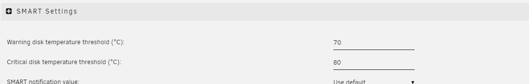

One thing I'm seeing is critical temp threshold is not reflecting what is configured per drive.  I have my NVMe SSDs configured at a drive level for warning at 70* and critical at 80*.  The Samsung SSDs are configured at a drive level for warning at 55* and critical at 65*.
Looks like warning is pulled correctly, but critical is the global config.

3 hours ago, ssnow said:
Enjoying the plugin!
Unraid version: 6.11.5
Plugin version: 2023.04.17
Did you force scan all recently? I know this was a bug at initial release. I might look into it soon, but too drunk now.
I had never done a force scan.  Just ran it and no change.
No major rush.  Just have a flashing drive on the dashboard. Have fun!

Was a typo in the variable, fixed with 2023.04.22
Thank you!

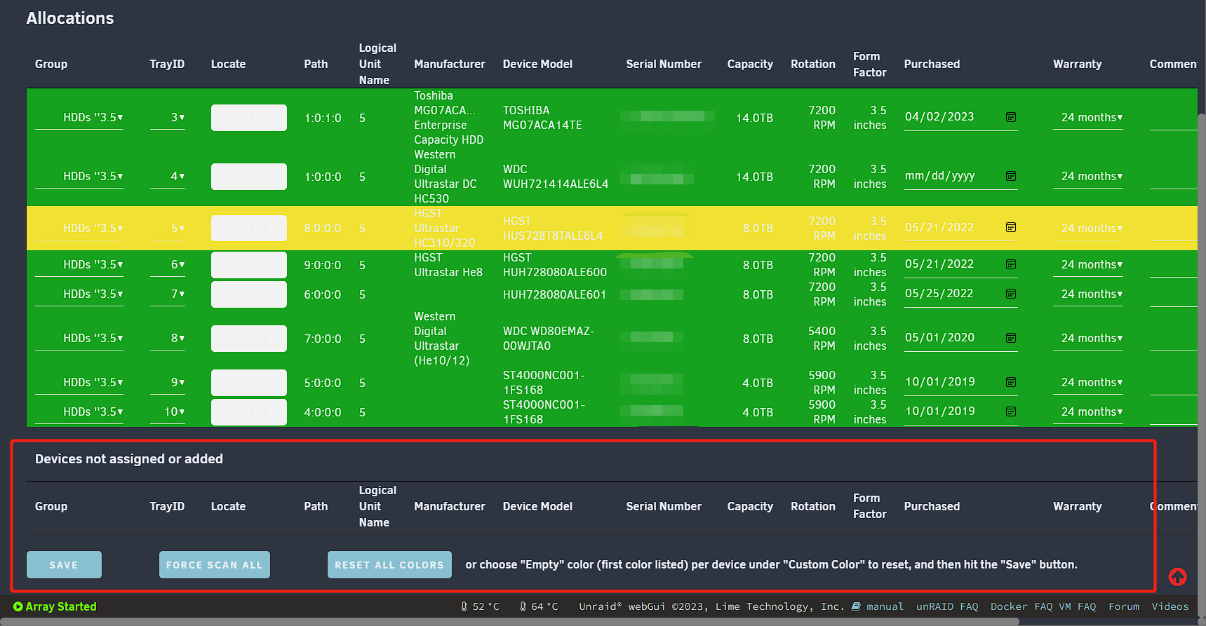

I just installed, and really like this plug in. However, I cannot seem to get the Main page to use the colors, for the drives, from the configuration page. I changed them but the old colors remain, or even began using new colors entirely. One category changed to black and I can't read any info at all 😆
Sorry, I can't replicate this. Check if you didn't mess up with choosing "heat map" and thinking custom colors would work. You have a "reset colors" button in the configuration too.
Thanks for replying so quickly. I did indeed change some colors on the heat map. The reset colors worked to set things right. BTW, the reset colors is on the tray allocation tab, for those trying to find it.

The heat map overrides all custom colors. The names for the main color definitions also renames accordingly when you toggle between "Disk Type" and "Heat Map".
Rather toggle "Temperature LED" and "Warning/Critical Flash" if you want some indication on a "Disk Type" view. There's no way to have them both as it defines the background color.

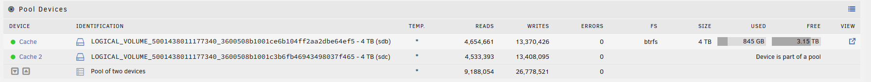

Hello, I rather enjoy this but have noticed that with 2 cache drives in my pool it only recognizes 1 of the drives for entry into the bay designation. Any assistance would be appreciated.
