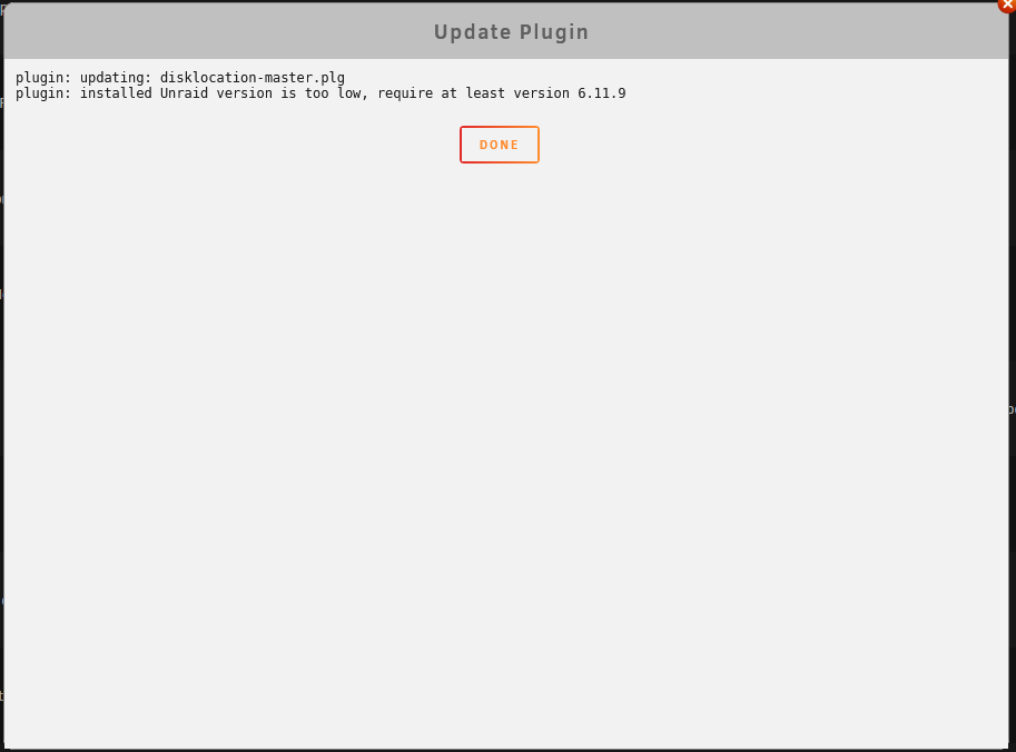

So I figured I could always restore the old one from backup anyways if it broke, but it looks like it shows an update button even though it prevents you from updating:
This is to be expected, as it might confuse users even more if the dashboard widget is suddenly gone after an update. 6.12 is under RC now and is probably soon™ released. "6.11.9" is set as minimum required as I'm not sure if setting it to "6.12.0" would include beta and release candidates and that 6.11.9 does not exists.

same issue.
Is it possible to change it, that the update will not be shown, when the system is not compatible?
I use unraid 6.11.5 on   2 different PC.
Since yesterday on both of them the Plugins-Section shows "Update".
But when I try to use it, the process tells me:
  plugin: updating: disklocation-master.plg
  plugin: installed Unraid version is too low, require at least version 6.11.9
  Executing hook script: post_plugin_checks
Why does it show me a possible update, when it is not possible?

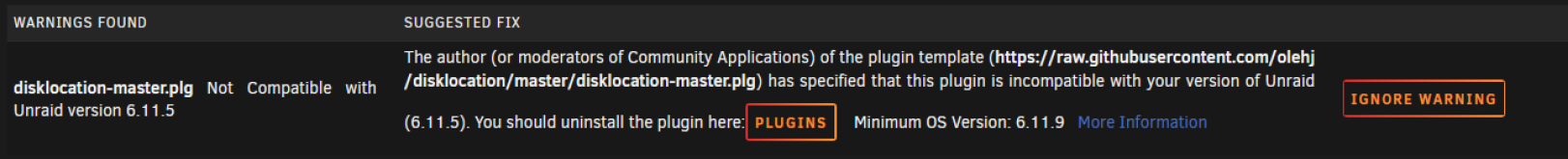

And to top it of: even 'fix common problems' does now mention this plugin in the warning section.

System AFAIK shouldn't have shown you an update being available.  I'd have to look at 6.11.5's coding
FCP -> Looks like you found a bug.

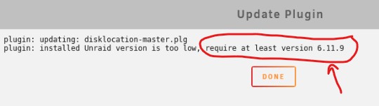

The only issue I have is that I usually update all of my plugins before updating unRAID (based on advice from update assistant). In this case I'm hoping that by the time 6.12 stable comes out, there won't be an issue with leaving this plugin as-is until after the update
It's already been answered. Read.

the newest plug-in update says min unraid version 6.11.9, the newest version is 6.11.5 can this be fixed
I believe that @olehj decided to make the latest update only compatible with 6.12+.  In other words, the minimum version the plugin now requires is 6.11.9 (a non-existent version)
Exactly that. Otherwise, the already installed version will be the last until the 6.12 upgrade. No new installs will be possible with older versions of Unraid unless the developer package is installed.
