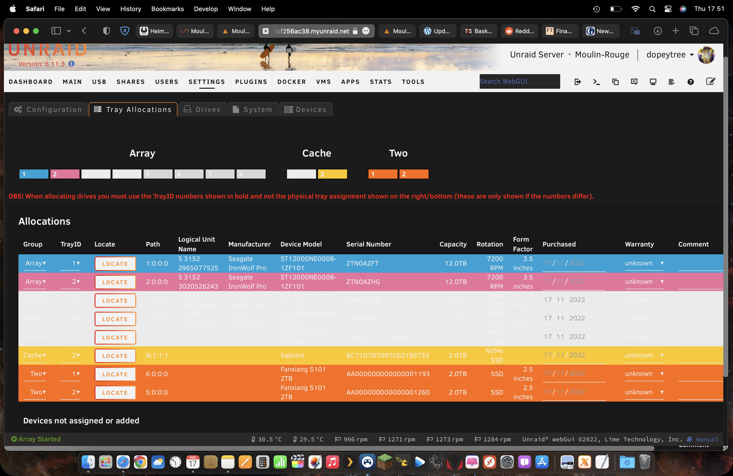

I have an x10 SM system and I bought a "cheap" 4 SSD PCI-e card off amazon (sedna - PCI Quad 2.5 inch...) and both the system and this plugin read each SSD on it separately. Only issue I had is the card was right over a heatsink on the board so one of the SSDs kept getting hot.
Got a problem with this when I add new drives it showing the 'DRIVE' colour as a light grey / white. but with white text.
I have reset the colour to be something else but no luck...
As you can see the 'Drive' colour is a pink colour for the other 'Drives' in the array so not sure why these new disk are showing as the grey unallocated colour.
Am on latest version & latest unraid  6.11.3
713759572_Screenshot2022-11-17at17_51_06.thumb.png.493016cc4c24e0cdd9725aaef32333b2.png
Edited by dopeytree
Hmmmm... does it work if you choose "dark mode" on Unraid? I always use dark mode and don't really think about these things. You can choose another color for the default "unassigned" devices too though.

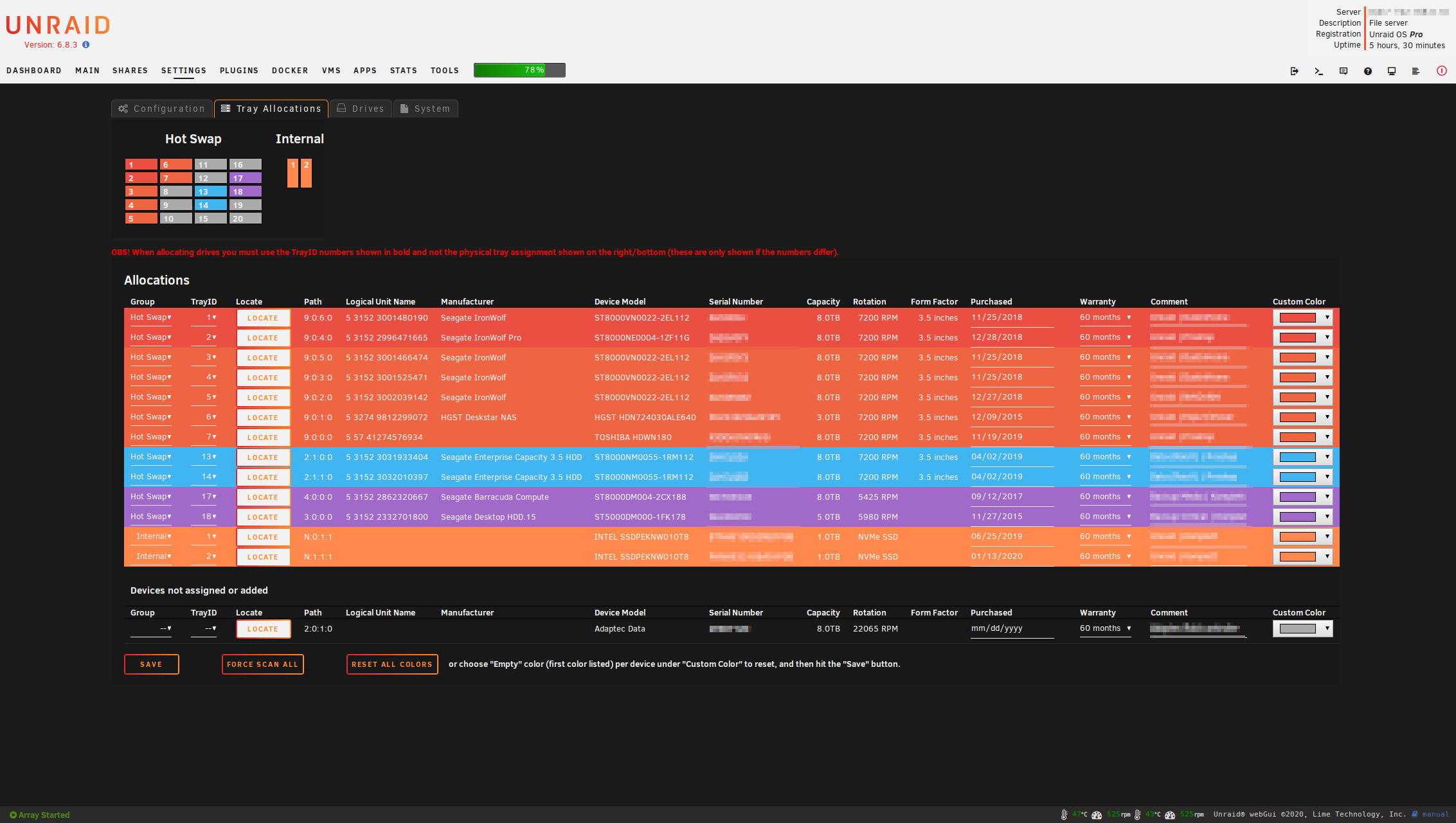

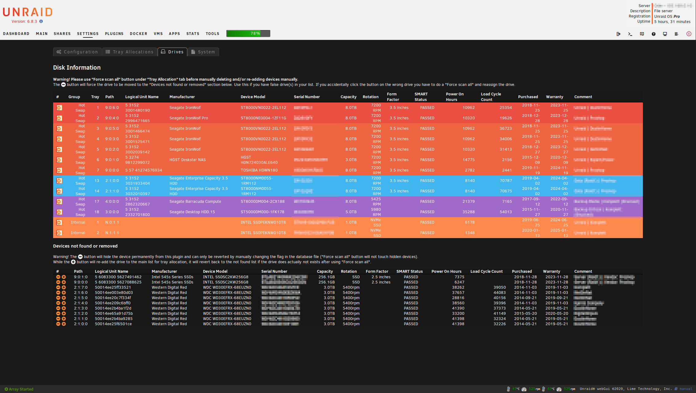

Pulling the Warranty info from UnRAID isn't working. It wasnt working in 6.9.xx
I'm now on 6.11.5.
Tried deleting the database, uninstalling the plugin and reinstalling the plugin, but still not pulling the warranty info.
All the Warranty info is agains the drives e.g
But still not showing in DiskLocation, have tried rescanning as well.
Edited by Jarsky
I'm also having a problem with the disk background color, it remains white when using the "black" theme no matter what I change the background colors too. I have tried it in firefox and chrome. What info can I provide to help troubleshoot? The information tab list also has a white background, making all the text basically unreadable.
Have to reset the colours then it seems to fix it

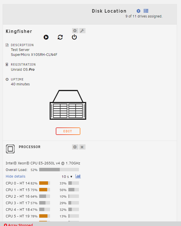

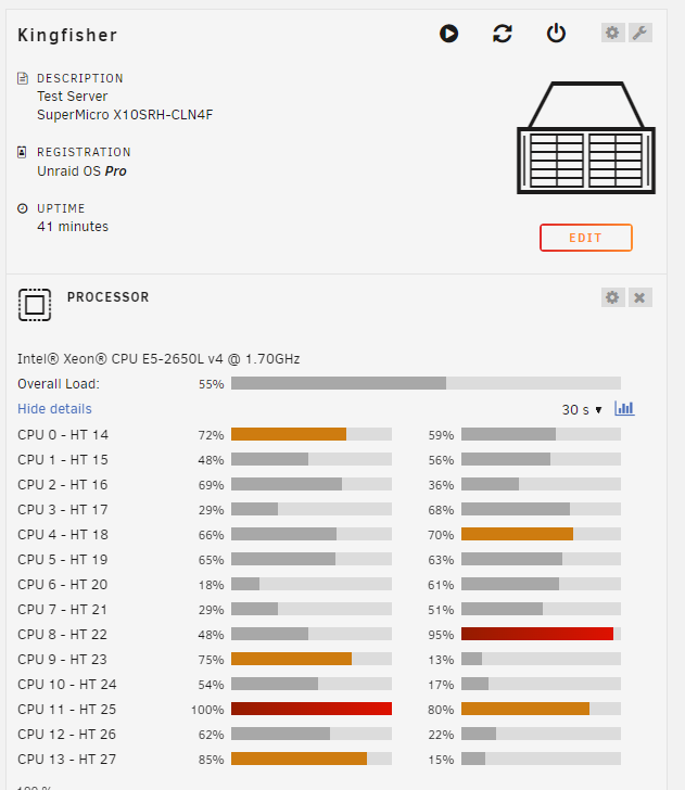

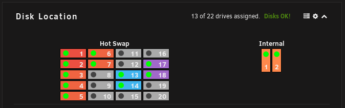

Is there a way to display the drive matrix on the Unraid dashboard? I'm not finding a way to customize the view.
Just updated my test server to 6.12.0-rc1 and with the dashboard plugin position feature enabled, it doesn't actually display anything and breaks the layout below it:
With Dashboard plugin position set to Hardware:
With Dashboard plugin position set to Off:
Edit: I should add the same thing happens if you select "Disk arrays" for the plugin position.
Edited by KingfisherUK
Yes.  Known issue with it as plugins that add to the dashboard need to be redone for 6.12  I usually give authors some time during RC stage before marking plugins as being incompatible.
Further note:  While the plugin used to simply have the display aberrations, under the next rev of the OS (currently private testing) having it installed will prevent the dashboard from even loading.  It is now marked as being incompatible until such time as the author lets me know it has been fixed
https://forums.unraid.net/bug-reports/prereleases/unraid-os-version-6120-rc1-available-r2297/page/4/?tab=comments#comment-22546

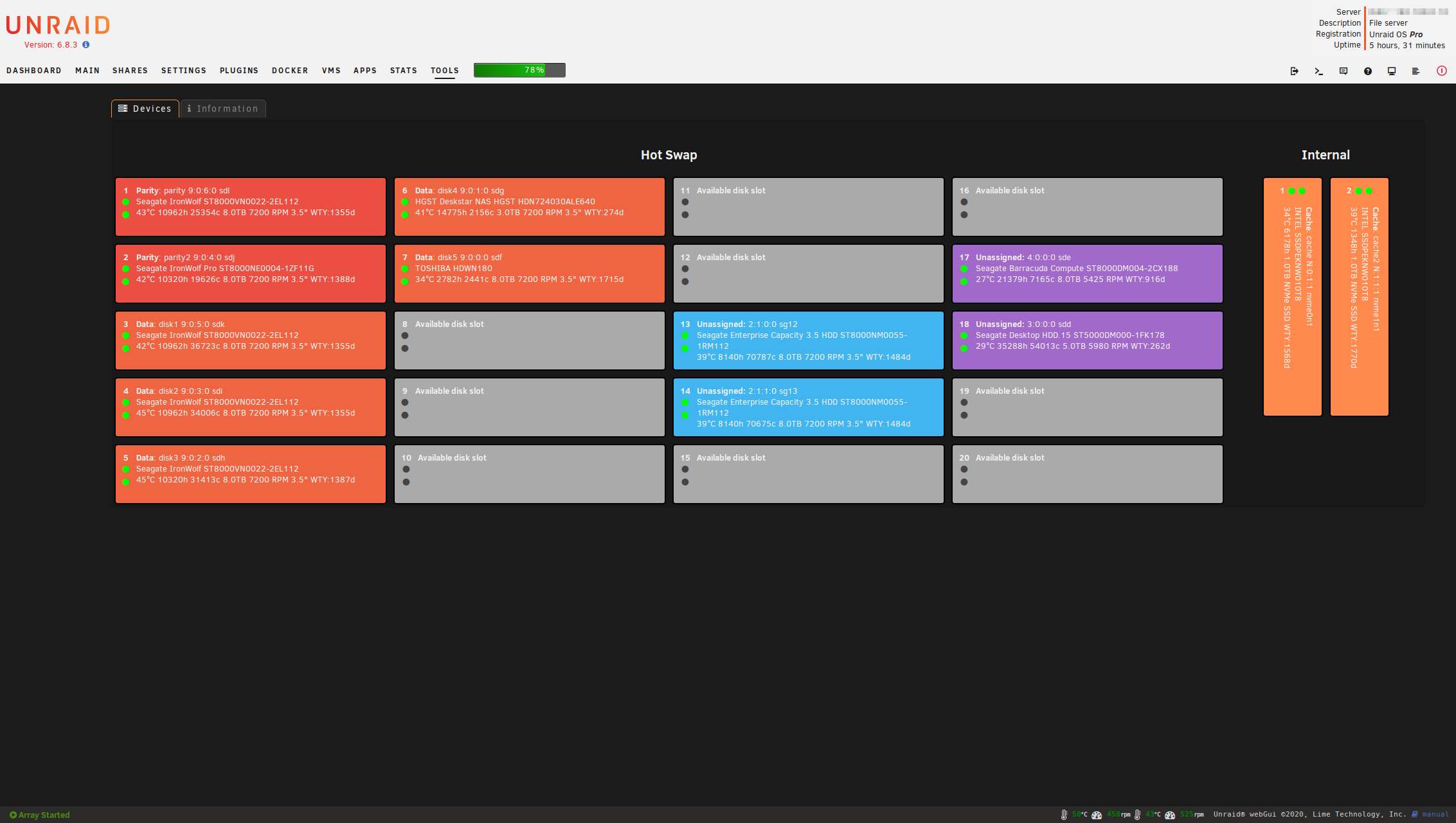

Disk Location is a different disk tray layout plugin which uses the harddisk path to locate the drives. It supports only drives found by the SCSI Generic drivers, which is usually SATA and NVMe including devices attached to hardware storage/raid cards.
This also include a handy "Locate" function which help you allocate the tray from where the disk is installed in, if you have hotswap trays with their own HD-activity LED (or made your own custom ones). This might not work on SSD's or maybe even some other types of harddrives.
You can change the direction of the trays horizontal and vertical as well as the numbering direction of the trays, make some override to add more storage "not included in the hotswap tray area", change the background colors of the different type of storage (unraid, unassigned and empty), and more. Doing changes will not delete or clear any configuration and values are mainly stored based upon serial number and model name of the harddisk.
For more information and help, use the inline Help function from Unraid (this will solve most of the questions asked):
It might take some time to install and update the plugin as it goes trough all your drives, more you have, longer it will take. For me it takes about 5-10 seconds with 15 harddisks, but upto 30-60 seconds if they need to wake up from standby.
The plugin is primarily developed for the current stable Unraid branch and might lag a bit behind for new releases with new functions.
Disk Location will be installed under "Settings" (as of Unraid 6.12 and onwards).
Download plugin using this link here: https://raw.githubusercontent.com/olehj/disklocation/master/disklocation-master.plg
Or install it via "Community Applications" plugin, search for "Disk Location" under "Apps"
For unstable development build, check next post.
Screenshots:

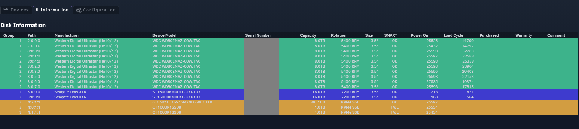

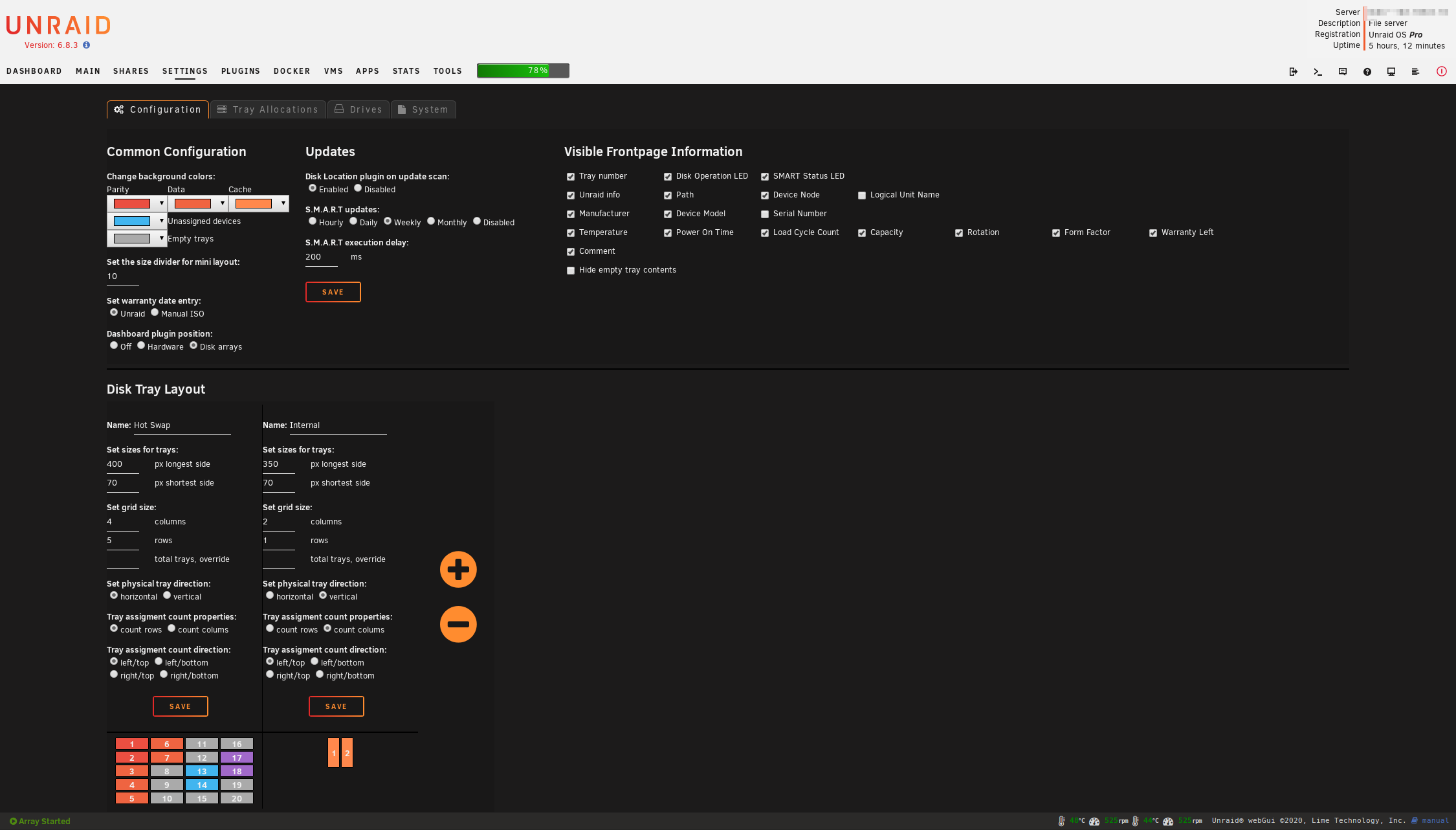

Tools: DevicesTools: InformationSettings: ConfigurationSettings: Tray AllocationsSettings: DrivesSettings: System

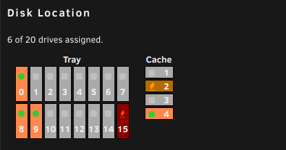

Dashboard

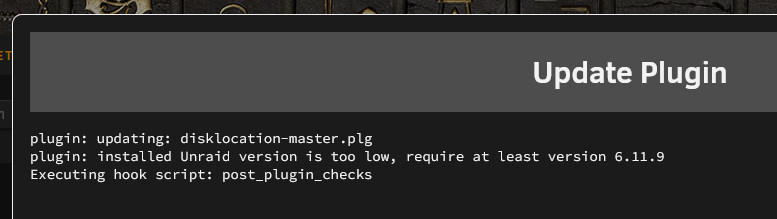

Updated version requirements
New release...
Told me, cant be installed...
Min Version 6.11.9 (???)
Confused... 🤪
Edited by Zonediver
4 minutes ago, Zonediver said:
New release...
Confused... 🤪
Chill 😆

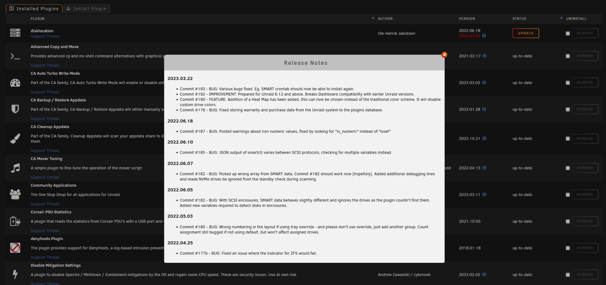

Update 2023.05.30
  • Commit #218 - BUG: When upgrading the plugin or Unraid, something might not upgrade correctly. Added some cleanup before install script starts to prevent this from happening.
Update 2023.04.22
  • Commit #216 - BUG: Typo on a variable caused wrong "maxTemp" to be included.
Update 2023.04.17
  • Commit #188 - BUG: Some errors might be output with smartctl on certain NVMe drives, added a silent mode to ignore such events as it's not useful for this plugin anyway. More NVMe drives should now probably be detected, and maybe some regular drives as well.
Update 2023.04.15
  • Commit #212 - MINOR: Fixed some more undefined variables.
Update 2023.04.05
  • Commit #210 - BUG: Conflicting style sheets across the plugin and Unraid LEDs has been addressed.
Update 2023.04.04
  • Commit #208 - IMPROVEMENT: Added a button to move the legacy Dashboard left and right under "System" configuration. This is not visible for Unraid 6.12 users.
Update 2023.04.01 - no, it's not an April Fools joke.
  • Commit #205 - IMPROVEMENT: Added a legacy dashboard back, as people can use newer plugin on a current stable Unraid system again.
  • Also removed a useless question mark icon when hovering the LED-icons.
Update 2023.03.25
  • Commit #203 - BUG: Fixed a background color bug if warning/critical flash was active.
Update 2023.03.24
  • Commit #199 - BUG: In some specific situations, the temperature colors where not correct.
Update 2023.03.23
  • Commit #197 - FEATURE: Added a function to enable the background to flash on a disk that has a warning or critical issue.
  • Commit #197 - BUG: Also fixed an issue where empty trays did not hide the contents when checked.
Update 2023.03.22
  • Commit #193 - BUG: Various bugs fixed. Eg. SMART crontab should now be able to install again.
  • Commit #192 - IMPROVEMENT: Prepared for Unraid 6.12 and above. Breaks Dashboard compatibility with earlier Unraid versions.
  • Commit #190 - FEATURE: Addition of a Heat Map has been added, this can now be chosen instead of the traditional color scheme. It will disable custom drive colors.
  • Commit #176 - BUG: Fixed storing warranty and purchase date from the Unraid system to the plugins database.

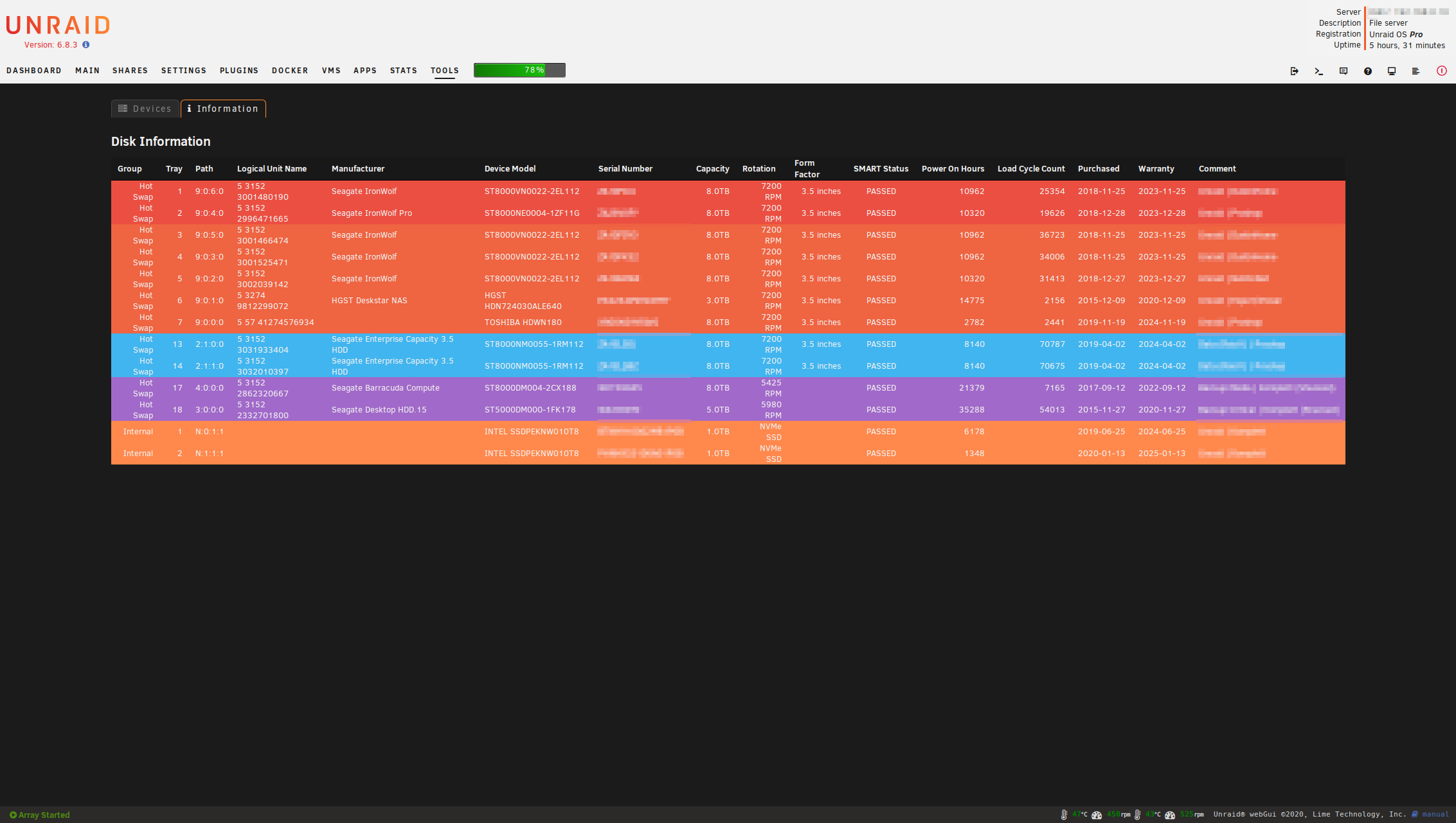

More info about this new release
The information and the configuration of the plugin is now all under the same main area: Settings -> Disk Location (Tools is gone).
The Heat Map function will use the temperature set by the system (globally) unless if it's stored per drive manually. The colors will use the same settings/variables as the traditional tray system and are still configurable. The custom colors will be deactivated in this mode. There's also an additional "LED" to display temperature warnings: okay -> hot -> critical: green orb -> yellow flame -> red flame. Additionally, temperatures including the stored Unraid settings are visible under the INFO tab.
The warranty data is back, you might need to do a "Force Scan All" to get them back from the stored Unraid array.
