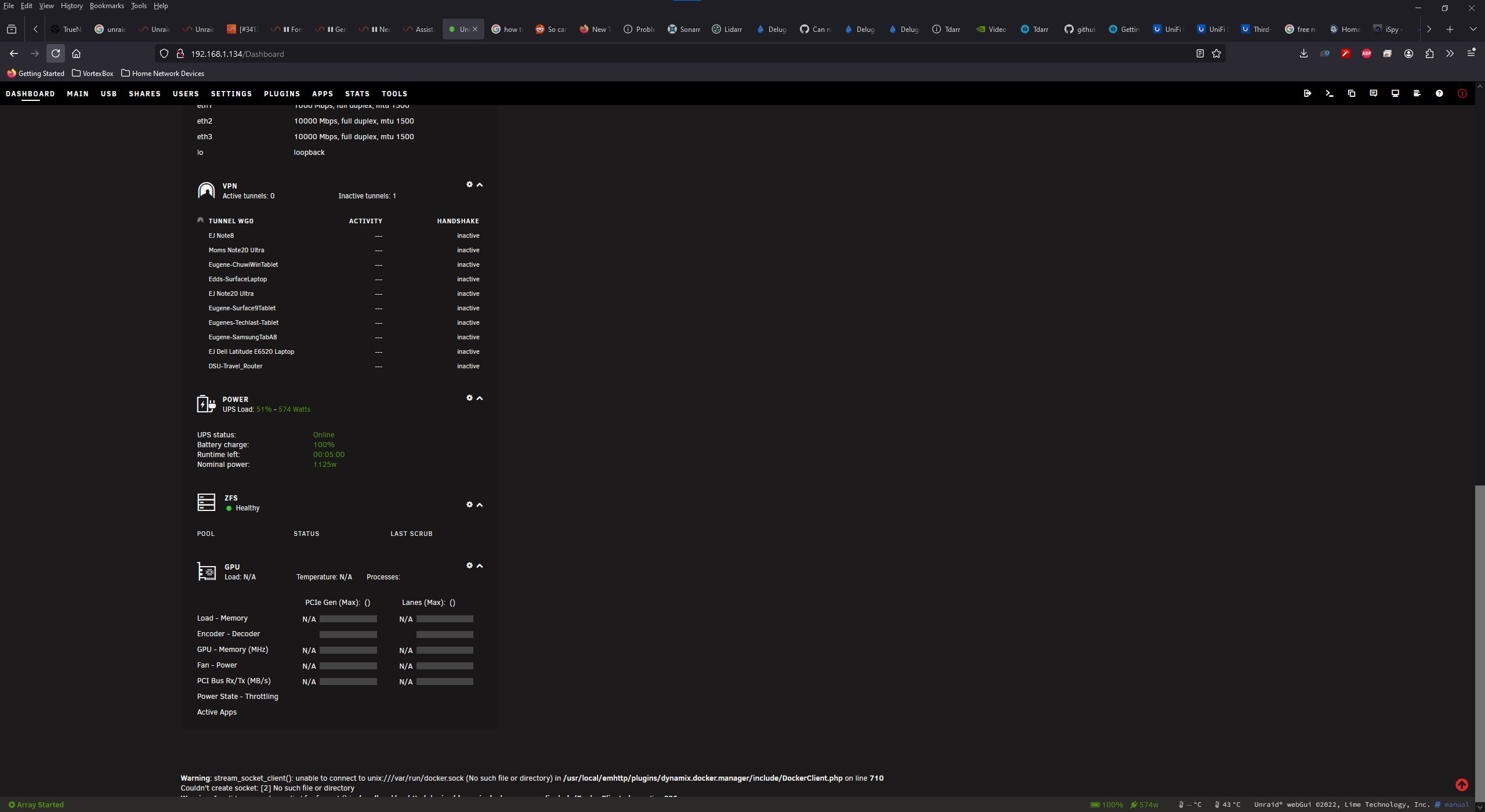

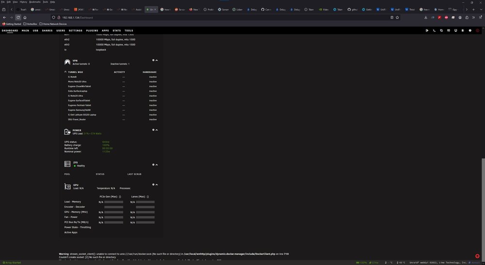

  1. Any idea why this is at the bottom of the dashboard page? FCP doesn't mention any issues.

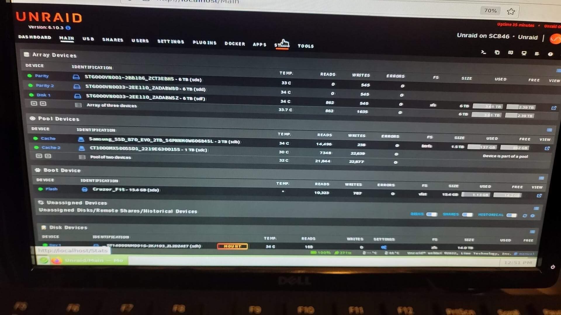

  4. The scrub results were: UUID: 26ae09fe-73d8-4cb3-9066-0fa4960759b2 Scrub Started: wed Oct 30 06:14:49 2024 Status: finished Duration: 0:12:31 Total to Scrub: 253.97GiB Rate: 346.29MiB/s Error Summary: verify=9629 csus=4567661 Corrected: 4577290 Uncorrectable: 0 unverified: 0
  5. OK, I set both docker and VM Manager to "no" and restarted, upon restarting the colors on Disk Location were kinda back to normal (both cache drives were purple, I think the array ones were correct too, hard to tell) but the time is still off for some reason (again, I don't know if that has any effect on the issue). I then went to the "main" tab and under pools clicked on the "Cache" title and selected the checkbox for "repair corrupted blocks" then clicked Scrub. I'm hoping this was the right one, as I didn't find the word scrub anywhere else I looked. Here is the resulting diagnostic file after. unraid-diagnostics-20241030-0622.zip
  6. Here you go. I don't know if it matters much or at all, but I noticed that the time is wrong on the system too (Console GUI) unraid-diagnostics-20241029-0446.zip

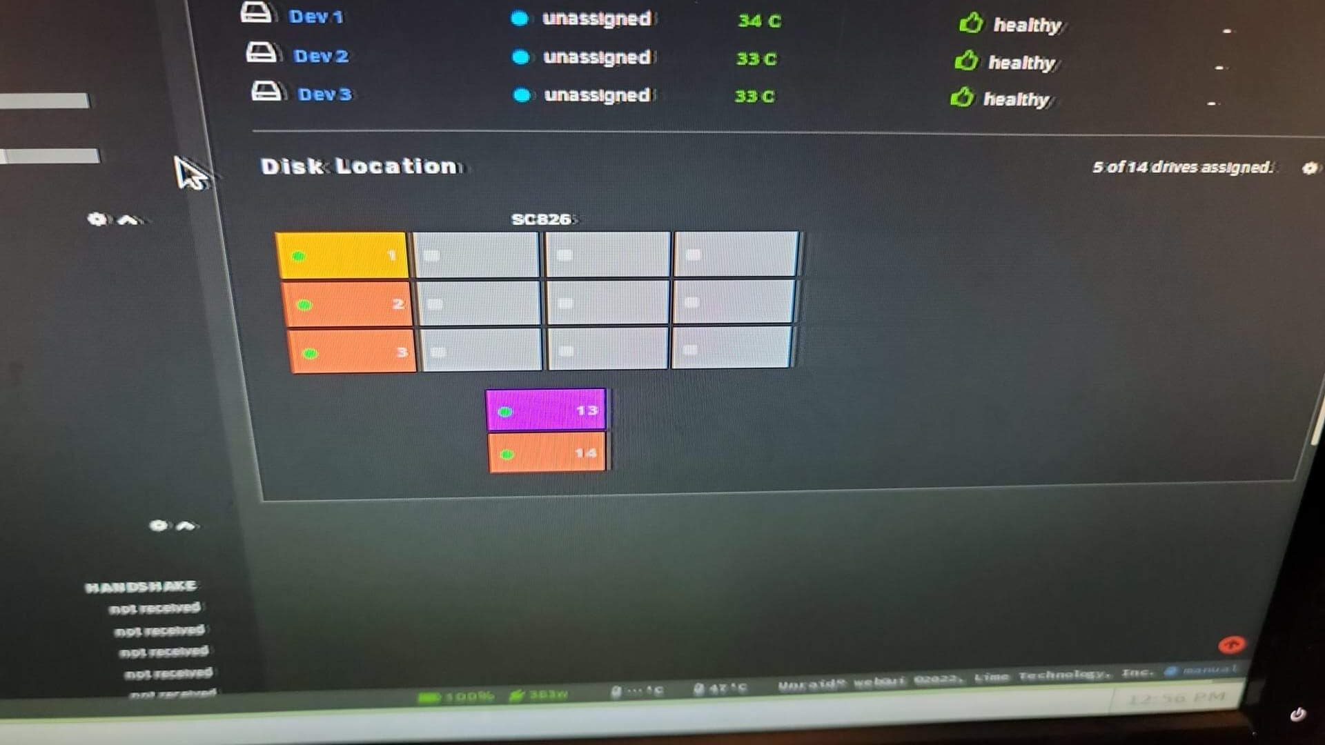

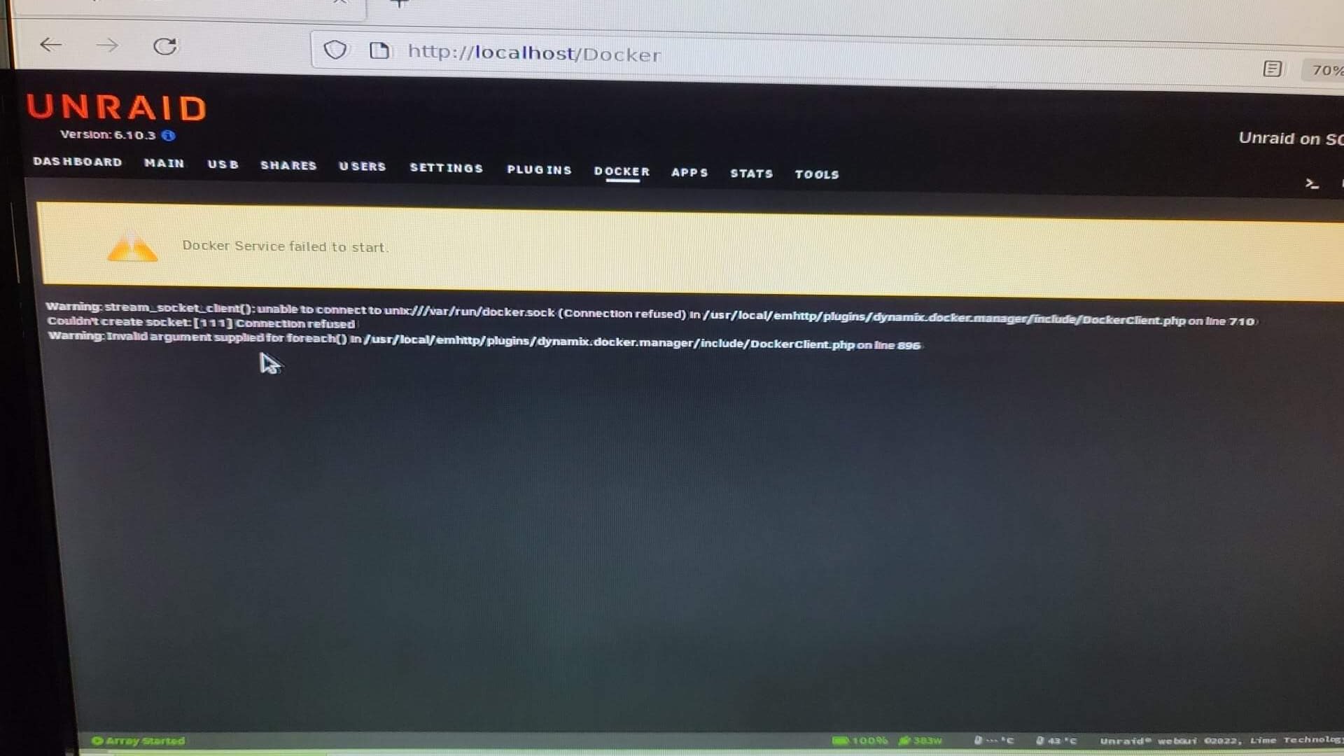

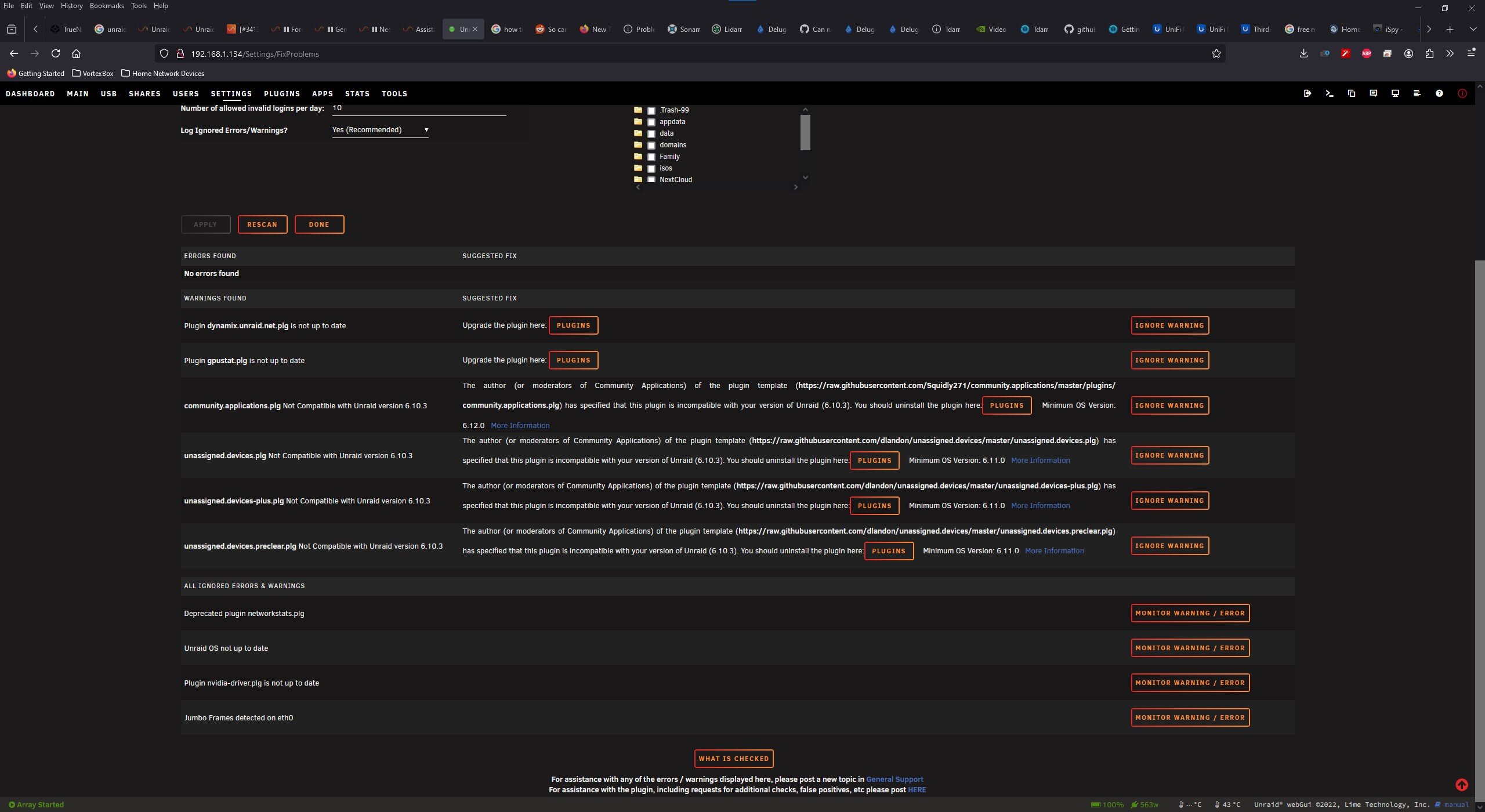

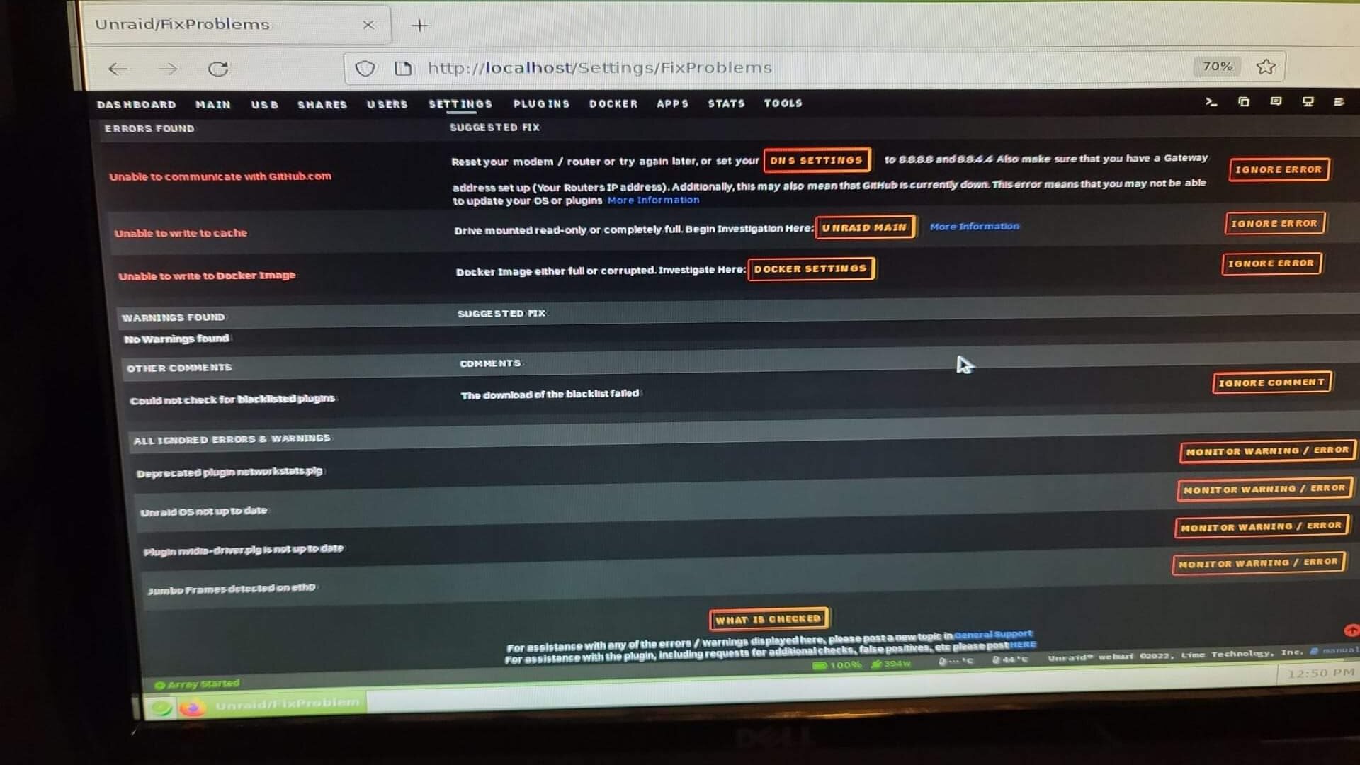

  7. A couple hours ago I shut down my Unraid server because I was going to be messing with (moving/replacing) the power and network cables respectively. When I started it back up I noticed the Disk Location Plugin had the locations different colors than they were when shut down and My 1 VM hadn't started, Then I noticed that the Dockers hadn't started either. When I click on the docker tab I get a message about "Docker Socket failed to start" (pictures attached). The disk Location plug in when started had a different color scheme from when it was shut down, 1 and 2 are supposed to be array parity (dk. orange/red), 3 should be array data (orange), 13-14 is supposed to be cache (purple). "Fix common problems" says something about the disks being full or read only, but they're not as shown in the other pics. After my main desktop crashed i've been using my array/vm as my main data storage (as well as my Proxmox Backup Directory on my VM), and now with this I can not access ANY of my data. I'd asked on the Facebook page, but didn't get any help, just "Fix your pics", which wasn't helpful. I tried a restart (clean) and when it came back up I got a message about an "unclean restart" (i think was then wording) so It's now doing a parity check, ETA 8hours or so until it's done. with that for some reason I can not access the dashboard from my PC (over the network), just from the server interface monitor. Any question to help you help me, just ask and I'll try to answer to the best of my knowledge, I don't know linux, I've had to use Youtube to get everything setup a couple years ago, alot of which was spaceinvader and ibracorp. Less important: While I had it off I looked to see if I could put my Quadro (p4000) back in but unfortunately there's no way to make it fit in the new chassis I have (2u), with that How do I go about removing it so Unraid doesn't look for it at startup anymore? System: Unraid 6.10.3 Supermicro x10SRL-F Board in a Supermicro SC826 Chassis Array drives in front, Cache drives in rear
