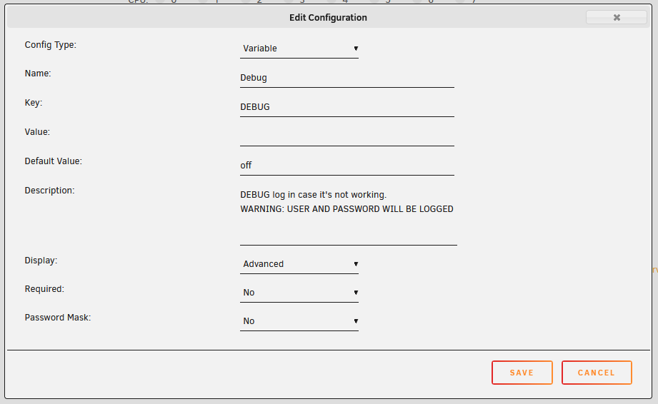

My container stalls in starting and shows no logs. I pretty much kept the template on default with my login credentials and network set to bridge. Have you been able to get this to work yourself yet? I appreciate the work BTW, I've been trying to get this bubuntux container to work for over a year.
Try adding this Variable and post the logs (REMEMBER TO REMOVE YOUR CREDENTIALS)

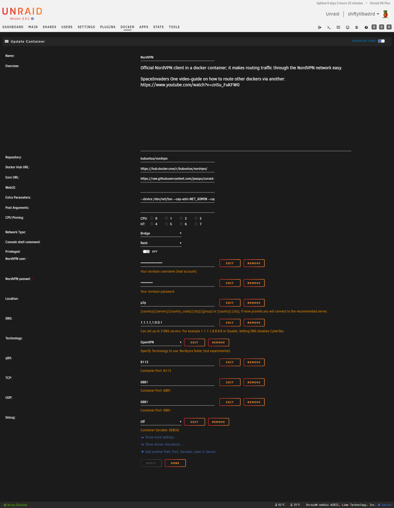

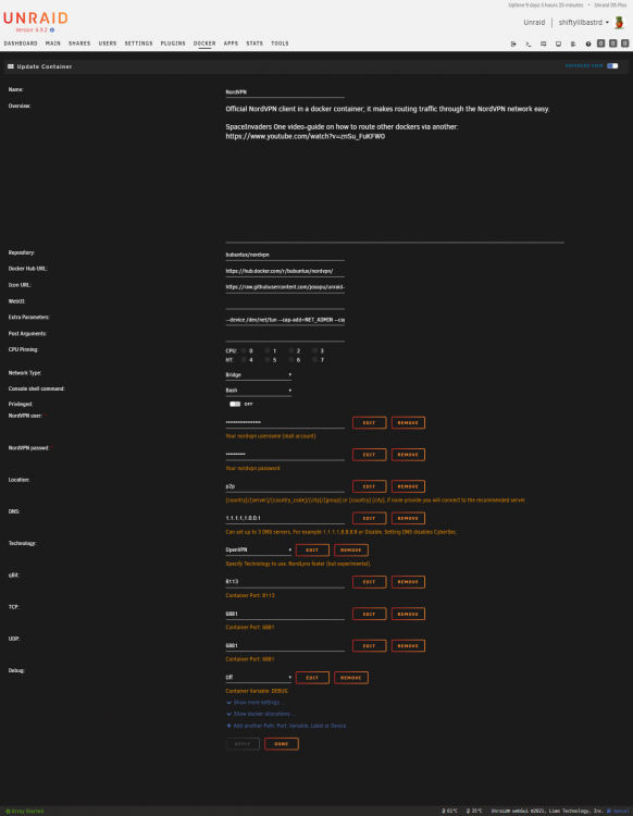

Question of my own, what's the syntax format for the "Location" variable?  I tried to use: "us8297.nordvpn.com" which resulted in, "[Warning] could not determine server tag" and "[Error] picking servers: no servers found" in the log window.  If I leave the "Location" variable empty (let the docker/app auto-detect the server) the log stops at "Connecting..."

Just edited the container, adding environment variable DEBUG=on; no new information.

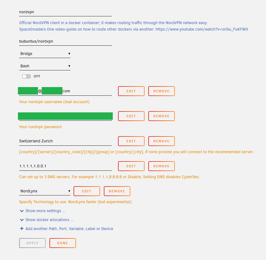

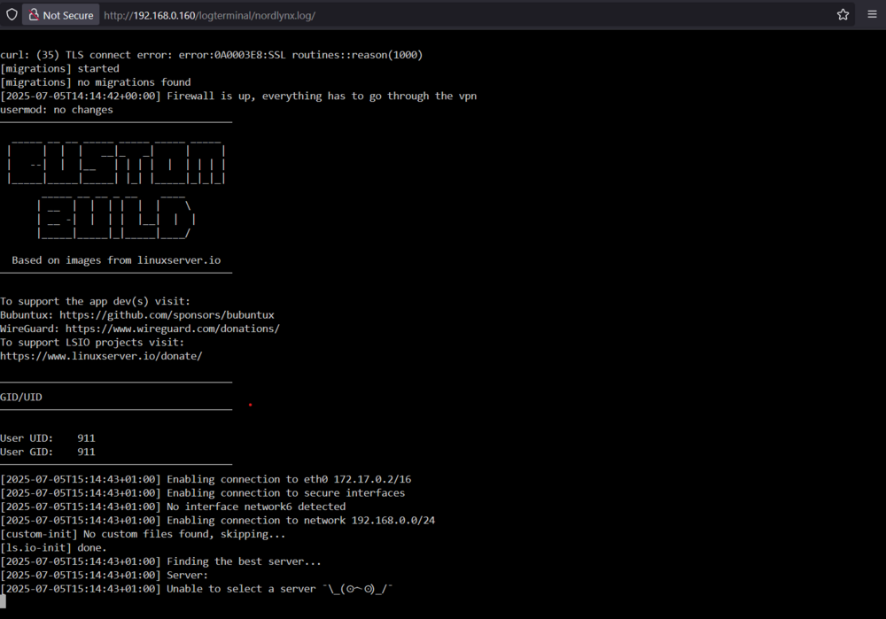

The nordlynx protocol was working fine until last week then the container stopped working, just now when i come across your comment I figure the issue and now it's working with openVPN, so thanks ❤️:)
Just write the country name for an example: "Netherlands" and that's it.
and if you're only using Transmission then you should use haugene/transmission-openvpn it works flawlessly .. excpt that you need to delete one variable (OPENVPN_CONFIG
) after docker update.

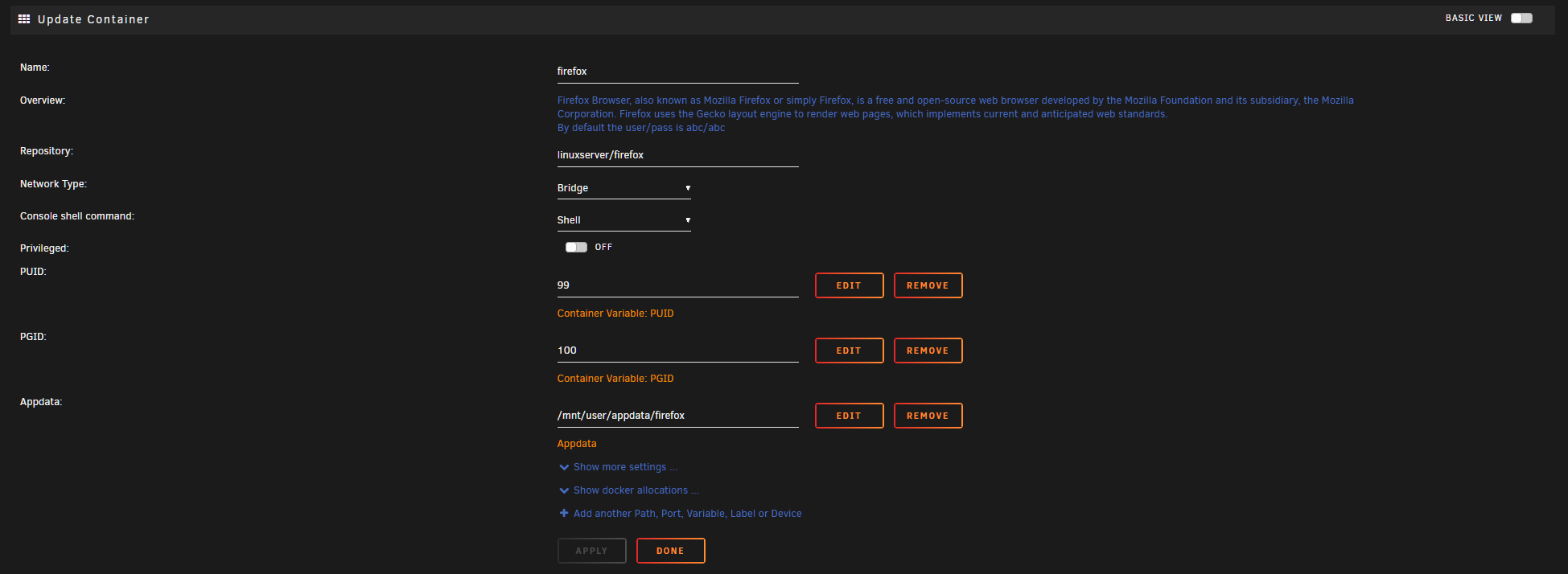

Hi guys,
I'm a bit lost on this one.
I've got the docker setup and its report and IP address so all good there.
I've been trying to get my Firefox container to work through it but I can never access it at the ip/port number.
Have I missed something somewhere?  It seemed pretty straight forward.
I've also checked "required Yes" to no help.
Edited by daveo132
10 hours ago, daveo132 said:
Hi guys,
You need to take the ports out of the firefox container and add them to your nordvpn container
Oh i see!
Thanks, I will try that shortly.
hmm,
So i think I've done that but it doesn't seem to have worked?
Does this Web UI lines also need removing?  I'd guess not.

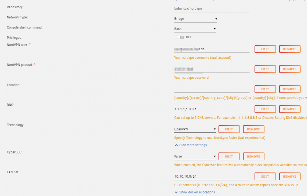

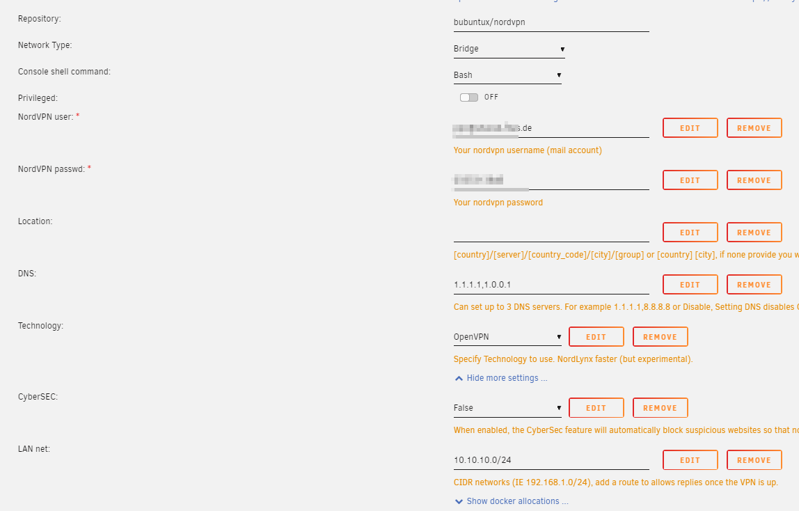

I am also running into error:
Any way to fix it?
Tried both NordLynx and OpenVPN.
[2021-06-24T12:34:35+02:00] Firewall is up, everything has to go through the vpn
[2021-06-24T12:34:35+02:00] Enabling connection to secure interfaces
[2021-06-24T12:34:35+02:00] Enabling connection to nordvpn group
[2021-06-24T12:34:35+02:00] Enabling connection to docker network
[2021-06-24T12:34:35+02:00] Enabling connection to network 10.10.10.0/24
[2021-06-24T12:34:35+02:00] Restarting the service
[2021-06-24T12:34:35+02:00] Waiting for the service to start
[2021-06-24T12:34:36+02:00] Logging in
[2021-06-24T12:34:37+02:00] Setting up NordVPN Version 3.10.0
CyberSec is already set to 'disabled'.
DNS is set to '1.0.0.1, 1.1.1.1' successfully.
Technology is already set to 'OpenVPN'.
Subnet 172.17.0.0/16 is whitelisted successfully.
Subnet 10.10.10.0/24 is whitelisted successfully.
[2021-06-24T12:34:38+02:00] Connecting...
If nothing happens, please visit https://join.nordvpn.com/order/?utm_medium=app&utm_source=linux

You Nord configure should resemble this except leave location blank unless you have a preference
