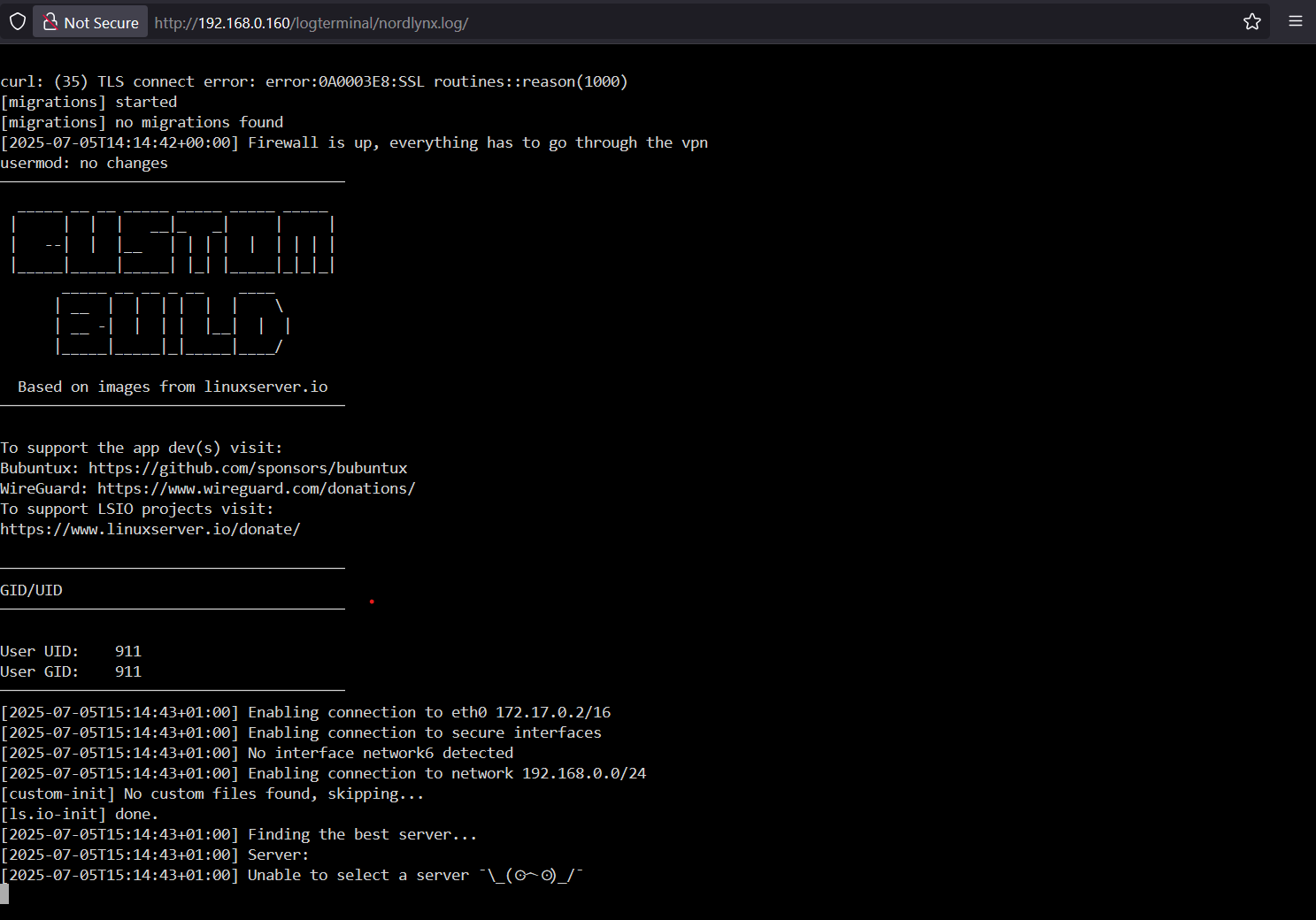

Hi everyone — up until recently, NordLynx had been working perfectly on my setup. But yesterday, I noticed Radarr searches weren't going through. On closer inspection, it turns out NordLynx wasn’t connecting at all — it couldn’t establish a link to a server and instead threw the error shown in the attached screenshot.
I haven’t changed anything major — just the usual Unraid and container updates — so I’m not sure what's causing the issue. I did manage to get things partially working through a rather convoluted routing tweak, but it's clearly a temporary fix and not ideal long-term.
Is anyone else experiencing this? Or does anyone have suggestions for a more permanent solution?
