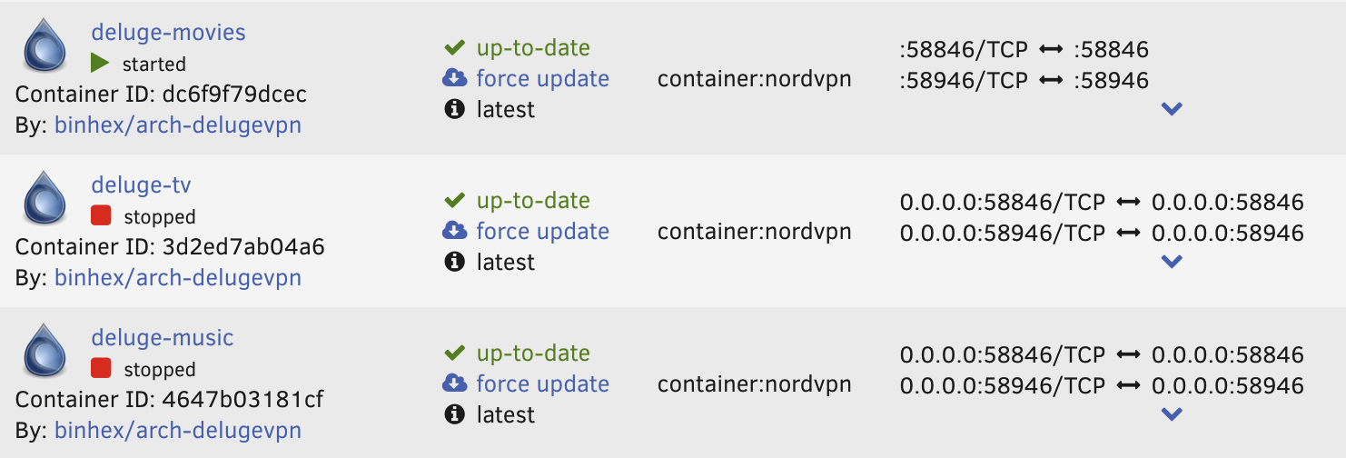

I have 3x separate instances of deluge running and I'm trying to map them all to NordVPN by following all the instructions provided here.
However, no matter how I try to define custom ports, these default ports are always defined.
I've tried:
- Changing the ports in the config template
- Changing the ports in the client settings
- Changing the ports in the client config files
No matter what, these defaults are the only thing that works no matter how I try to configure it.
Any ideas?

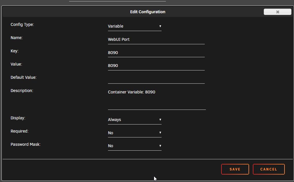

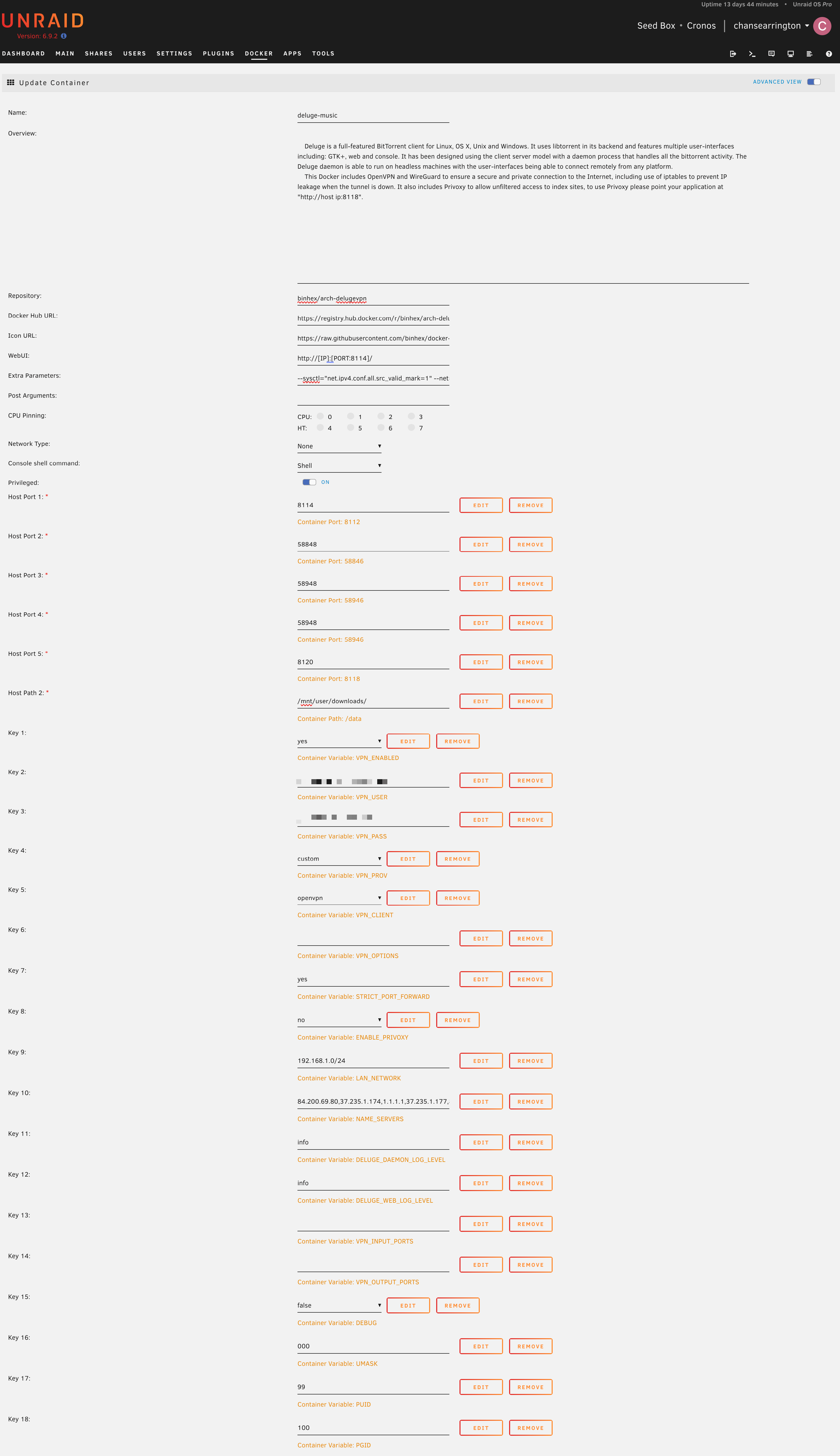

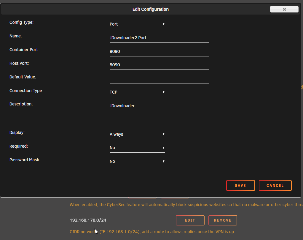

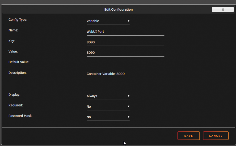

Hello, unfortunately I despair of the web interface of Jdownloader.
I have adjusted the network in NordVPN and tried all suggestions since page 1.
This is how it looks currently.
What can I test? Thank you very much.
JD Docker:
NordVPN:
Edited by Pascal51882
Is there a way to route all network traffic through Nord container?
JD Docker:
NordVPN:
The adress is:
http://(your-unraid-ip):8090/vnc.html
