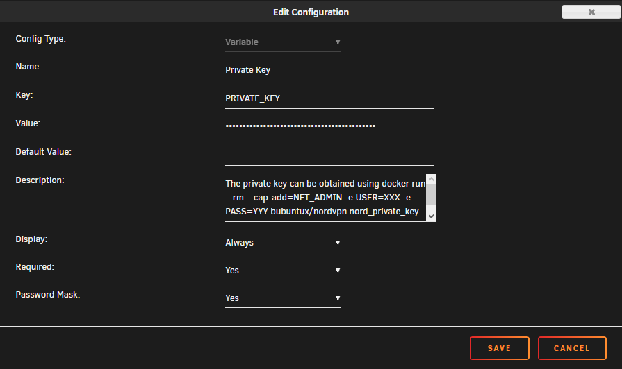

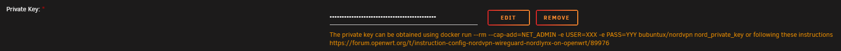

Very briefly, you have to change the docker container repositories to NordLynx and add a PRIVATE_KEY variable. There are another variables but it's optional you can check these variables at https://hub.docker.com/r/bubuntux/nordlynx/
Hey guys, great work on the container. I got it to route my qbittorrent trraffic through NordVPN. However, I cannot access my web Qbittorrent console anymore. (since it doesn't have any network settings) Any idea how I could do that? Thanks a bunch!
