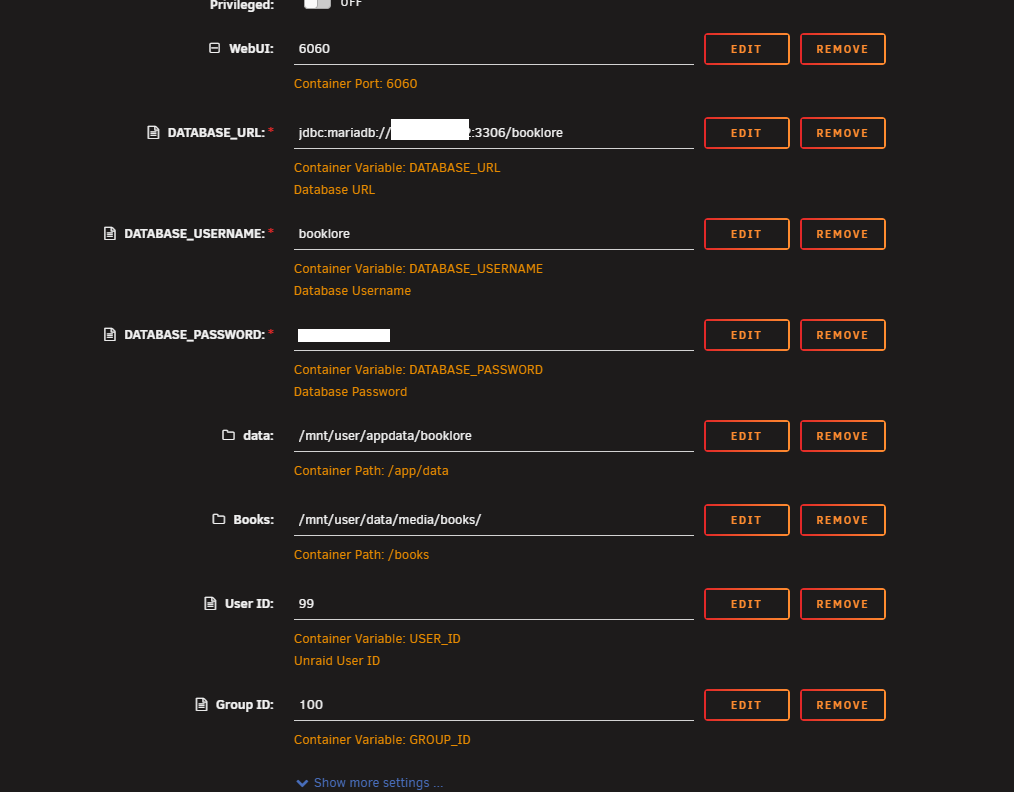

  3. Would it be simpler to just chown on the image folder to allow writes given everything else seems to work? (at least that is what AI is suggesting) And if so, to what? The issue seems to be writing of book covers. (and other images) Update: I deleted the 2 entries you suggested I remove and now it seems to work..messed up. mind boggling but happy nonetheless..
  4. I changed the repository from Booklore to Grimmory and all seems to work except I cannot write covers it seems to /image folder: 2026-04-02T06:56:07.299-04:00 WARN 1 --- [booklore-api] [mcat-handler-79] o.b.s.metadata.BookMetadataUpdater : Failed to download cover for book 22414: Error reading files from path: Failed to create directory: /app/data/images/22414 2026-04-02T06:56:11.129-04:00 INFO 1 --- [booklore-api] [MessageBroker-1] o.s.w.s.c.WebSocketMessageBrokerStats : WebSocketSession[3 current WS(3)-HttpStream(0)-HttpPoll(0), 3 total, 0 closed abnormally (0 connect failure, 0 send limit, 0 transport error)], stompSubProtocol[processed CONNECT(3)-CONNECTED(3)-DISCONNECT(0)], stompBrokerRelay[null], inboundChannel[thread-per-task], outboundChannel[thread-per-task], sockJsScheduler[pool size = 1, active threads = 1, queued tasks = 0, completed tasks = 0] I have added the group and user ID as instructed and performed the chown as instructed. Any help would be appreciated.

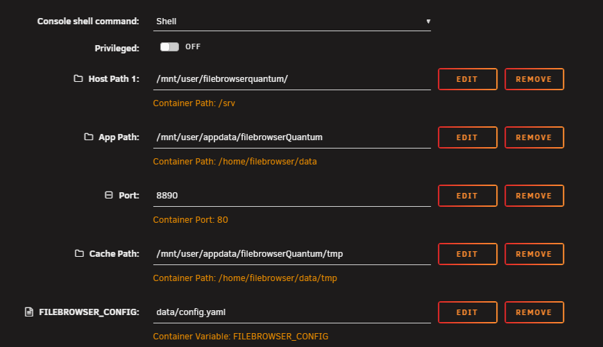

  12. I changed signup: true and reloaded the docker in order to allow new user sign-up. I confirmed showing in yaml. Doesn't seem to do anything. Am I missing something relating to signup? Update can you post the actual settings and full path syntax that are suggested? Do these settings look right? Seems to be a relative path with another config.yaml below data but not a complete list of settings:
