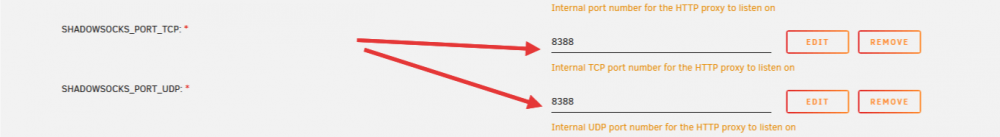

no matter what i do i get
With everything configured correctly.

Odd, it was working before the upload to CA. Thanks for pointing it out. I'll check and see what is wrong.
**UPDATE** So somehow before uploading I accidentally flipped one of the ports from udp to tcp. I have fixed it in the XML and tested it. The new working version should be uploaded soon.
Thanks.
If it is the SHADOWSOCKS_PORT_UDP i corrected it but still no joy.
C.
Found it.
Some of the ports assignments are duplicated in the template.
Removed those and it works.
5 hours ago, dhstsw said:
Found it.
You are correct, it was the SHADOWSOCKS_PORT_UDP. It was set to tcp instead of udp in the initial uploaded. It was corrected in the appstore yesterday. It is possible that the old template was still cached from the appstore. Glad you got it working 🙂

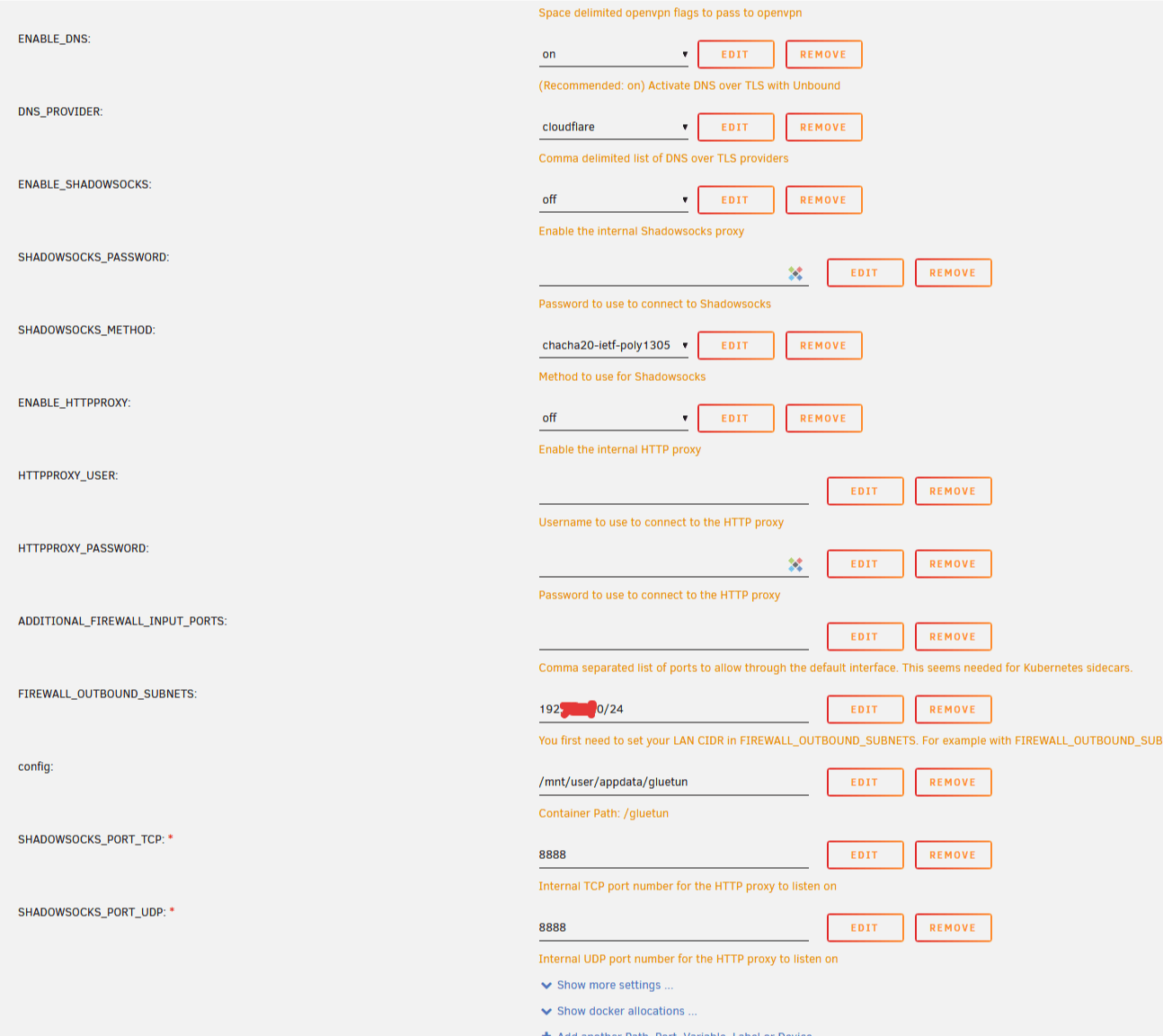

Would you mind adding this variable to the gluetunvpn template too? it allows the containers inside talk to a container outside the network, if i got this right. without this variable sonarr and jellyfin would not talk to each other. so sonarr would not see jellyfin.
FIREWALL_OUTBOUND_SUBNETS
wiki say this:
Comma separated subnets that Gluetun and the containers sharing its network stack are allowed to access. This involves firewall and routing modifications.
Edited by SebTech33
This has been added to the template. It can take up to two hours for changes to appear in CA.

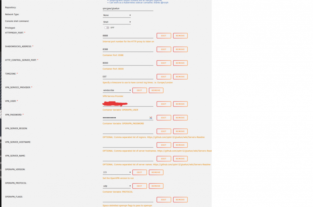

On 8/9/2021 at 9:03 PM, biggiesize said:
No worries. Any VPN with the amount of variables and options like this one is a bit challenging to set up.
Feel free to post a screenshot of your settings screen and any errors you are seeing. I will gladly help out. 🙂

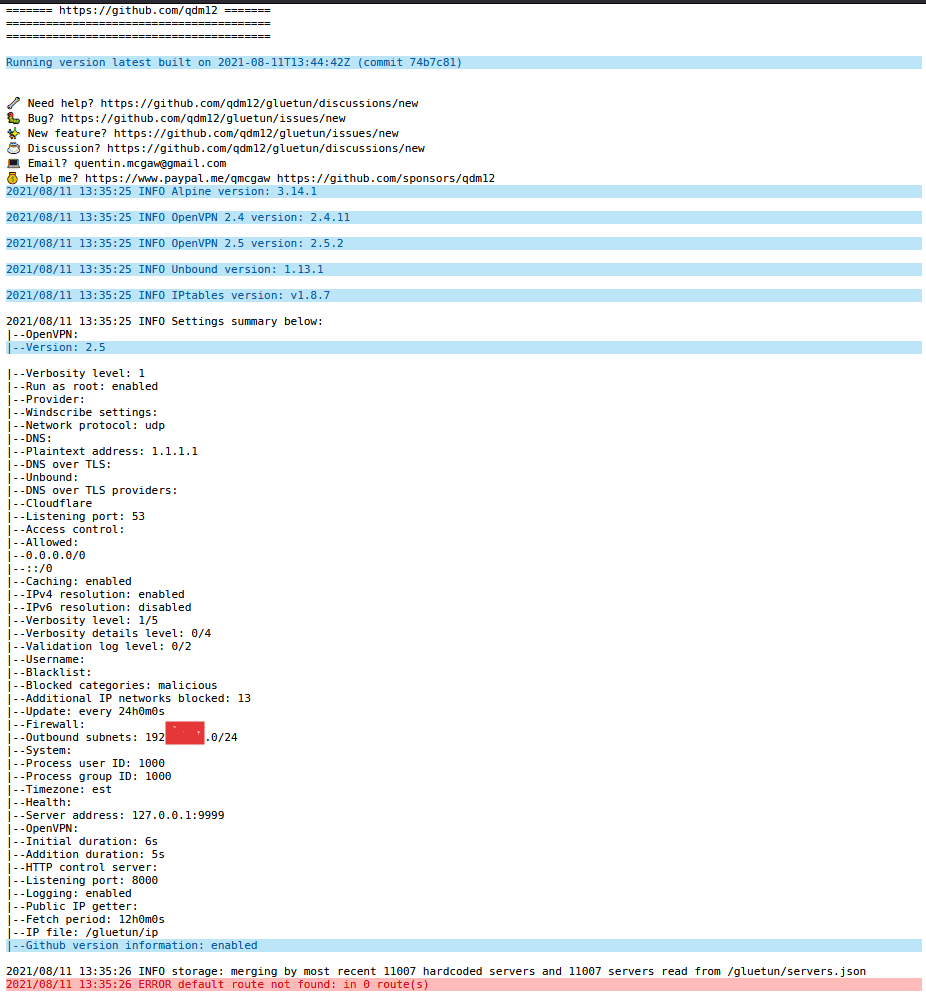

Here you go.  I thought it was pretty straight forward.  But I notice I have that error in the bottom of the log (last image) and it shuts down.  I'm missing something obvious, aren't I?
Thank you

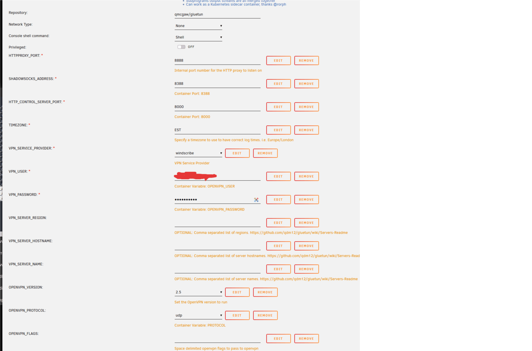

Near the top, change the network type to Bridge. I thought I had that set. I will double check the template when I get home tonight.
You might check to make sure that the ports aren't in use by another application. 8000 is very common among security apps. If you find one that is already in use just change the one I. The Gluetun template to something else not is use.
Got it!  I uninstall the Docker and made sure there were not remnants.  When I reinstalled it noticed an additional field  and some of the ports changed.   When I first ran it failed again.   Then I noticed the Template defaults to a different port than what you recommend at the top of the Template.  I changed the 8888 to 8388 as the template directions state.   So it's running now. I see no errors in the log! 😁 👍

Here is a modified version of my log if you'd like to see it.  I can already tell that I might want to at least get the VPN to use a set of regions for servers for efficiency.  I'm reading through this and looking things up for a little better understanding.
Thank you!
2021/08/11 20:50:11 INFO storage: creating /gluetun/servers.json with 11007 hardcoded servers
2021/08/11 20:50:11 INFO routing: default route found: interface eth0, gateway 172.xx.xx.1
2021/08/11 20:50:11 INFO routing: local ethernet link found: gretap0
2021/08/11 20:50:11 INFO routing: local ethernet link found: erspan0
2021/08/11 20:50:11 INFO routing: local ethernet link found: eth0
2021/08/11 20:50:11 INFO routing: local ipnet found: xxx.x.xx.xxx/16
2021/08/11 20:50:11 INFO routing: adding route for 0.0.0.0/0
2021/08/11 20:50:11 INFO firewall: firewall disabled, only updating allowed subnets internal list
2021/08/11 20:50:11 INFO routing: default route found: interface eth0, gateway 172.xxx.xx.1
2021/08/11 20:50:11 INFO routing: adding route for 192.xxx.x.0/24
2021/08/11 20:50:11 INFO openvpn configurator: checking for device /dev/net/tun
2021/08/11 20:50:11 WARN TUN device is not available: open /dev/net/tun: no such file or directory
2021/08/11 20:50:11 INFO openvpn configurator: creating /dev/net/tun
2021/08/11 20:50:11 INFO firewall: enabling...
2021/08/11 20:50:11 INFO firewall: enabled successfully
2021/08/11 20:50:11 INFO dns over tls: using plaintext DNS at address 1.1.1.1
2021/08/11 20:50:11 INFO http server: listening on :8000
2021/08/11 20:50:11 INFO healthcheck: listening on 127.0.0.1:9999
2021/08/11 20:50:11 INFO firewall: setting VPN connection through firewall...
2021/08/11 20:50:11 INFO openvpn configurator: starting OpenVPN 2.5
2021/08/11 20:50:11 INFO openvpn: 2021-08-11 20:50:11 DEPRECATED OPTION: ncp-disable. Disabling cipher negotiation is a deprecated debug feature that will be removed in OpenVPN 2.6
2021/08/11 20:50:11 INFO openvpn: OpenVPN 2.5.2 x86_64-alpine-linux-musl [SSL (OpenSSL)] [LZO] [LZ4] [EPOLL] [MH/PKTINFO] [AEAD] built on May 4 2021
2021/08/11 20:50:11 INFO openvpn: library versions: OpenSSL 1.1.1k 25 Mar 2021, LZO 2.10
2021/08/11 20:50:11 INFO openvpn: TCP/UDP: Preserving recently used remote address: [AF_INET]109xxx.xxx.xx:443
2021/08/11 20:50:11 INFO openvpn: UDP link local: (not bound)
2021/08/11 20:50:11 INFO openvpn: UDP link remote: [AF_INET]109xxx.xxx.xx:443
2021/08/11 20:50:12 WARN openvpn: 'link-mtu' is used inconsistently, local='link-mtu 1601', remote='link-mtu 1549'
2021/08/11 20:50:12 WARN openvpn: 'auth' is used inconsistently, local='auth SHA512', remote='auth [null-digest]'
2021/08/11 20:50:12 INFO openvpn: [ams-229.windscribe.com] Peer Connection Initiated with [AF_INET]109xxx.xxx.xx:443
2021/08/11 20:50:13 INFO openvpn: TUN/TAP device tun0 opened
2021/08/11 20:50:13 INFO openvpn: /sbin/ip link set dev tun0 up mtu 1500
2021/08/11 20:50:13 INFO openvpn: /sbin/ip addr add dev tun0 10.xxx.xxx.xx/23
2021/08/11 20:50:13 INFO openvpn: Initialization Sequence Completed
2021/08/11 20:50:13 INFO VPN routing IP address: 109xxx.xxx.xx
2021/08/11 20:50:13 INFO dns over tls: downloading DNS over TLS cryptographic files
2021/08/11 20:50:13 INFO healthcheck: healthy!
2021/08/11 20:50:15 INFO dns over tls: downloading hostnames and IP block lists
2021/08/11 20:50:17 INFO dns over tls: init module 0: validator
2021/08/11 20:50:17 INFO dns over tls: init module 1: iterator
2021/08/11 20:50:18 INFO dns over tls: start of service (unbound 1.13.1).
2021/08/11 20:50:18 INFO dns over tls: generate keytag query _ta-4a5c-4f66. NULL IN
2021/08/11 20:50:19 INFO dns over tls: ready
2021/08/11 20:50:19 INFO You are running on the bleeding edge of latest!
2021/08/11 20:50:21 INFO ip getter: Public IP address is 109.xxx.xxx.xx (Netherlands, North Holland, Amsterdam)
2021/08/11 20:53:59 INFO http server: 404 GET wrote 41B to 192.xxx.x.xxx:50323 in 31.62µs
2021/08/11 20:53:59 INFO http server: 404 GET /favicon.ico wrote 41B to 192.xxx.x.xxx:50323 in 19.55µs
2021/08/11 20:56:32 INFO http server: 404 GET wrote 41B to 192.xxx.x.xxx:50390 in 41.461µs
Edited by storagehound
The Web port isn't a traditional WebUI. It's more of an API for advanced automation in obtaining and modifying the container without restarting it.
https://github.com/qdm12/gluetun/wiki/HTTP-Control-server
I didn't catch it earlier but your Timezone needs to be in IANA format (example. America/New_York)
https://en.m.wikipedia.org/wiki/List_of_tz_database_time_zones
The dev has some decent notes on connecting other containers to Gluetun if you need help with that.
https://github.com/qdm12/gluetun/wiki/Connect-to-gluetun
