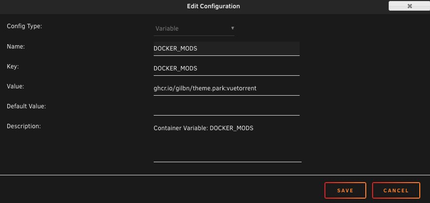

On 11/26/2021 at 4:31 AM, biggiesize said:
I'm glad that everything went smoothly for you so far. Personally, for torrenting, I use qbittorrent from the LinuxServer guys with the VueTorrent WebUI but I have also used Deluge from Binhex. Either are excellent choices. It really depends on your personal preference.
If you don't mind sharing, how did you manage to get vuetorrent to work with linuxserv qbit? I got to the point where I get white screen and vt icon in browser tab but the page is blank;( I don use standard port 8080 for webui, maybe that's why im stuck
Absolutely! I am not using port 8080 either so that "shouldn't" be causing issues. Since you're using the LinuxServer container, there is a fairly easy way to get it running.
Edit qbittorrent and add an environment variable called "DOCKER_MODS" with a value of "ghcr.io/gilbn/theme.park:vuetorrent". (Obviously without quotes)
Optional: You can choose between a few themes. You can find those here. Just add another variable called "TP_THEME" with a value of the theme you choose. (e.g. TP_THEME=dark)
Next, inside qbittorrent, go to Settings -> WEBUI, check Use alternative Web UI and enter its location /vuetorrent, then save. You might need to restart the container but I can't remember.
Do you mean environment variable like that?
Yes, that is correct.
Finally got it working;) thank you very much. Just for anyone who stumbles upon this thread, in my case the container needed to be set to Host rather than default Bridge mode. I was no able to make it work in Bridge mode. qbit from other repos worked just fine in bridge, but not linuxserv. Not sure why.
