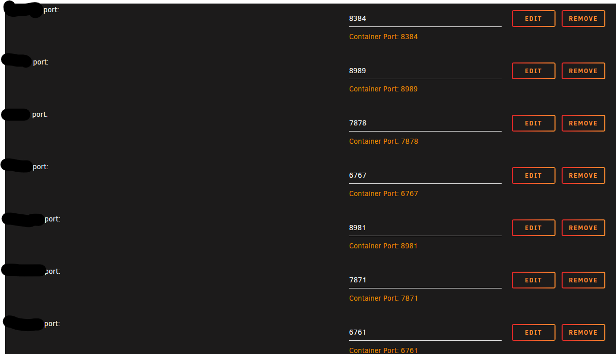

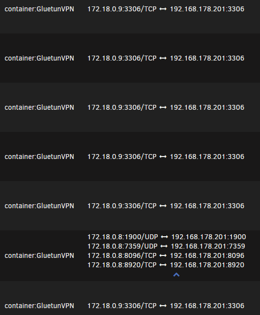

Hello,
i get some weird behaviour regarding port mappings with docker containers which are routed through Gluetun (see picture). The containers routed through Gluetun show port mappings of other containers which are NOT routed through Gluetun. In this case port 3306 is a MariaDB container and the other ones are from Jellyfin. It seems every time i restart the containers, they show other mappings. Everything seems to be working fine regardless, but why does this happen?
That looks to me like the containers are set to use "container:GluetunVPN" as their network connection. Make sure you go into each and set the "Network Type" accordingly.

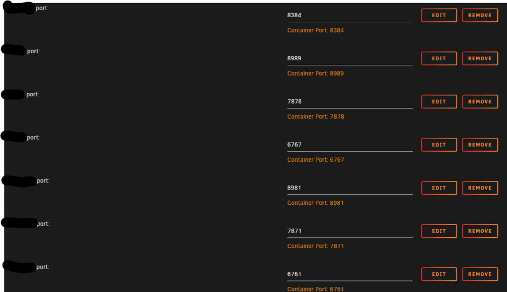

Yes, I want that the network connection is GluetunVPN for the containers shown in the picture. What bothers me is that there are port mappings for the ports 3306, 1900, 7359, 8096 and 8920. The ports for the containers with the VPN  network connection (shown in picture) are defined in GlueTUN and they have nothing to do with the ports shown in port mappings.
If memory serves me correctly, the UI doesn't look at the template for the container for the ports in use but instead inspects the container itself to see which ports are exposed. I wouldn't expect any issues. Possibly @bonienl would have more insight.

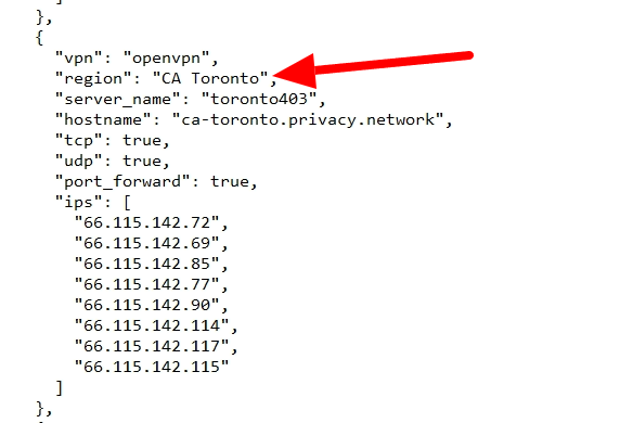

The Cities, Regions, etc. are defined differently in Gluetun vs PIA. Take a look at the servers list and see what options you have available.
https://github.com/qdm12/gluetun-wiki/blob/main/setup/servers.md

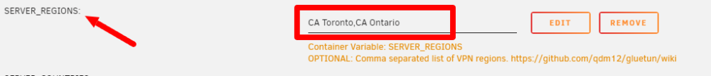

Feeling dumb right now. I was using the wrong info. Once I used the correct region info it worked just fine. Thanks!!!
PS. For multiple regions eg. "CA Toronto, CA Ontario" it did not work...... But it does work if you don't use a space after the comma.... "CA Toronto,CA Ontario" ... Thanks again!
Here is a screenshot for anyone who runs into this in the future.
