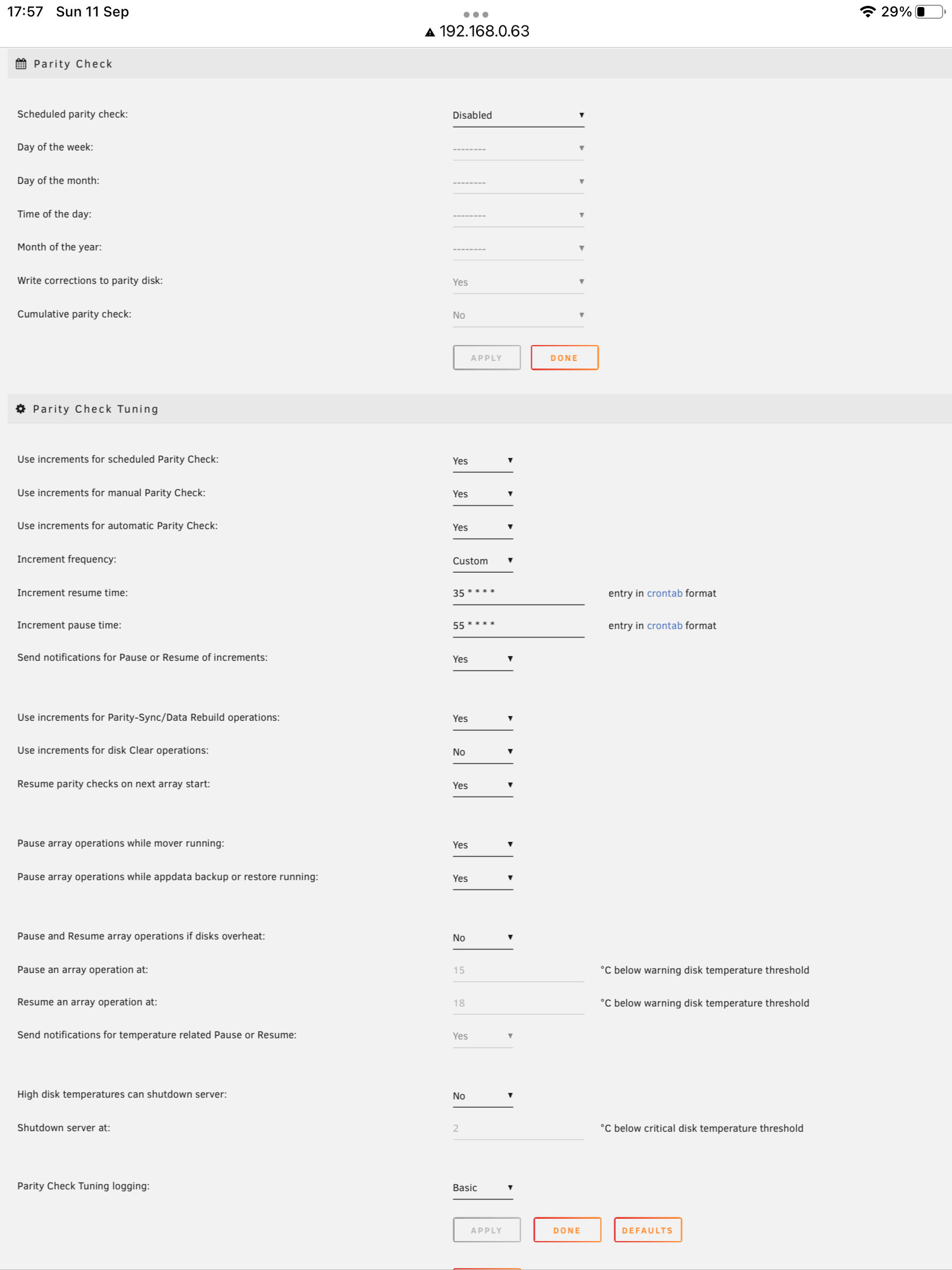

  15. I’m having issues with my system whereby it’s crashing when a parity check is left running continuously. If I manually resume for 20mins & pause for 45 mins it seems to be ok, but doing this manually is not great. I’ve tried this add on which seems ideal but it doesn’t seem to be working for me. The pause occurs but the resume doesn’t. Probably something I’m doing wrong, but would appreciate some help. Settings shown below. But effectively I’m trying to use custom with increment resume time ‘35 * * * *’ , and increment pause time ‘55 * * * *’
