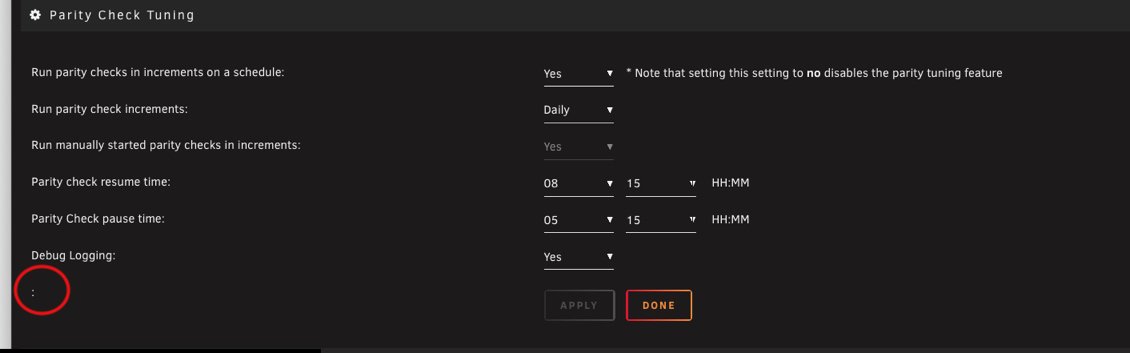

Not sure if this is just a random artifact or if it's supposed to be there. Seeing it in Safari and Firefox.
I am seeing it too when I looked closely enough (perhaps I need new glasses :) ).     It is something that slipped past my radar and easily fixed.   At one point I had some extra fields present on that screen to help with testing and left a tiny bit of text behind when I removed them.

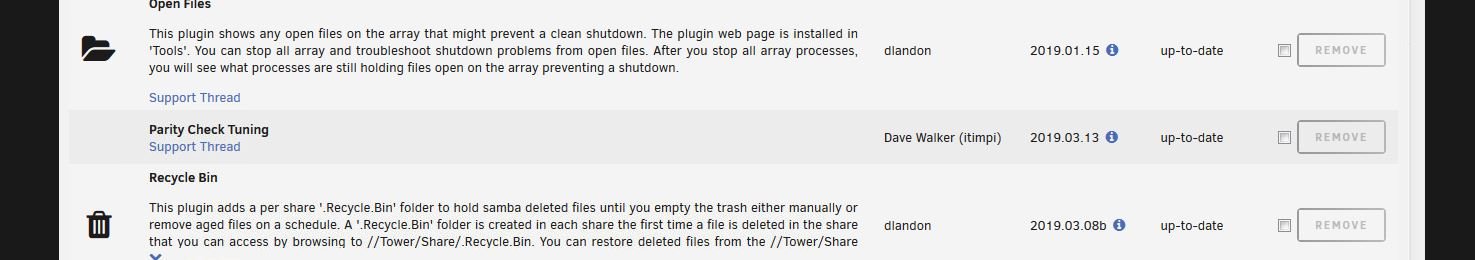

Not sure why, but the image for the Plugin isn't loading in my install. Not sure if its a glitch on my end or simply a missing image. I'm aware you don't click on it because you go into settings and use the schedule feature, but just thought it was kinda odd.
