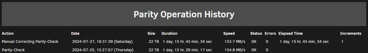

Is it normal that when I have the "Use increments for manual Parity Check:" set to "No" that I still get an log entry in the history?
The Parity-Check at the bottom of the screen is the one I had started manually on Thursday which finished today on Saturday, but as you can see I got a second entry from the plugin a few minutes later.
Why do I have 2 entrys for the same check? I doubt that 2 checks can run at the same time, or? Speeds at the beginning are around 280MB/s but they drop to 5-90MB/s at around 20TB.
It is normal for the plugin to always enhance the log entry in the history regardless of whether you are using it to run increments, but it should be finding the one the standard check produced and enhancing that rather than creating a new entry,
However something strange is going on as the standard check should only write an entry when it completes - not when it starts and you suggest that you did not have a check that completed on Thursday.   What version of Unraid are you using so I can check that the default check has not changed its logging behaviour.
Exactly, it was started on Thursday and completed on Saturday. Before I started it on Thursday there was only the one Parity-Sync entry from the 18th. Im running the current latest stable version 6.12.11.
But it's a good information that the time beeing displayed in the history should be the finishing time. If we can't find aynthing wrong in the first glance then I think I can wait to see if it also happens to scheduled checks. My next one would be in Oktober. It seemed just really strange to me.
I’ll do some checking against the 6.12.11 release in case something changed there and Unraid now defaults to logging in the history when the check starts rather than finishes.
