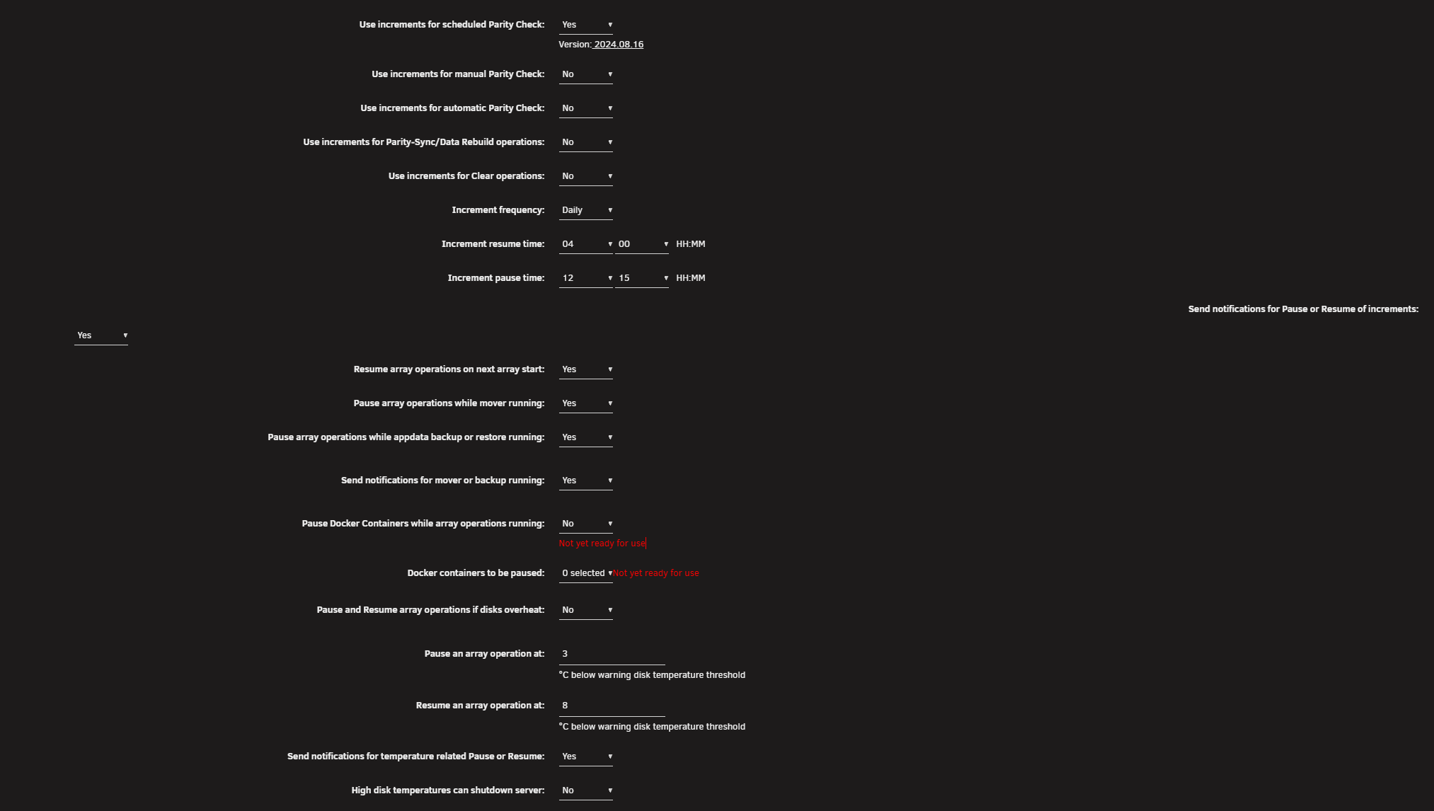

I don't know if it was fixed with the update that came today, but at least for the previous version, parity check tuning stopped following the increments. Right now it is 16:10 local and as you can see below, it should have stopped (for the day) at 12:15, but still goes on. (and yes used to work fine with the exact same settings)
And a cosmetic thing (plus here you can see my actual settings):
Edited by NLS

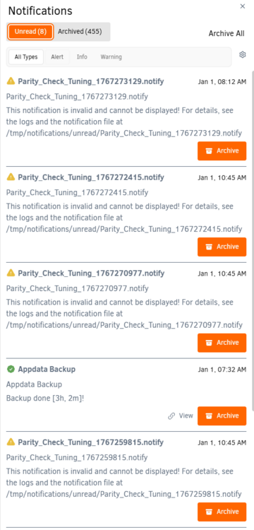

On 9/26/2025 at 3:15 AM, BurningSky said:
The error has come back again, from the notifications panel:
Parity_Check_Tuning_1758855103.notify
26 Sept, 08:09
This notification is invalid and cannot be displayed! For details, see the logs and the notification file at /tmp/notifications/unread/Parity_Check_Tuning_1758855103.notify
And when I cat that message
~# cat /tmp/notifications/unread/Parity_Check_Tuning_1758855103.notify
timestamp=1758855103
event=Parity Check Tuning
subject=[RAGON] mover running
description=
importance=normal
link=/Settings/Scheduler
Looks like a blank description again so that might have been the cause. My change to the script to replace blank descriptions must have been overwritten
been seeing this for awhile and following this thread hoping for a resolution, any progress? thanks
Same as above - getting the "invalid and cannot be displayed" error still.
I have never been able to reproduce this.

I am still seeing the same invalid notifications. Hopefully the following is helpful in some manner!
the notifications:
from the log at the same time as the 8:12am notification, none of the others seem to correlate with anything in the log:

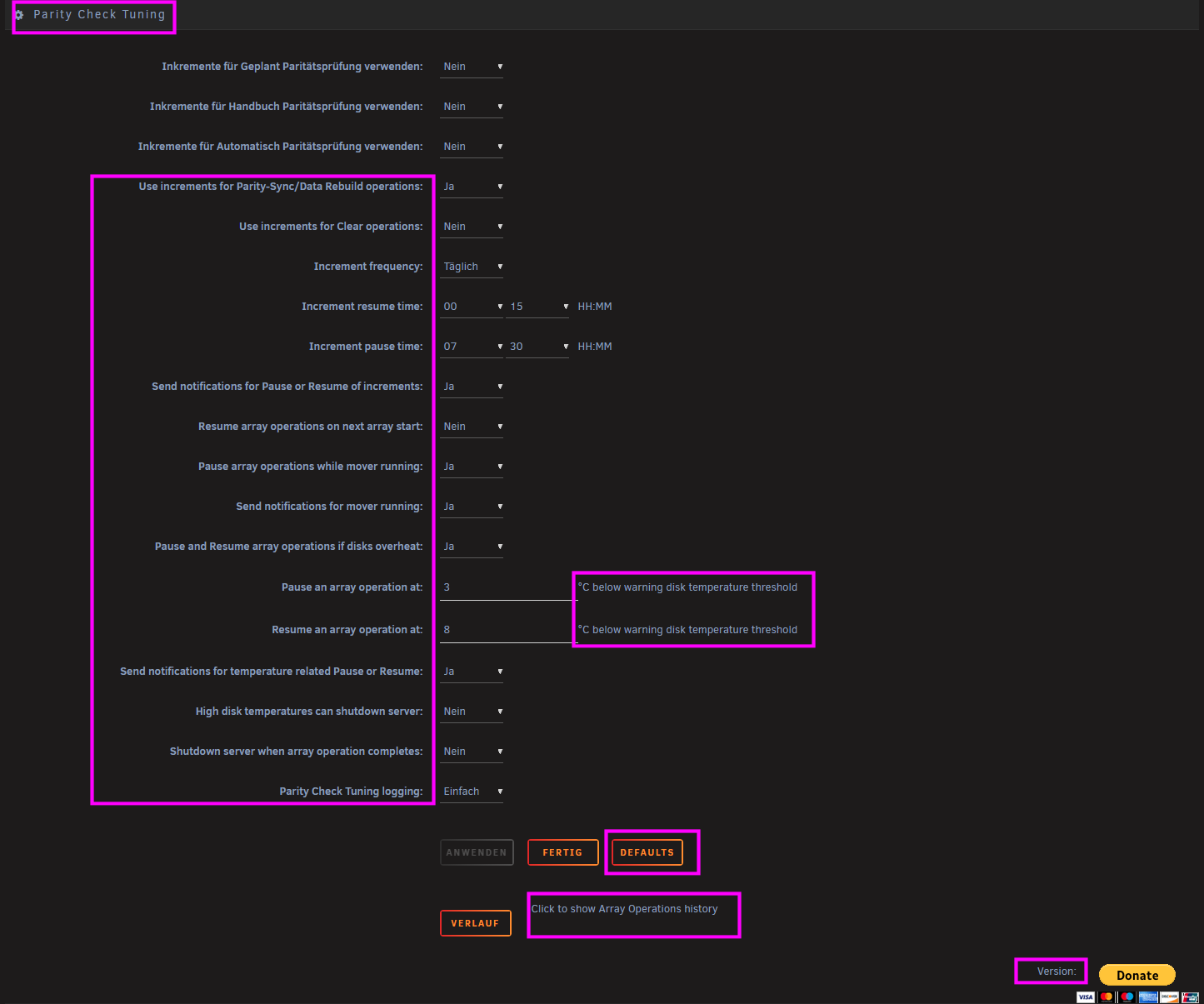

Hi @itimpi,
I'm experiencing an error with the resumption of the partity check after an Unraid reboot.
After a reboot, the currently paused check is aborted.
Unraid version is 7.2.3 and the plugin is dated 2025-12-29.
Here's what I found in the system log:
Jan  2 10:13:35 nginx: 2026/01/02 10:13:35 [error] 9468#9468: *385 FastCGI sent in stderr: "Primary script unknown" while reading response header from upstream, client: 192.168.x.x, server: , request: "GET /plugins/parity.check.tuning/parity.check.entries.php HTTP/1.1", upstream: "fastcgi://unix:/var/run/php-fpm.sock:", host: "192.168.x.x", referrer: "http://192.168.x.x/Tools/Parity.check.problems"
Jan  2 10:16:24 ool www[25505]: /usr/local/emhttp/plugins/parity.check.tuning/parity.check.tuning.php 'config'
Jan  2 10:16:30 Parity Check Tuning: Versions: Unraid 7.2.3, Plugin Version: <unbekannt
Jan  2 10:16:30 Parity Check Tuning: Configuration
Jan  2 10:16:30 Check Tuning: Array#012(#012    [parityTuningScheduled] => 1#012    [parityTuningManual] => 1#012    [parityTuningAutomatic] => 1#012    [parityTuningFrequency] => 0#012    [parityTuningResumeCustom] => 5,15,25,35,45,55 * * * *#012    [parityTuningResumeDay] => 0#012    [parityTuningResumeHour] => 0#012    [parityTuningResumeMinute] => 15#012    [parityTuningPauseCustom] => 0,10,20,30,40,50 * * * *#012    [parityTuningPauseDay] => 0#012    [parityTuningPauseHour] => 3#012    [parityTuningPauseMinute] => 30#012    [parityTuningNotify] => 1#012    [parityTuningRecon] => 0#012    [parityTuningClear] => 1#012    [parityTuningRestart] => 1#012    [parityTuningShutdown] => 0#012    [parityTuningMover] => 1#012    [parityTuningBackup] => 0#012    [parityTuningBackground] => 1#012    [parityTuningDocker] => 0#012    [parityTuningContainers] => #012    [parityTuningHeat] => 0#012    [parityTuningHeatHigh] => 3#012    [parityTuningHeatLow] => 8#012    [parityTuningHeatNotify] => 1#012    [parityTuningHeatShutdown] => 0#012    [parityTuningHeatCritical] => 2#012    [parityTuningHeatTooLong] => 30#012    [parityTuningLogging]
Jan  2 10:17:14 ool www[26070]: /usr/local/emhttp/plugins/parity.check.tuning/parity.check.tuning.php 'config'
Jan  2 10:17:27 Parity Check Tuning: Versions: Unraid 7.2.3, Plugin Version: <unbekannt
Jan  2 10:17:27 Parity Check Tuning: Configuration
Jan  2 10:17:27 Parity Check Tuning: Array#012(#012    [parityTuningScheduled] => 1#012    [parityTuningManual] => 1#012    [parityTuningAutomatic] => 1#012    [parityTuningFrequency] => 0#012    [parityTuningResumeCustom] => 5,15,25,35,45,55 * * * *#012    [parityTuningResumeDay] => 0#012    [parityTuningResumeHour] => 0#012    [parityTuningResumeMinute] => 15#012    [parityTuningPauseCustom] => 0,10,20,30,40,50 * * * *#012    [parityTuningPauseDay] => 0#012    [parityTuningPauseHour] => 3#012    [parityTuningPauseMinute] => 30#012    [parityTuningNotify] => 1#012    [parityTuningRecon] => 0#012    [parityTuningClear] => 1#012    [parityTuningRestart] => 1#012    [parityTuningShutdown] => 0#012    [parityTuningMover] => 1#012    [parityTuningBackup] => 0#012    [parityTuningBackground] => 1#012    [parityTuningDocker] => 0#012    [parityTuningContainers] => #012    [parityTuningHeat] => 0#012    [parityTuningHeatHigh] => 3#012    [parityTuningHeatLow] => 8#012    [parityTuningHeatNotify] => 1#012    [parityTuningHeatShutdown] => 0#012    [parityTuningHeatCritical] => 2#012    [parityTuningHeatTooLong] => 30#012    [parityTuningLogging]
Jan  2 10:17:30 Parity Check Tuning: Parity History invoked
Jan  2 10:18:22 Parity Check Tuning: Parity History invoked
Jan  2 10:34:14 Parity Check Tuning: Manual Nicht-korrigierend Paritätsprüfung canceled (0 Fehler)
The configuration itself seems to be fine. Could there be a bug in the plugin?

Where am I supposed to report the problem that almost none of the translated strings in the lang file paritychecktuning.txt are displayed if the selected display language is not English? Is this a plugin issue or Unraid problem?
Not quite sure what you are saying? I think you are saying you get English even when the language is set to something else, or is the problem something else?
If the problem is you are getting English regardless of the UI language then I am in the process of creating a push request for the English strings so up-to-date translations can be made. It is some time since the English strings have been updated so they are badly out-of-phase with the current plugin release.
I think you are saying you get English even when the language is set to something else...
More or less. Sorry for my complicated wording. As you can see in the screenshot some of the text in English, and some of them were picked up from paritychecktuning.txt - while the language was set to German (also tested with other languages). However, this was the situation even before you issued this new bug-fix release, so I doubt that this is only an 'out-of-phase' problem. Anyway, I've checked your source code on GitHub, and found ca. 6 missing messages in paritychecktuning.txt only. Maybe I missed some more.
If this is the version from the itimpi/parity.check.tuning project then I would be grateful if you mention them to save me trying to find them. If is the version of the file in the Unraid/langUS project (which is the basis for translations) then I know that one is badly out-of-date.
Hm... Maybe not only the lang file is out-of-phase but my findings of the missing messages? What I've done (~4 days ago):
  • looked into the source code on your GitHub project itimpi/parity.check.tuning, and
  • compared the strings there against the strings in paritychecktuning.txt from Unraid repo
Then you issued this new release. Maybe it is better if we wait until the Unraid/lang-en_US repo is refreshed with your update, and then I come back to you if I can still find something missing?
And there is another problem too which I don't know whether it has any impact on this here. I've found, I guess, a bug that depending on from where an actual page is opened in Unraid, e.g. from Main tab, or from Settings panel, or from Plugins panel, sometimes those TXT files with the translated messages simply not loaded/used at all. I'm planning to report this problem to Unraid. I just need some time to put the report into some sort of 'digestible' form.
I have been a bit lazy and not updated the Unraid/lang-en_US repo for some time so waiting makes sense. Over time mismatches will have accumulated. I am currently doing some local testing to try and make sure that all strings used in the current code are correctly reflected in the parity.tuning.txt file in my itimpi/parity.check.tuning repo (just found a few mismatches that will need correcting) before I upload the file to the Unraid/lang-en_US repo.
That sounds as if it is more likely to be a genuine Unraid bug. I do not see how any plugin authors will have visibility or control over this (although I could be wrong)
Parity.check.tuning.page, lines 498-504 and lines 545-551 containing Sunday, Monday, etc. seem to be not translatable.
Good catch - fixing as part of next release (which is about translation support requirements).
