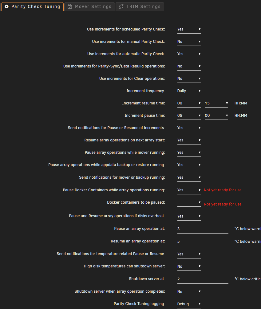

Am getting "Not yet ready for use" errors for the Docker options. Not sure why. Docker is running correctly as far as I'm aware. Here's the PCT settings:
There's nothing listed in the "Docker containers to be paused" option.
Here's my diagnostics:
tower-diagnostics-20250310-1751.zip
TIA
That is because not all of the underlying code is yet ready for release!
I need to look into why the GUI fields are even showing on your system.   I thought I had it set to hide those fields unless I had set up some special options in the plugins configuration file.
Ah OK, thanks for the explanation. I searched for the "Not yet ready for use" message and couldn't find anyone else mentioning that. Seems I'm certainly an outlier for some reason! Let me know if you need me to give you any more info.
I just installed the plugin and also see them (although I may have had a prior version installed long ago that could be influencing things)
