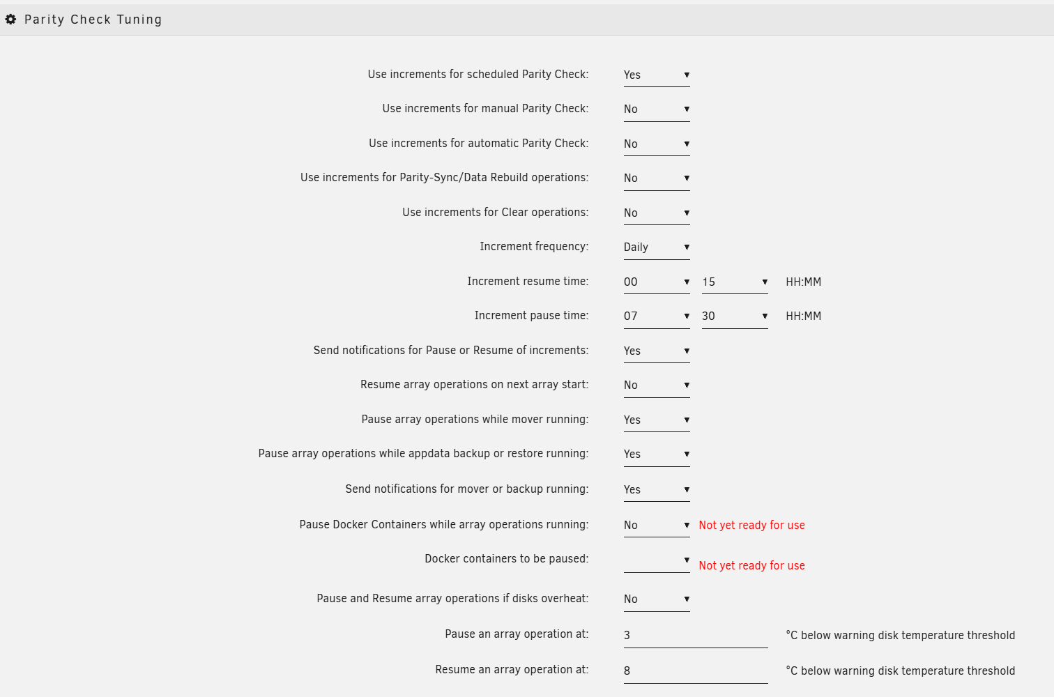

But additionally - I've changed mover schedule to run every hour (I previously had it run once a day but was running low on cache space) and now I get a [...] Array operation not resumed - outside increment window alert every hour
It seems every time the mover stops, it checks to see if it can start the parity check and then sends an alert to say it isn't because it's outside of the parity check schedule... not particularly a helpful alert to be receiving on my phone every hour
I do not get how it's "not ready to use". I need some help.
...they mean it is not implemented yet as a feature - and since it's there for a year or so, I am not sure they will implement it.
That was not really meant to show to the average end user. It was only meant to show when I have set a special 'experimental' setting in the plugins .cfg file. The whole docker related feature has proved more problematical than expected so may never make it to general release. It is helpful when I AM running in experimental mode to see that prompt as in that mode the fields do need to be visible and it is a reminder there is potential work outstanding if this feature is ever going to progress further.

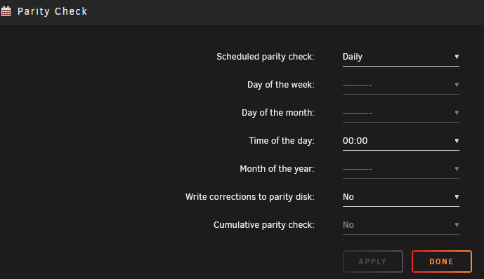

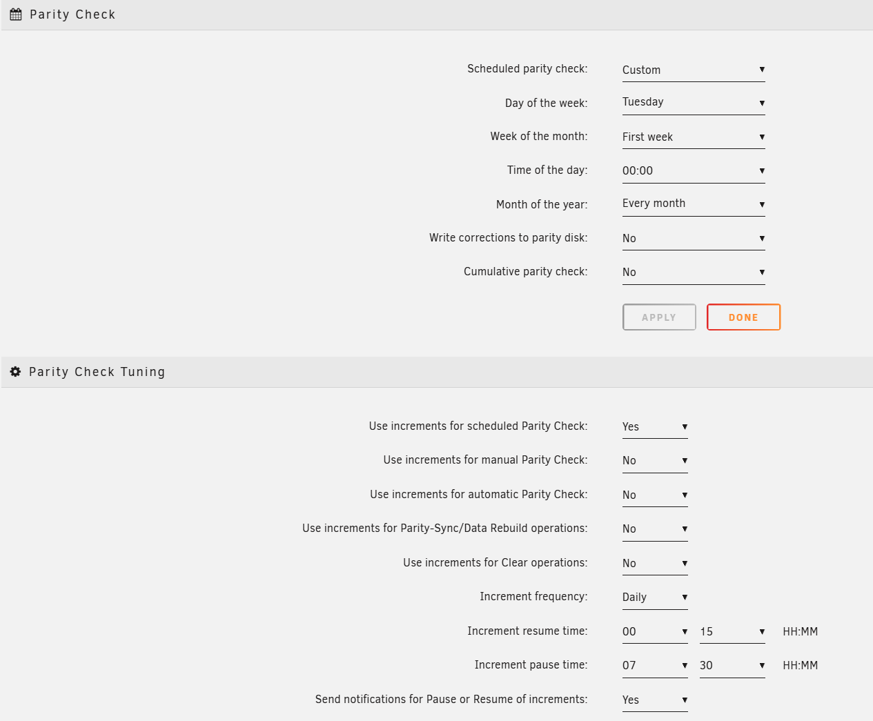

Is the recommendation to disable one when then other is enabled in that case? The second one only started happening today and, like you say, that's the default. I'm running Unraid 7.1.4 and 2024.08.16 for the plugin
Not quite sure what you mean? You need the default parity check enabled to specify when to start them in the first place. What you do NOT want is the Cumulative option set if the Parity Check Tuning plugin is handling increments.
Do you by any chance have the Cumulative option set in the standard settings? I add a check for that when you amend the plugin settings, but would not pick up it being set later - perhaps something I need to check for and warn about?
Weird, I typed a whole message and it only put the picture in so retyping the message...
Sorry, my question probably didn't make sense, you had said "both a parity check is in operation AND you have set the plugin setting "Send notifications for mover or backup running" to Yes" so I was just wondering if it was best practice to disable one of these?
It looks like cumulative option is set to no and greyed out, is that what you mean?
