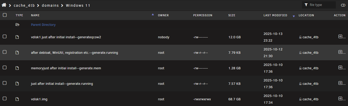

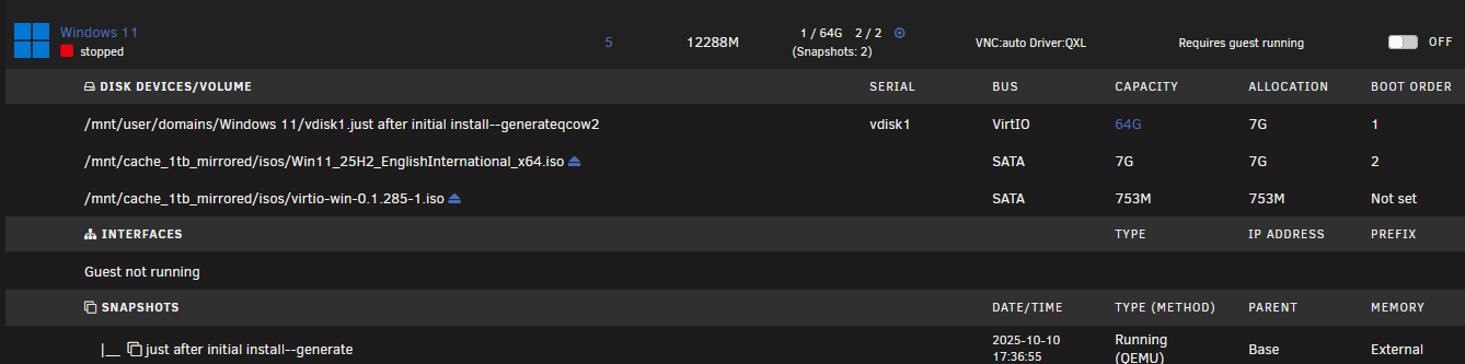

  4. I've been setting up a Win 11 VM. All going well until this evening when I made some changes and it stopped booting. I need to roll back to the last snapshot. In the domains share, I can see the snapshot I want to roll back to. It's "after debloat, WinUtil, registration etc.--generate.running" here: But on the VMs page, even though it says (Snapshots: 2) at the top for this VM, there is only 1 snapshot listed in the Snapshots section at the bottom: Any way to get back to "after debloat, WinUtil, registration etc.--generate.running"? If not, what's the best way to roll back to the "just after initial install" snapshot?

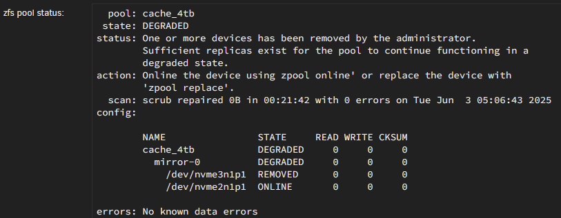

  9. I have just received an alert that there's a problem with the same pool and found that the primary drive is showing as removed: Previously, I was having issues with the mirrored drive showing as removed. Does the code that I added back in March target a particular drive?
