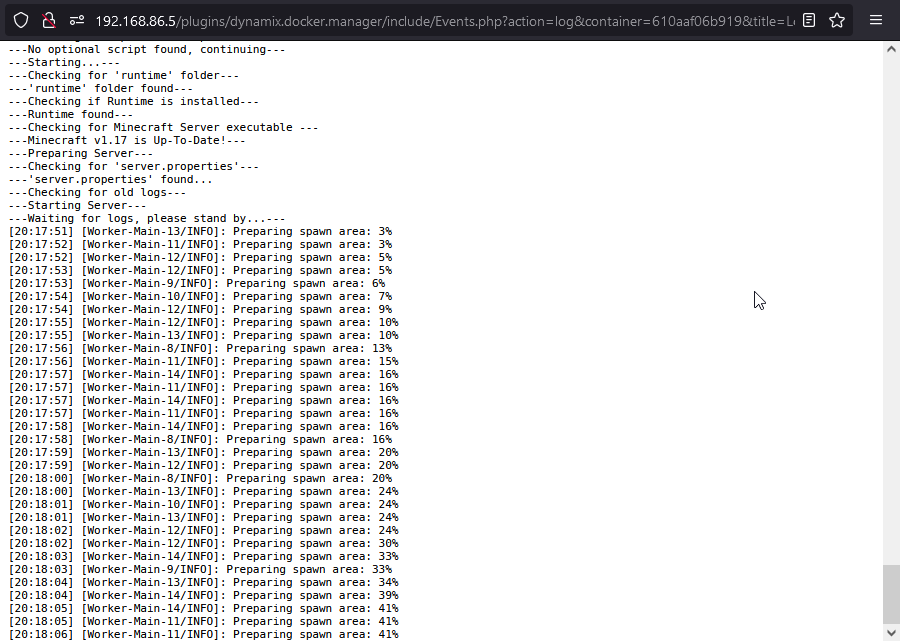

  3. Thanks for replying I tried what you suggested but i still get the error. It's a little different: Error: LinkageError occurred while loading main class net.minecraft.server.Main java.lang.UnsupportedClassVersionError: net/minecraft/server/Main has been compiled by a more recent version of the Java Runtime (class file version 60.0), this version of the Java Runtime only recognizes class file versions up to 55.0 I also tried jre 15 Then the error looks like this: Error: LinkageError occurred while loading main class net.minecraft.server.Main java.lang.UnsupportedClassVersionError: net/minecraft/server/Main has been compiled by a more recent version of the Java Runtime (class file version 60.0), this version of the Java Runtime only recognizes class file versions up to 59.0
  4. Hey I just tried making an 1.17 minecraft server with the minecraftbasicserver docker. I am getting the following error: Error: A JNI error has occurred, please check your installation and try again Exception in thread "main" java.lang.UnsupportedClassVersionError: net/minecraft/server/Main has been compiled by a more recent version of the Java Runtime (class file version 60.0), this version of the Java Runtime only recognizes class file versions up to 52.0 at java.lang.ClassLoader.defineClass1(Native Method) at java.lang.ClassLoader.defineClass(ClassLoader.java:756) at java.security.SecureClassLoader.defineClass(SecureClassLoader.java:142) at java.net.URLClassLoader.defineClass(URLClassLoader.java:468) at java.net.URLClassLoader.access$100(URLClassLoader.java:74) at java.net.URLClassLoader$1.run(URLClassLoader.java:369) at java.net.URLClassLoader$1.run(URLClassLoader.java:363) at java.security.AccessController.doPrivileged(Native Method) at java.net.URLClassLoader.findClass(URLClassLoader.java:362) at java.lang.ClassLoader.loadClass(ClassLoader.java:418) at sun.misc.Launcher$AppClassLoader.loadClass(Launcher.java:355) at java.lang.ClassLoader.loadClass(ClassLoader.java:351) at sun.launcher.LauncherHelper.checkAndLoadMain(LauncherHelper.java:601) My older server (1.16.5) still works fine. It is using a different port aswell. It seems the error is related to the java version in the folder. It is a fresh install so nothing from my old server. Am i doing something wrong?
