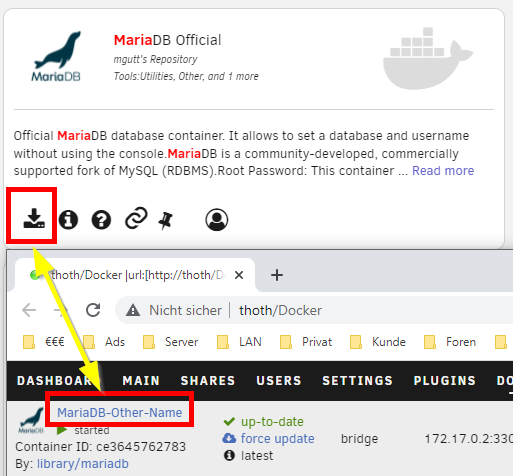

You mean, if you need two databases? Then install the container twice, change the name and the paths in both containers. This would be the easiest option. For example you could name one container "nextcloud_db" and the other "npm_db" and so on.

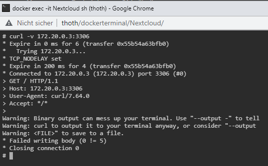

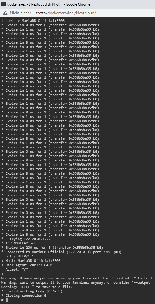

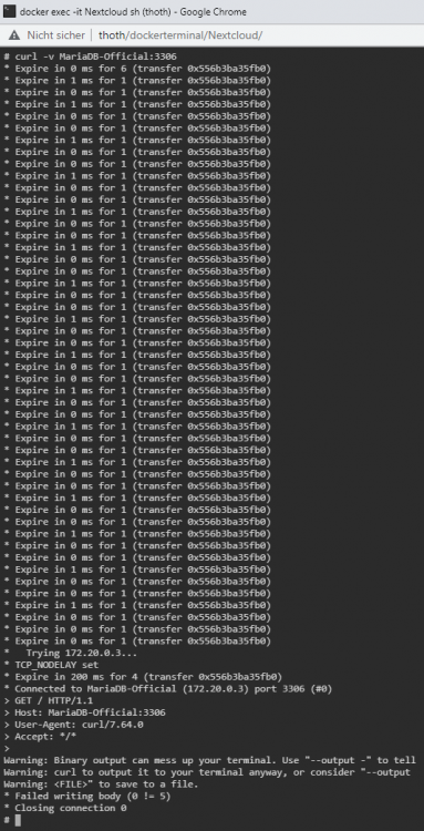

Open the Nextcloud console and use "curl name:3306" or "curl ip:3306" to check the connection to this db container. What are the results? And what are the logs of the upgraded mariadb container?

I also tried your suggestion but with no success. I got the following error with both, the hostname and the ip address.
1688197662_Bildschirmfoto2021-07-17um19_33_51.png.fc9ba09a420d6e5090a919861c859a86.png
After I ran the command the logs of MariaDB say the following but the same error appears when I run the command from Nextcloud container to the older working MariaDB container.
2021-07-17 20:00:04 4 [Warning] Aborted connection 4 to db: 'unconnected' user: 'unauthenticated' host: '172.18.0.4' (This connection closed normally without authentication)
This means that the Nextcloud container can reach the MariaDB container although the errormessage says that Nextcloud can't resolve the hostname?When I try to make an action on the webinterface of nextcloud connected to the latest container of MariaDB the error appears and there is no new record in the log of MariaDB. Thats so confusing... I've never had somthing like this bevor.
I tried the same command from another container (phpMyAdmin) and there the command has apparently been successful.
1387027988_Bildschirmfoto2021-07-17um19_38_59.png.5ecf67f37f5e8c60496bf5970fe2e4bb.png
They are all in the same docker network.

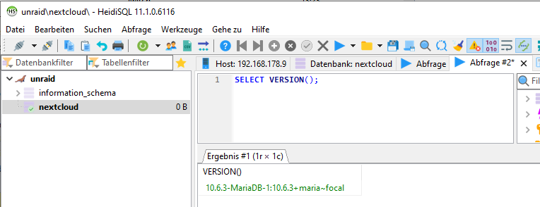

Your updated container runs with MariaDB 10.6.3-focal?
Thank you very much for testing it again.
Until now I used the "latest" tag but I tried the "focal" tag and it didn't work for now.
Since there seems to be no fundamental problem I will keep trying to get it work for me. Now it looks like the problem is nextcloud itself.
If I may find the problem I will report it here.
Thank you very very much for your Help :)

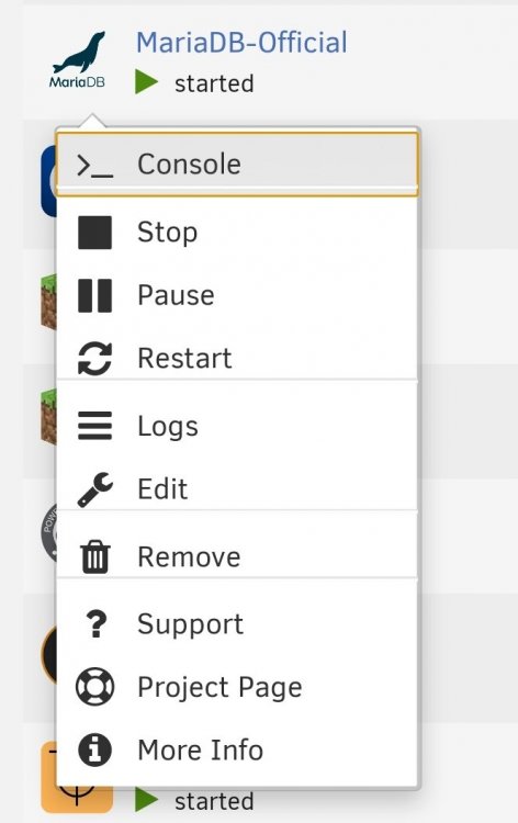

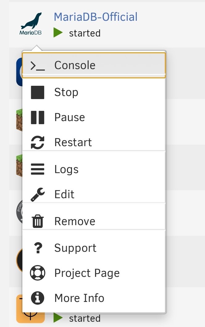

It does. You probably used the unRAID Terminal instead if the container's console?!

Does anyone know why this error occurred or how I can fix it?
According to the error message, it should be my database or?
Edit:
I'm setting up the MariaDB and Nextcloud Docker all over again.
Edit:
That' s a pity, unfortunately it didn't help.
Edited by 4n0nyM
8 hours ago, 4n0nyM said:
When I sync my data from Nextcloud (data is mounted as external storage in Nextcloud) on my PC I recently get:
(An exception occurred while executing a query: SQLSTATE[40001]: Serialization failure: 1213 Deadlock found when trying to get lock; try restarting transaction)
I don't know if it's active by default, but try to disable binary logging:
https://geekflare.com/disable-binary-log-mariadb/
Regarding my research it can help to solve this issue.
Other people solved it by re-installing. Maybe you try to export the database, reinstall and import the database ?!
Thanks for your quick reply 🙂
Found the mariadb.cnf file, but don't know how to edit it. The file cannot be opened with nano. And in Krusader I do not have the /etc folder in the MariaDB directory in the appdata folder.
1608615064_2021-10-0620_17_39-dockerexec-itMariaDB-Officialsh(ArminsNAS).png.bbac3e09f6271aa4ed3923f8ec471340.png
Actually, I had already reinstalled MariaDB today. But maybe I didn't have it deleted properly.
First I had removed the MariaDB Docker, then deleted the created folders, with the plugin "Cleanup Appdata" and after that I checked again with Krusader, if there really is no MariaDB folder left in the appdata folder. Then I installed the official MariaDB Docker again and set up Nextcloud again.
I would try that again, but I have other databases in MariaDB. The easiest way is probably to export each database with phpMyAdmin and once I have reinstalled the MariaDB Docker, import again via phpMyAdmin or?
Edited by 4n0nyM
