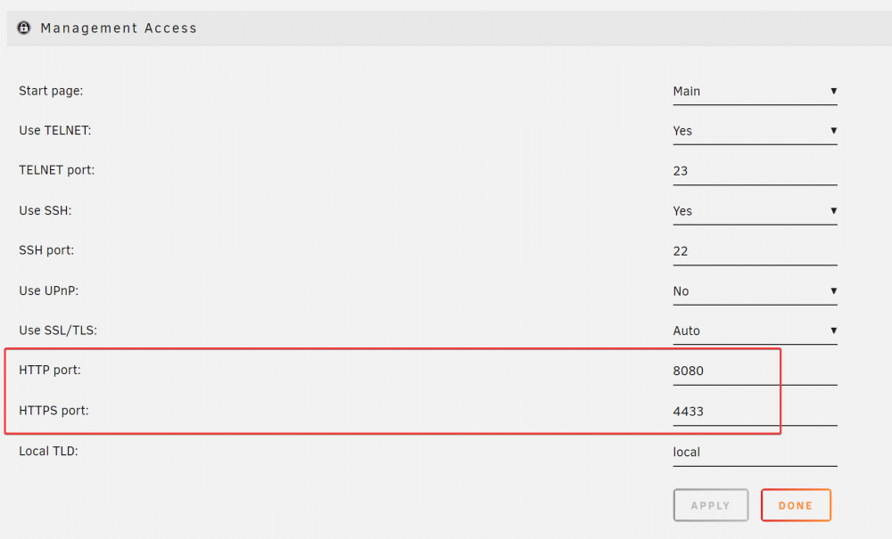

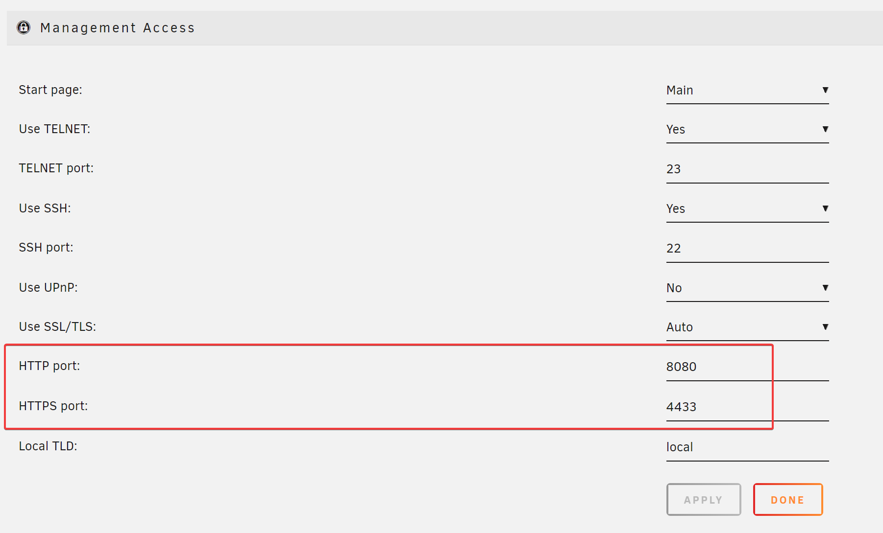

It is possible to run pi-hole on a host network on port 80.
This requires however the GUI to use a different port, which can be set under Management Access -> HTTP port.
So maybe this is an option we should present then as opposed to creating a VLAN set up that most probably don't have networks that are ready for one or an interface that requires hardware they might not have on hand?

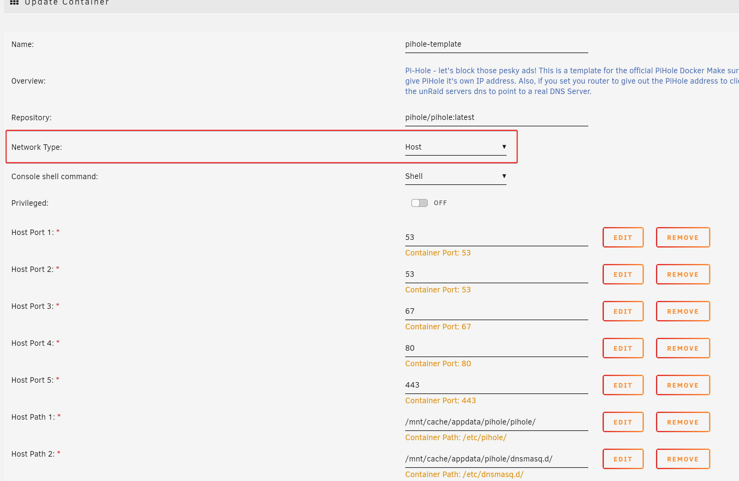

Instructions For Pi-Hole with WireGuard:
For those of you who don't have a homelab exotic enough to have VLANs and who also don't have a spare NIC lying around, I have come up with a solution to make the Docker Pi-Hole container continue to function if you are using WireGuard. Here are the following steps I used to get a functional Pi-hole DNS on my unRAID VM with WireGuard:
1a) Since we're going to change our Pi-hole to a host network, we'll first need to change your unRAID server's management ports so there isn't a conflict with Settings > Management Access:
1) Take your Pi-hole container and edit it. Change the network type to "Host". This will allow us to avoid the problems inherent in trying to have two bridge networks talk to each other in Docker. (Thus removing our need to use a VLAN or set up a separate interface).

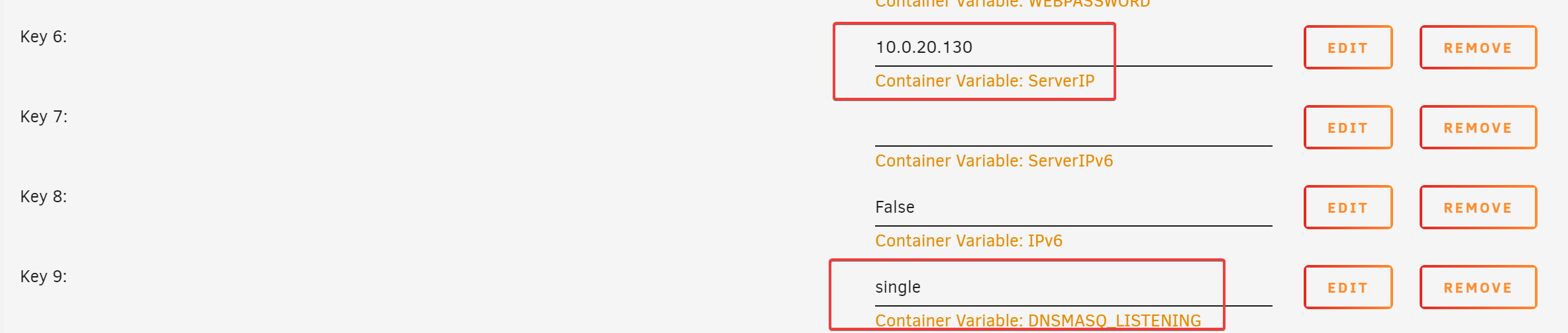

You'll also want to make sure the ServerIP is set to your unRAID server's IP address and make sure that DNSMASQ_LISTENING is set to single (we don't want PiHole to take over dnsmasq):

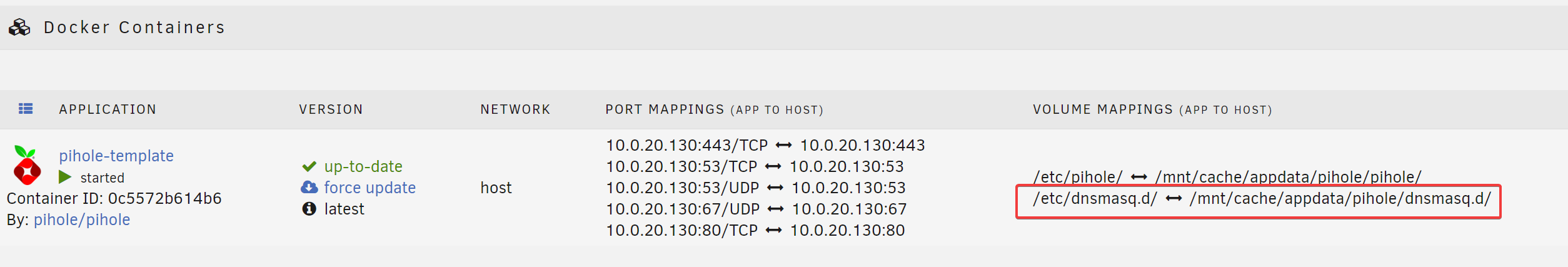

2) We'll need to do some minor container surgery. Unfortunately the Docker container lacks sufficient control to handle this through parameters. For this step, I will assume you have the following volume mapping, modify the following steps as needed:
3) Launch a terminal in unRAID and run the following command to cd into the above directory:
cd /mnt/cache/appdata/pihole/dnsmasq.d/
4) We're going to create an additional dnsmasq config in this directory:
nano 99-my-settings.conf
5) Inside this dnsmasq configuration, add the following:
bind-interfaces
Where the listen-address is the IP address of your unRAID server. The reason this is necessary is because without it, we end up with a race condition depending on if the Docker container or libvirt starts first. If the Docker container starts first (as what happens when you set the container to autostart), libvirt seems to be unable to create a dnsmasq which could cause problems for those of you with VMs. If libvirt starts first, you run into a situation where you get the dreaded: "dnsmasq: failed to create listening socket for port 53: Address already in use". This is because without the above configuration, the dnsmasq created by Pi-hole attempts to listen on all addresses. By the way, this should also fix that error for those of you running Pi-hole normally (I've seen this error a few times in the forum and I can't help but wonder if this was the reason we went with the ipvlan set up in the first place).
Now, just restart the container. I tested this and it should not cause any interference with the dnsmasq triggered by libvirt.

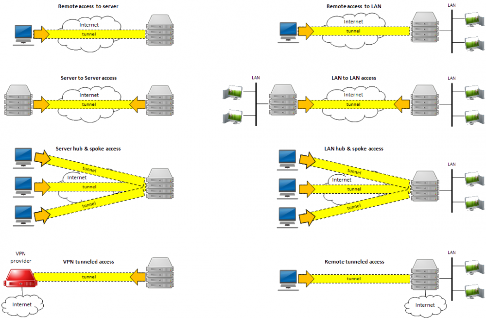

Does anyone have a breakdown on the different remote tunnel types?  Like the differences and limitations of each type and why or when you would want one over the other?
