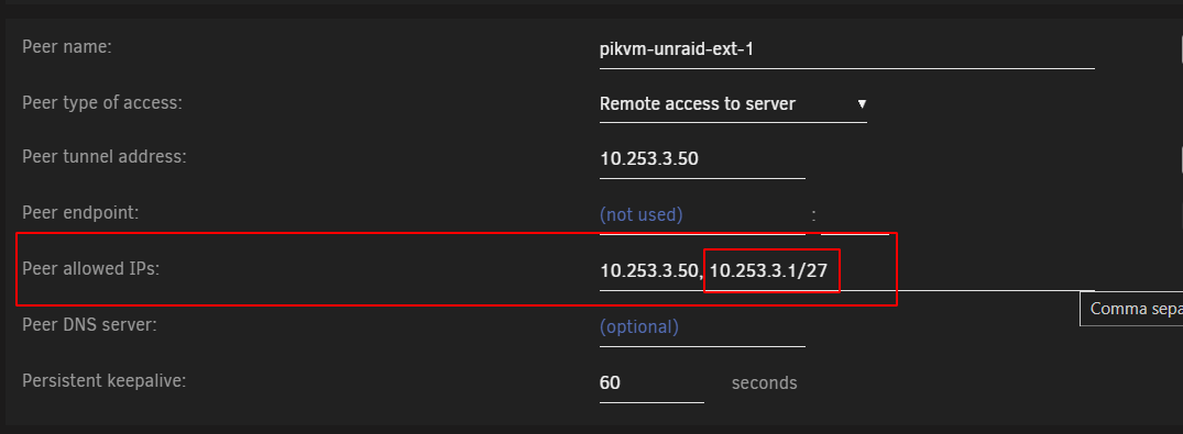

Hi, it there a place to report a "bug" with wireguard?
if i add a IP to "Peer allowed IPs", it won't be shown in the downloadable config:
