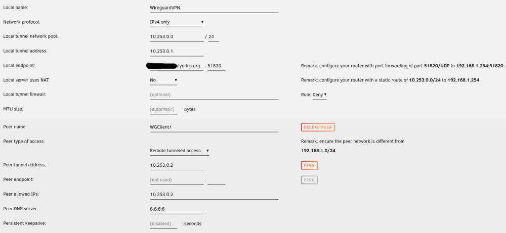

Might be unrated - but maybe someone here can help.
I've tried using this plugin on 2 different unraid servers located on 2 different networks.
In both I get the same result - I can access the main unraid server, but nothing more (meaning, I can enter the IP on the unraid server and it works perfectly. nothing else in the network [such other servers] works).
Both servers are behind dedicated pfsense firewalls.
Both have the port forwarded as needed.
I've tried the Advance setup on one (NAT to false, Docker Host access to custom networks "enabled" and firewall rule):
Firewall rules I've tried, but seems to make no difference:
And here is the second one,  with the "basic" config:
Port forwarding for both looks mostly the same:
Any ideas?
And thanks for the plugin! :)
In your screenshot, next to "local server uses NAT" there is a remark that says "configure your router with a static route..." did you do that?  A static route is not a firewall rule, I'd remove those extra firewall rules unless you know for sure they are needed.
Probably best if you go through the WireGuard quickstart quide, it has a lot more detail including a section on "Complex networks" that explains how a few settings work together to give you access to your LAN:
Thanks for the reply,
I've added a static route now on both configs -
Some improvements, but I still having some issues.
On the simple server -
I can now connect to the Unraid UI and to the pfsense UI. but I still can't access anything else on the network.
I've tried the firewall rules because of the firewall log:
(first one 192.168.0.31:8123 is the source, the 10.253.0.2 is the destination)
it looks like the remote device (the VPN peer) try to talk to the local service, but when the local service try to "take back" there's an issue.
on the complex server, it's basically the same + but I can't access the main UI as it forward automatically to the local domain (unraid.privateFQDN.org) and it stops there. dockers on the unraid server (using the IP address) connect perfectly.
Edit:
Found the fix the the issue, not sure why my config is causing it - but the scenario here is Asymmetric Routing.
The solution is to enable "Bypass firewall rules for traffic on the same interface" under System/Advanced/Firewall & NAT:
That fix both of the issues described above.
Edited by IpDo
