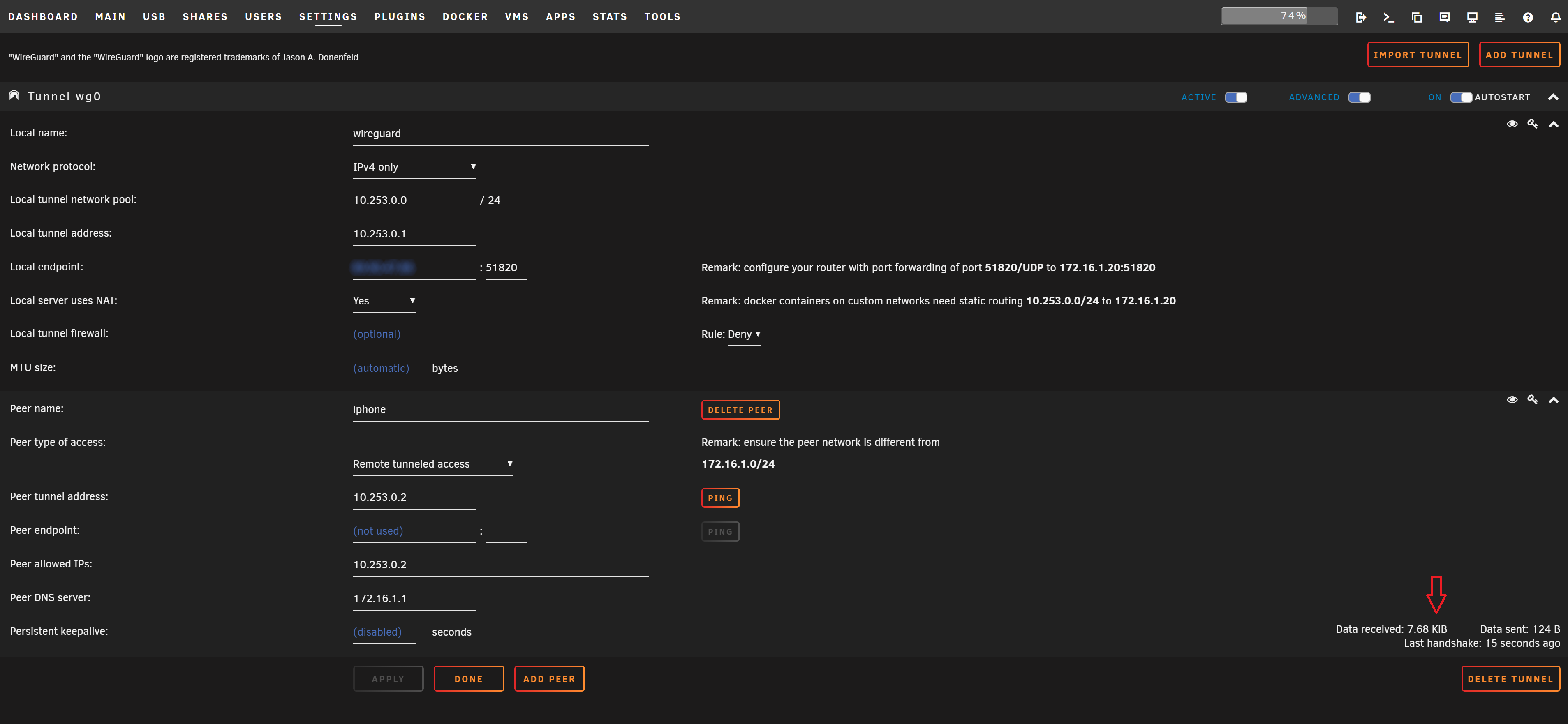

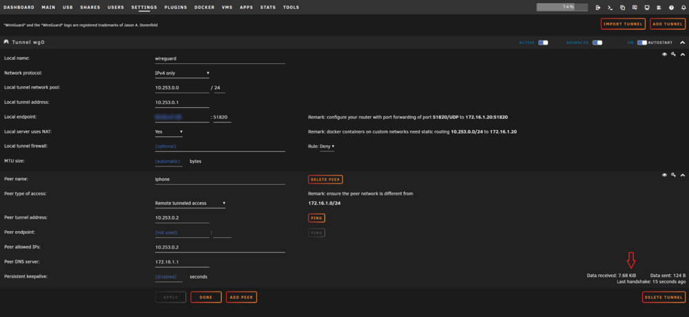

  5. Hello, I need some help. I've been struggling for some time to make wireguard work and I can't. If I run wireguard in docker it works without problems. It seems that the handshake it is ok but the unRAID does not send data. Any help is appreciated. Thank You WireGuard log: wg-quick up wg0 [#] ip link add wg0 type wireguard [#] wg setconf wg0 /dev/fd/63 [#] ip -4 address add 10.253.0.1 dev wg0 [#] ip link set mtu 1420 up dev wg0 [#] ip -4 route add 10.253.0.2/32 dev wg0 [#] logger -t wireguard 'Tunnel WireGuard-wg0 started';/usr/local/emhttp/webGui/scripts/update_services [#] iptables -t nat -A POSTROUTING -s 10.253.0.0/24 -o br0 -j MASQUERADE;iptables -t nat -A POSTROUTING -s 10.253.0.0/24 -o vhost0 -j MASQUERADE [#] ip -4 route flush table 200 [#] ip -4 route add default via 10.253.0.1 dev wg0 table 200 [#] ip -4 route add 172.16.1.0/24 via 172.16.1.1 dev br0 table 200 wg-quick down wg0 [#] ip link delete dev wg0 [#] logger -t wireguard 'Tunnel WireGuard-wg0 stopped';/usr/local/emhttp/webGui/scripts/update_services [#] iptables -t nat -D POSTROUTING -s 10.253.0.0/24 -o br0 -j MASQUERADE;iptables -t nat -D POSTROUTING -s 10.253.0.0/24 -o vhost0 -j MASQUERADE [#] ip -4 route flush table 200 [#] ip -4 route add unreachable default table 200 [#] ip -4 route add 172.16.1.0/24 via 172.16.1.1 dev br0 table 200 Here is my configuration:

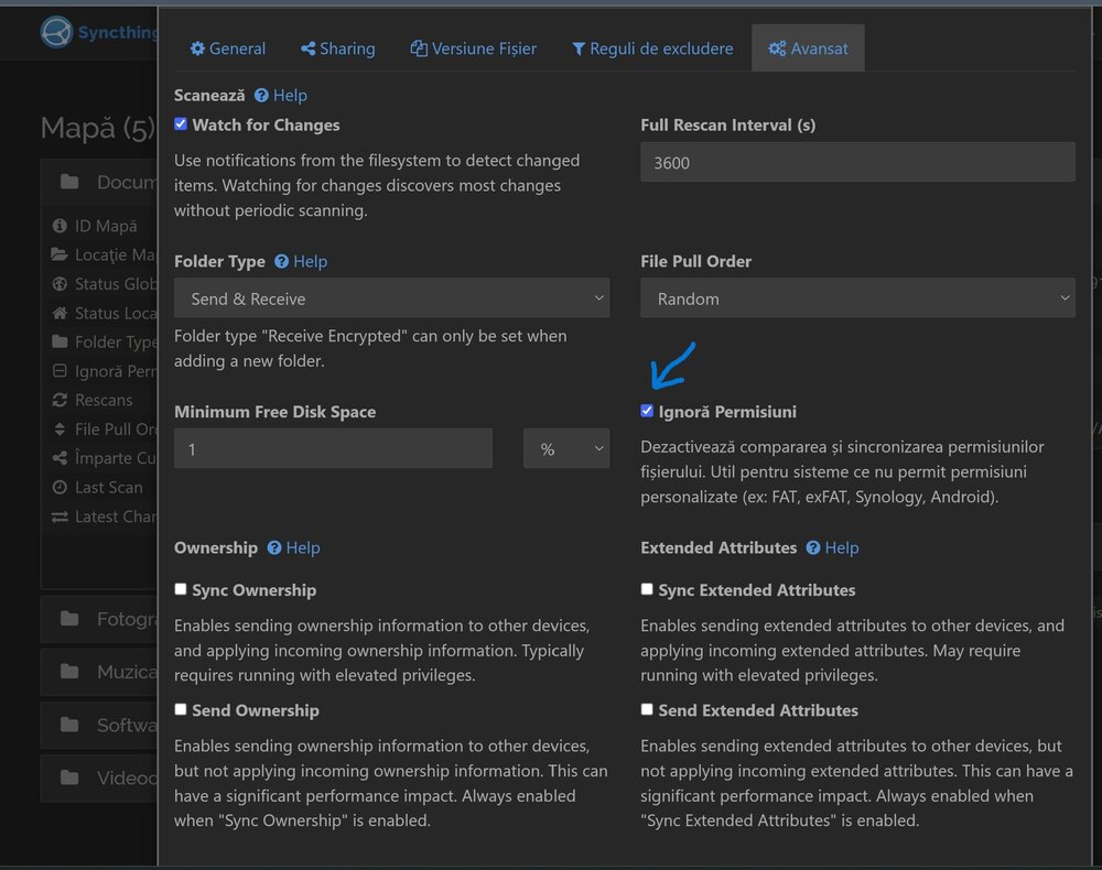

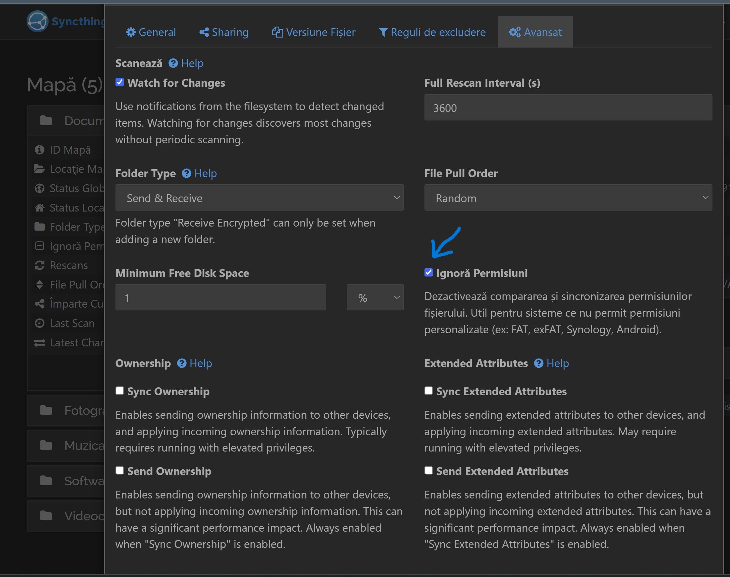

  7. So did I, I came to see why it appears like this. 😀
  8. This solved my problem, only in unRAID folder sync did I activate the "ignore permissions" option.
