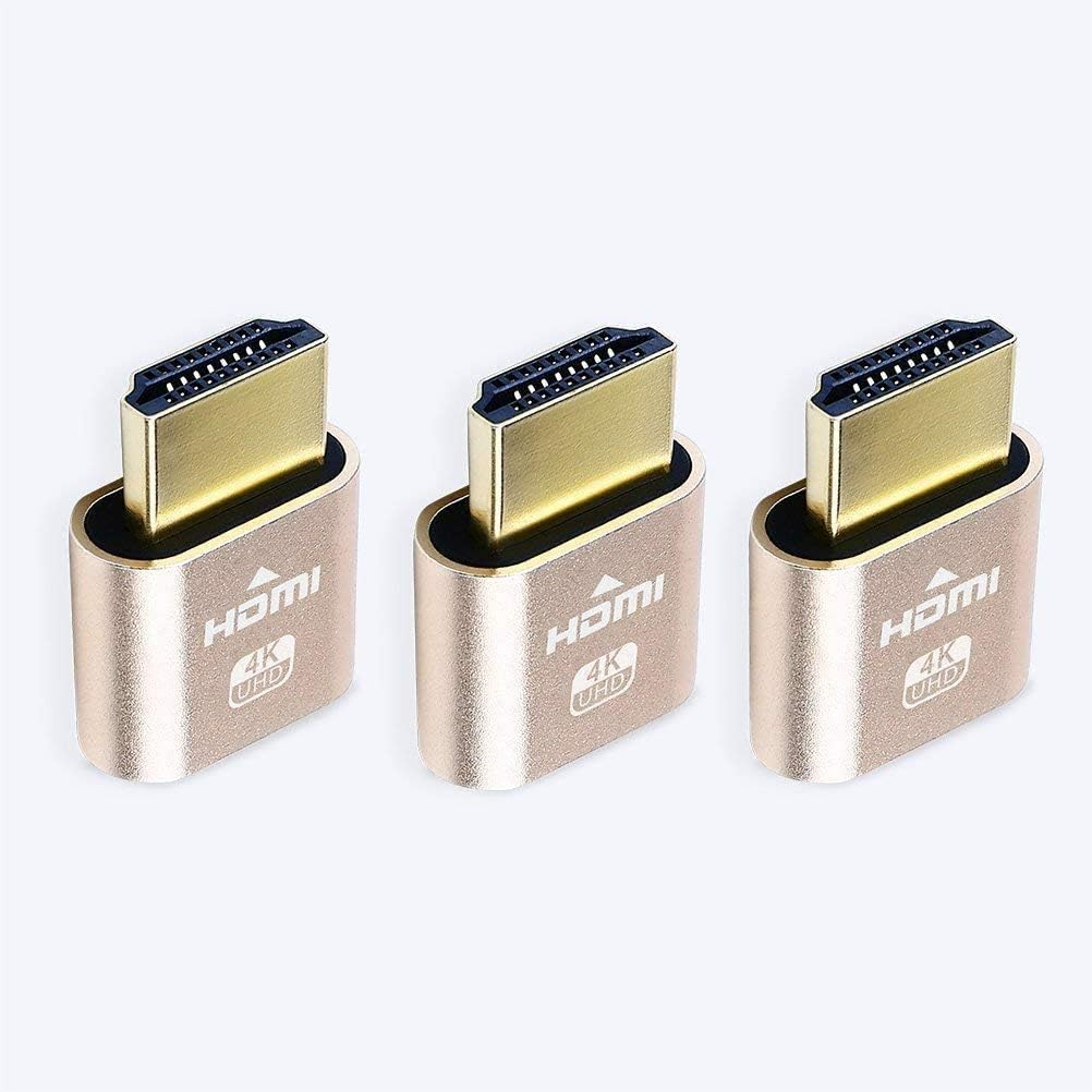

  9. Yeah, I would first try just changing the Plex Device to /dev/dri and seeing what GPU's you can select in Plex and then testing again. Most reports I read indicated that the HDMI dummy plug is mostly needed for the iGPU to be used and not so much discrete GPU's, but also, does not hurt to have the dummy plug. I'm not sure how it affects power consumption though, I know just installing my Arc card increased my power draw by a little over 15 W on my server so I'm assuming it's the card's idle power draw. I can't see Linux kernel 6.9-rc3 breaking anything Arc related over 6.9-rc1, but if you can easily roll-back to the same version as me, at least it might be easier to troubleshoot.

  15. Just as confirmation here, the multi-gpu-stat does work with multiple Intel GPU's, in my case, using the Thor2000 6.7.9 custom kernel for my Arc A750 GPU alongside my 9700k iGPU. Both have HDMI Dummy Plugs.
  16. Just installed an Arc A750 in my server to upgrade from the 9700k iGPU. The server also happens to have a GTX 750 Ti that I was using for a VM that I had seen reports of the Thor2000 custom kernel not playing nicely with Nvidia-Driver-Kernel. I'm on Unraid 6.12.8 and used Thor2000 driver: https://github.com/thor2002ro/unraid_kernel/releases/tag/20240310 ( Linux 6.7.9-thor-Unraid+ x86_64) My process: Uninstalled Nvidia-GPU-Plugin Shutdown server Copied the bz* files Installed GPU with same model HDMI Dummy Plug in the iGPU Booted system Updated GPU-Stat to show new DG2 GPU Deleted all codecs from Plex Appdata folder Added /dev/dri/renderD128 as a new device Started Plex Docker Changed Transcode Device to DG2 Initial testing was great, hardware transcoding now of AV1 content to H264, 1080p content typically transcoding at ~11x the framerate which is amazing. GPU-Stat also show the usage properly. Second set of tests on 4k content worked great as well, including VP9 and AV1 SDR and HDR content. To note, I still have HDR tone mapping disabled in Plex since my Computer and main TV support HDR already so no need to tone-map. Third set tests on 8k content was where it all fell apart. Previously, my i7-9700k would struggle along to software decode 8k content then use the iGPU to hardware and very very very choppy. With the Arc A750, it shows it as hardware transcoding now, the audio plays back flawlessly and the seek bar no longer skips and the transcode buffer looks to fill up quickly, but all I get is a solid green video output. This applies to VP9 and AV1, SDR or HDR 8k videos. If I switch Plex Transcoder from the Arc A750 back to the iGPU, it will Software Decode AV1 8k and Hardware Encode to H264 with some hitches as the software decoder can't keep up, but it at least works on all my 8k files. It's just something with the Arc A750 that falls flat on its face when trying to Hardware Decode 8k Content, SDR or HDR.

  21. This is the lost wisdom that Folding@Home and BOINC have been dealing with for ages. This was even required back on Haswell days on Windows if you were running a dedicated GPU and wanted to use the iGPU for transcoding video or OBS for some cheap streaming setup. I also just had this more recently on my i7-9700k Unraid Server. I have also have a 1050 Ti installed for Folding@Home and wanted to use the iGPU for Plex HW transcoding so I had to pick up an HDMI dummy plug for the motherboard iGPU HDMI slot. The one I picked up is https://www.amazon.ca/gp/product/B07C4TWZRM but most of them you find should work, just check reviews as always and focus on the non 5-star reviews to look for major problems with them.
