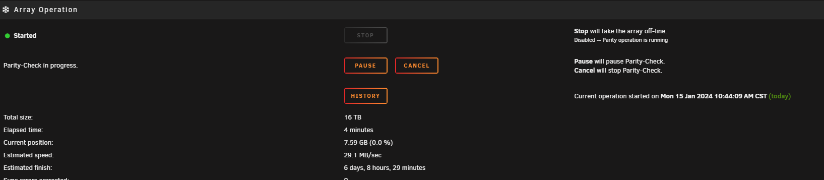

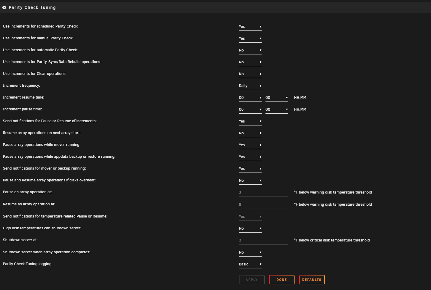

Just installed the plugin.  Changed the settings to below:
Started a manual parity check (it's not 10:46 local time) - and the check is running....it's not paused until 00:00 tomorrow morning:
Did I miss a setting/configuration/something somewhere?

Not sure what question you are asking?   There can be a delay (up to 15 minutes) before the plugin runs its idling monitor task and notices that a Manual check has been initiated.
if you want it to only run the Manual check between the increment times specified then hit the Pause button and let the plugin take over Resume/Pause activity.
Thanks for the reply!  After reading your comment of "...up to 15 minutes" I went ahead and started another manual parity check...It never did pause it:
I've manually paused it and will see if the plugin kicks it off at midnight and runs til 6am (per it's settings).
Thx
Thx
It would not pause it until the Pause time came up.    This is a deliberate decision as it is easy to manually pause it just after starting it and more often than not if you start it manually you WANT to leave it running until the increments start kicking in.

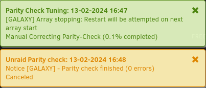

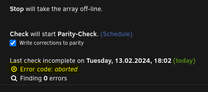

Thanks for the quick reply!
I've just let the complete check once finished and then recreated the issue describe in number 2:
- Set log output to "testing mode"
- Started manual parity check until ~0.1% was reached
- Pause the manual parity check
- Stop the Array
- This time I've got two notifications after stopping the array (see attached screenshot)
- Shutdown the Server
- Start the Server
- Start the Array
- No "Resume" function/button is provided and also after waiting for about 5 to 10 minutes, no automatic start was scheduled
Also please see the diagnostics logging in the attached files.
Thank you in advanced.
galaxy-diagnostics-20240213-1658.zip

Additional: As a "partial workaround" it went completely fine, when not shutting down the server but putting it to sleep (s3).
I've tried to re-create the exact process after enabling the syslog server (mirror to flash & local cache drive). Is it enough to export the diagnostics like last time? If so, it is attached.
Also attached two screenshots. One for the notification (this time only the one message) and the other one as a side note that it is stated as "Last check incomplete on Tuesday, 13.02.2024, 18:02 (today) | Error code: aborted" after the boot process of the server finished and the array is started all over again.
I've turned the syslog server off, once I've finished writing this comment.
Thank you!
galaxy-diagnostics-20240213-1816.zip
