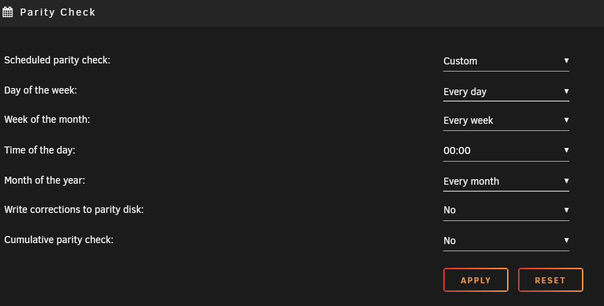

how i can setup check parity in Unraid - '0 0 1 */3 *' every 3 month on 1 day  0:00?
if i set custom i can select months , but no day of month select , only weeks :
i can manually add (0 0 1 */3 *) to parity-check.cron , but not shure it will work it not shown right in webGUI ...
No idea I am afraid.   That part of the scheduling is handled by the core Unraid system and not by the plugin.   Maybe you need to raise a feature request/bug about this?
Yes i know , sorry , i will try it ...

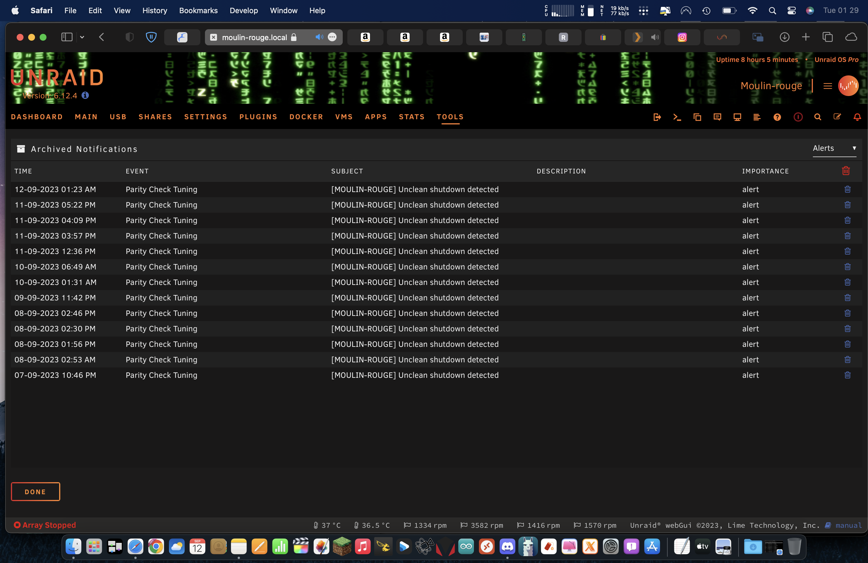

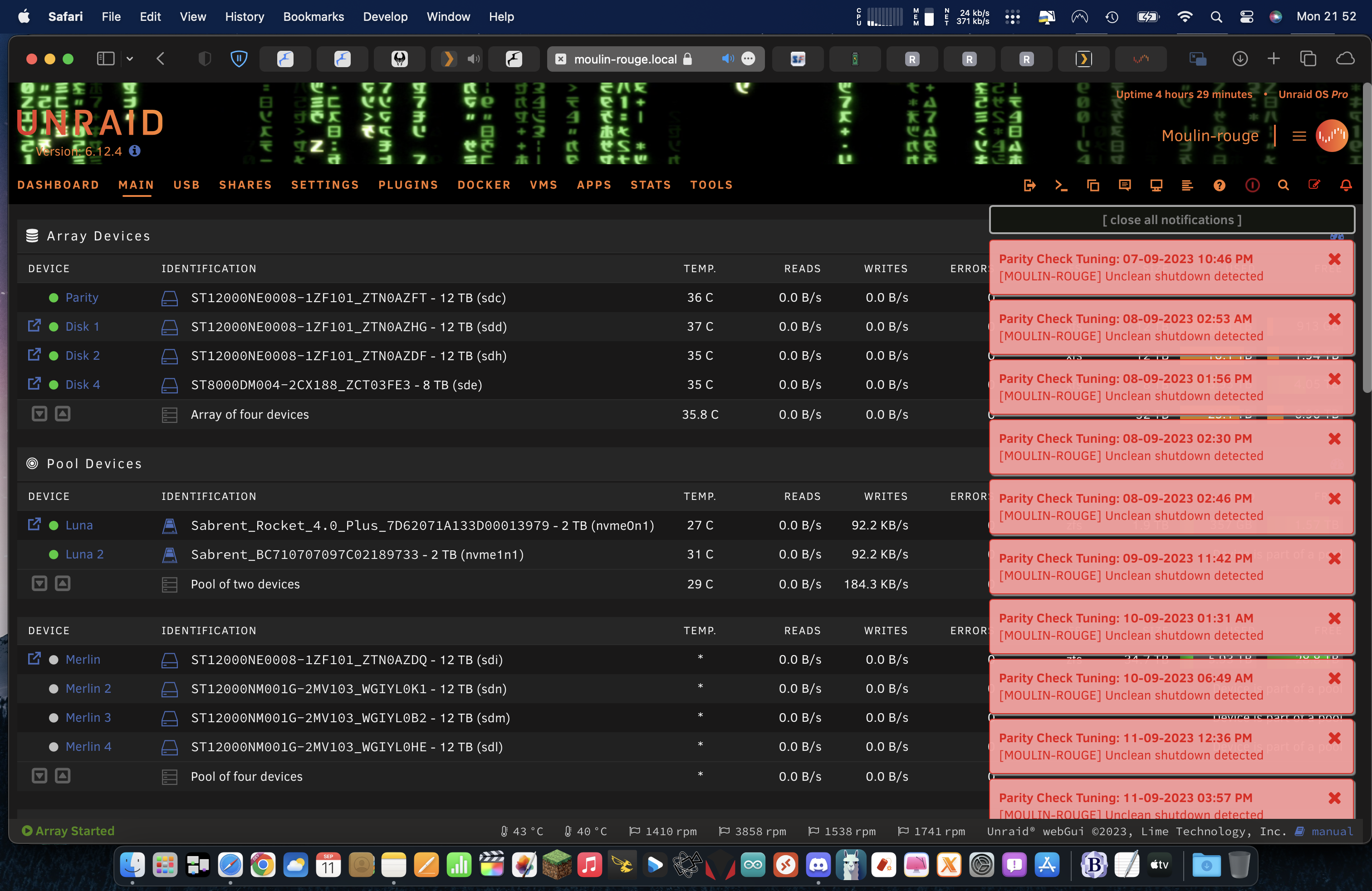

On 6.12.4 I keep getting notifications from 'parity check tuning of unclean shutdown detected'... but I'm not sure if these are correct. How can I double check?
Edited by dopeytree
 If you are on the latest release of the plugin (2023.09.06) then there is a good chance it IS genuine but it would be nice to make sure.   If you enable the 'testing' mode of logging in the plugin's settings and once this has happened post a copy of you system's diagnostics I can check whether it is genuine.   It should also be present in the Unraid syslog but you have to find it there.

I noticed if it is a 'real' unclean shutdown the system will start a check. VS this message just occurs all the time. I wondered if it was from a historic unclean shutdown or something?
I have just completed a parity check after the server crashed a few days ago.
moulin-rouge-diagnostics-20230911-1334.zip
Edited by dopeytree
3 hours ago, dopeytree said:
Diags attached.
I cannot see any sign in the posted diagnostics that the notification about unclean shutdown was ever sent😒.  Are you sure you got it this time around?
Something's triggering it but I'm not worried about it. More curious if anyone else has it.

Any chance of enabling the Testing mode of logging in the plugin settings; waiting till you get more occurrences of the notification; and then posting your diagnostics.   That would allow me to confirm what is happening under the covers.
Diags with the debug logging enabled. I stopped the array to cause the notification.
At the moment I am very confused.   According to the syslog in the diagnostics the plugin has never written a notification (it writes a syslog entry every time before trying to generate a notification).   It is almost as if there is something stuck at the Unraid level that is causing this repeated notification but I cannot think what that might be.
BTW:  You had the 'Debug' level of logging enabled - to do a more thorough analysis I would need the 'Testing' level of logging enabled.
