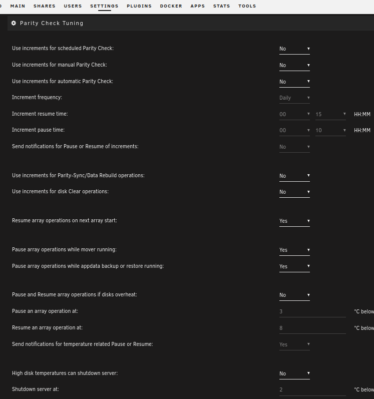

  1. Apologies, that's my fault for not reading properly! My answer to this seems to be no&yes - whilst there are of course many cases, in my particular case where I know a parity operation already kicked off, having notifications that my mover caused it to stop/start every hour when the mover is chugging along is not useful. Hope that's at least one perspective! Thanks again
  2. Running 2023.09.06 (and the others this month) I am getting notifications when my config does not have such options enabled (afaik!) - config: # cat /boot/config/plugins/parity.check.tuning/parity.check.tuning.cfg parityTuningScheduled="0" parityTuningManual="0" parityTuningAutomatic="0" parityTuningFrequency="0" parityTuningResumeCustom="5,15,25,35,45,55 * * * *" parityTuningResumeDay="0" parityTuningResumeHour="0" parityTuningResumeMinute="15" parityTuningPauseCustom="0,10,20,30,40,50 * * * *" parityTuningPauseDay="0" parityTuningPauseHour="0" parityTuningPauseMinute="10" parityTuningNotify="0" parityTuningRecon="0" parityTuningClear="0" parityTuningRestart="1" parityTuningMover="1" parityTuningCABackup="1" parityTuningHeat="0" parityTuningHeatHigh="3" parityTuningHeatLow="8" parityTuningHeatNotify="1" parityTuningHeatShutdown="0" parityTuningHeatCritical="2" parityTuningHeatTooLong="30" parityTuningLogging="0" parityTuningLogTarget="0" parityTuningMonitorDefault="17" parityTuningMonitorHeat="7" parityTuningMonitorBusy="6" parityTuningMonitorPartial="1" parityProblemType="sector" parityProblemStartSector="0" parityProblemStartPercent="0" parityProblemEndSector="100" parityProblemEndPercent="0" parityProblemCorrect="0" parityTuningBackup="1" parityTuningShutdown="0" GUI: Yet I'm getting 'mover no longer running' and 'mover running' notifications. Any ideas? Thanks! E

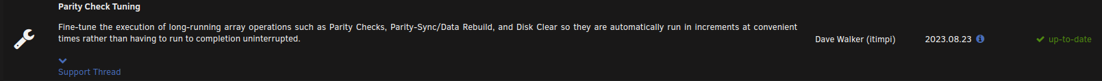

  5. Thanks for the quick update! I did the update as per the screenshot I'm running 2023.08.23 I also see the file: # md5sum /boot/config/plugins/parity.check.tuning/parity.check.tuning-2023.08.23.txz be35b73c7c37eee02f3da99688833180 /boot/config/plugins/parity.check.tuning/parity.check.tuning-2023.08.23.txz However my logs say: Aug 23 16:27:40 unraid01 Parity Check Tuning: Versions: Unraid 6.12.3, Plugin Version: 2023.07.21 Aug 23 16:27:40 unraid01 Parity Check Tuning: Configuration: Array#012(#012 [parityTuningScheduled] => 0#012 [parityTuningManual] => 0#012 [parityTuningAutomatic] => 0#012 [parityTuningFrequency] => 0#012 [parityTuningResumeCustom] => 5,15,25,35,45,55 * * * *#012 [parityTuningResumeDay] => 0#012 [parityTuningResumeHour] => 0#012 [parityTuningResumeMinute] => 15#012 [parityTuningPauseCustom] => 0,10,20,30,40,50 * * * *#012 [parityTuningPauseDay] => 0#012 [parityTuningPauseHour] => 0#012 [parityTuningPauseMinute] => 10#012 [parityTuningNotify] => 0#012 [parityTuningRecon] => 0#012 [parityTuningClear] => 0#012 [parityTuningRestart] => 1#012 [parityTuningShutdown] => 0#012 [parityTuningMover] => 1#012 [parityTuningBackup] => 1#012 [parityTuningHeat] => 0#012 [parityTuningHeatHigh] => 3#012 [parityTuningHeatLow] => 8#012 [parityTuningHeatNotify] => 1#012 [parityTuningHeatShutdown] => 0#012 [parityTuningHeatCritical] => 2#012 [parityTuningHeatTooLong] => 30#012 [parityTuningLogging] => 1#012 [parityTuningLogTarget] => 0#012 [parityTuningMonitorDefault] => 17#012 Aug 23 16:27:40 unraid01 Parity Check Tuning: DEBUG: Created cron entry for 6 minute interval monitoring Aug 23 16:27:40 unraid01 Parity Check Tuning: DEBUG: Updated cron settings are in /boot/config/plugins/parity.check.tuning/parity.check.tuning.cron I continued assuming the version text was possibly not updated and unfortunately the 'outside increment window' message still appears. # grep -E 'Parity|md:|move' /var/log/syslog Aug 23 23:00:02 unraid01 root: mover: started ... Aug 23 23:00:29 unraid01 Parity Check Tuning: DEBUG: Automatic Correcting Parity-Check running Aug 23 23:00:29 unraid01 Parity Check Tuning: Send notification: mover running: Aug 23 23:00:30 unraid01 Parity Check Tuning: DEBUG: Automatic Correcting Parity-Check running Aug 23 23:00:30 unraid01 Parity Check Tuning: DEBUG: detected that mdcmd had been called from sh with command mdcmd nocheck PAUSE Aug 23 23:00:35 unraid01 Parity Check Tuning: DEBUG: ...Pause Automatic Correcting Parity-Check Aug 23 23:00:35 unraid01 Parity Check Tuning: DEBUG: Created cron entry for 6 minute interval monitoring Aug 23 23:00:35 unraid01 Parity Check Tuning: DEBUG: Updated cron settings are in /boot/config/plugins/parity.check.tuning/parity.check.tuning.cron Aug 23 23:00:35 unraid01 kernel: md: recovery thread: exit status: -4 Aug 23 23:00:35 unraid01 Parity Check Tuning: Paused: Automatic Correcting Parity-Check (13.6% completed) Aug 23 23:00:57 unraid01 root: mover: finished Aug 23 23:07:07 unraid01 Parity Check Tuning: DEBUG: Automatic Correcting Parity-Check paused Aug 23 23:07:07 unraid01 Parity Check Tuning: Send notification: mover no longer running: Aug 23 23:07:08 unraid01 Parity Check Tuning: Array operation not resumed - outside increment window: Automatic Correcting Parity-Check (13.6% completed) Aug 23 23:12:40 unraid01 Parity Check Tuning: DEBUG: Automatic Correcting Parity-Check paused Aug 23 23:18:30 unraid01 Parity Check Tuning: DEBUG: Automatic Correcting Parity-Check paused Thanks!
