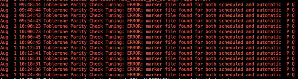

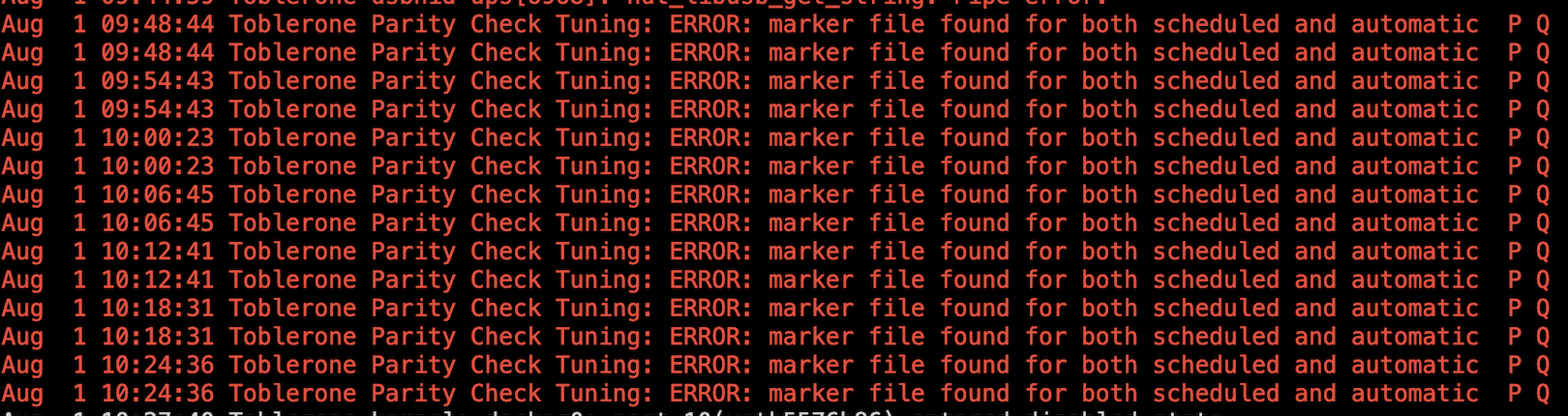

I'm getting a lot of errors in my syslog with the following, is this normal?
Thank you!
Thank you!
This is an internal check in the plugin for a state I did not think would occur.   Things should still work OK.
Were you doing anything unusual in terms of array operations leading up to this?   The diagnostics might give me a clue.
if you know how to recreate it then I would appreciate it if was possible to get a log with the plugin’s Testing logging mode active so I can see what triggered it.

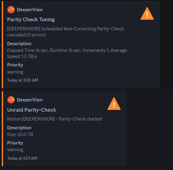

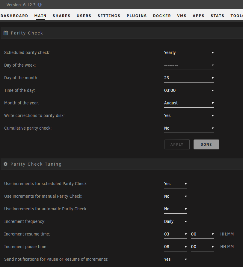

On 6/14/2023 at 12:14 PM, itimpi said:
That is expected behaviour as the moment the plugin detects a Manual Check has been started and you have set the option to run manual checks in increments it will automatically pause the check if it is outside the increment period (ready to restart it when the next increment starts).
Run into something odd myself that is kind of like the above  - I have no increment windows set, my parity is checking due to a unclean shutdown and I see this:
# grep -E 'Parity|md:' /var/log/syslog
Aug 23 00:48:38 unraid01 Parity Check Tuning: DEBUG:   Automatic Correcting Parity-Check running
Aug 23 00:54:23 unraid01 Parity Check Tuning: DEBUG:   Automatic Correcting Parity-Check running

Would these settings be correct in Unraid 6.12? I expected the default parity check to start on schedule and then be stopped by this plugin, but it didn't work.
Instead, I got these log messages, and the parity check never stopped at 08:00. I had to manually pause it.

OK - I think I have finally cracked getting the pause/resume to work correctly in all the cases around mover running.    I have reworked my test environment so I can do tests more rapidly going forward which should help with turnaround.
Before I make this release public I am interested if there on any feedback on the changes to notifications from the plugin I am making if the notifications option is enabled in the plugin as follows:
  • Pause/Resume are going to be displayed as warning (orange) notifications from the plugin instead of normal (green) as they are at the moment.   This is consistent with the core Unraid approach for notifications about array operations.
  • Finished message will be displayed as normal (green) if no errors were found during an array operation and alert (red) if they were.
  • Any other error I detect will be displayed as alert (red) notifications.
  • Not sure at the moment if there are any other conditions that I want to treat as warnings (orange) but there may be.
  • Pure information notifications will be displayed as normal (green) ones.
  • I will display the mover/backup running/finishing messages as normal (green) notifications if I detect them during a parity operation regardless of whether the option to pause/resume the operation is set for these cases.     I thought that even for those not using the plugin to handle pause/resume this is useful information.  The pause/resume will only happen if it is set and the notification about this will be warning (orange) as indicated earlier for pause/resume.
Any thoughts on this?
