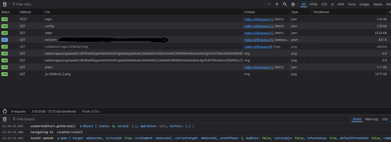

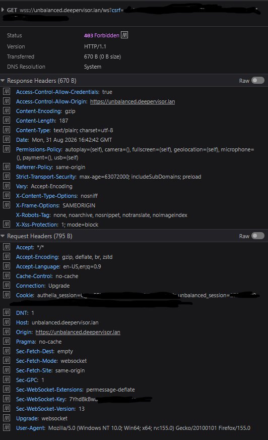

  2. the log at /var/log/unbalanced.log has these lines: 2026/09/10 22:17:49 [info] starting unbalanced 2026.09.10 ... 2026/09/10 22:17:49 [info] started service server (listening http on :7090) ... 2026/09/10 22:17:49 [warn] unable to get free/size data for some mounts: exit status 1 2026/09/10 22:18:19 [warn] rejected websocket auth: reason="invalid websocket origin" origin="https://unbalanced.unraid.lan" allowedOrigin="http://unbalanced.unraid.lan" host="unbalanced.unraid.lan" forwardedHost="unbalanced.unraid.lan" forwardedProto="wss" forwarded="" remoteAddr="x.x.x.x:44036" sessionCookie=true csrfPresent=true csrfMatches=falseI see a mismatch between "origin" and "allowedOrigin", where allowedOrigin is plain http, while the origin is https. My reverse proxy serves an https page to the user, and on the backend connects to unbalanced on the http path. Still not sure why the LAN path specifically fails here, b/c the reverse proxy does this for the external domain too. I thought my configuration would use the exact same settings for either path. But I have to assume this is the cause. Edit: for the sake of completion, here is the yaml I have in my traefik config that controls the routing towards unbalanced. I have also tested this without any middlewares to see if they were an issue. Websocket was still rejected. http: routers: unbalanced-rtr: rule: "Host(`unbalanced.unraid.lan`) || Host(`unbalanced.external.com`)" entryPoints: - websecure middlewares: - chainAuthelia - mwErrorPages@docker service: unbalanced-svc services: unbalanced-svc: loadBalancer: servers: - url: "http://192.x.x.x:7090"

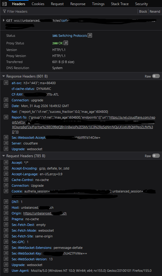

  3. Network tab w/ console for LAN failure: Headers for websocket 403: Success via external domain, if it helps: Headers:
  4. I've tested it and authentication works when using my external hostname, but it doesn't work with my local LAN hostname. Not sure why, because without authentication both work. Could be something in my config, but idk what could make authentication break only the LAN path.

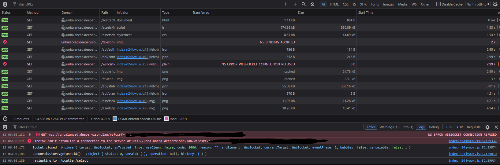

  5. Does it look like below? I get this error if I have the new authentication enabled in unbalanced's settings. If I disable the authentication, I get the below, and everything works, even behind the reverse proxy (traefik+authelia for me).

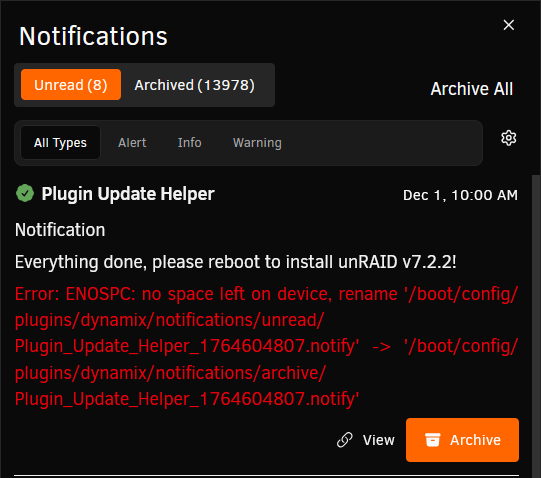

  8. I ran a couple of commands to delete all the disk temperature notifications which brought me from ~14000 notifications to ~4200. Archiving works now. If anyone runs into this in the future, these are the commands I used: # delete all notifications that have "temperature" in the filename rm -v /boot/config/plugins/dynamix/notifications/archive/*temperature*.notify # delete all notifications that have "returned to normal temperature" in the text content grep -lr '/boot/config/plugins/dynamix/notifications/archive/' -e 'returned to normal temperature' | while read -r line ; do rm -v $line done
  9. There are definitely a lot of older ones, you can see from my screenshot that there are nearly 14000. I didn't realize that would be an issue, and if it is an issue, I think I would expect Unraid to prune old messages itself instead of storing them indefinitely.
  10. Attached diagnostics right after I attempted to archive a notification. I've also tried navigating to the folder in bash and attempting to move it with mv, and I got the same error.

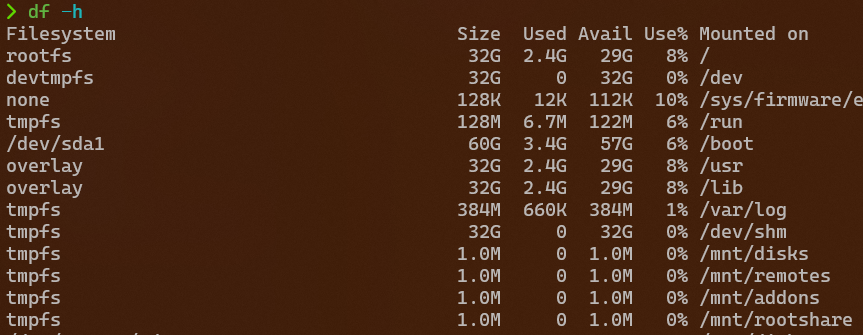

  11. See below. Every time I try to archive something, it says there's no space left on the device. As far as I can tell I have plenty of space left, and I'm not experiencing any other issues that would lead me to believe the flash drive was filling up somehow. Unraid 7.2.2.
