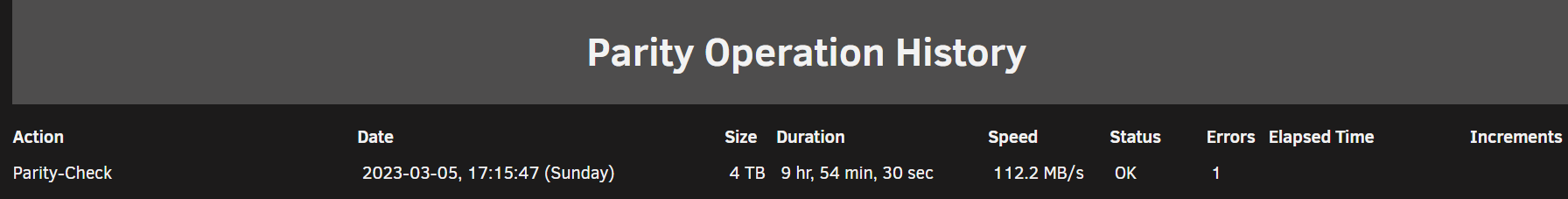

i think the Problem is after last Update:
i Canceled parity auto check that run on 1 day this month ,4 days ago ...
but then every day on morning when server start i have message 'unclean shutdown detected' , but no parity run. bu im checking nothing is running in console befor shutdown the server at every night. and was no problem befor week maybe.
So today in morning its run parity check becose unclean shutdown and i didnt canceled it.
but at end i have 1 error found , what does this mean?
didnt have errors befor ...

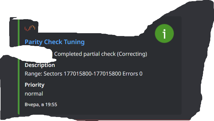

After Parity Problems Assistant on error sector :
As far as I know that simply means an error - why I have no idea.  It could be a spurious one or it could be genuine - no way to tell.  It is not unusual to have a small number of errors if there has been an unclean shutdown,
It surprises me that in the screen shot you posted the type of check is not shown since you have the plugin installed.
That suggest to me that it was OK at that address - if by any chance the previous check had been correcting that is what one would expect.   Not had a lot of feedback from people using the Assistant so not really sure how definitive it is in the real world although it seems fine in my testing (but there I had to simulate errors rather than having hardware that might be throwing genuine errors).
OK got it, Strange that not fixed by full parity check but then fixed by partial parity check...
