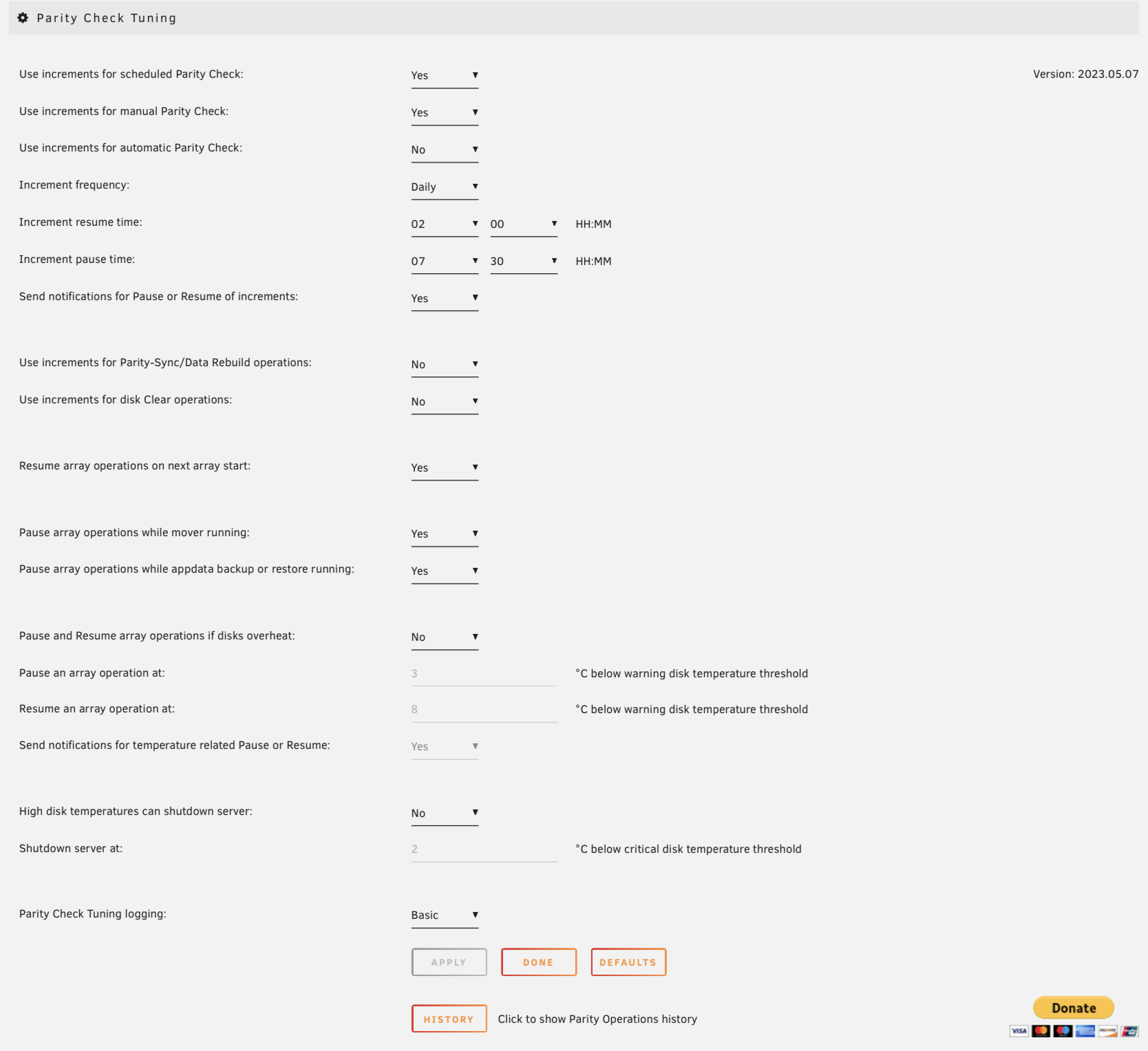

Hey there, I installed the Parity Check Tuning plugin last night and enabled the increments for a manual check option. My intention was to run a manual parity check for as long as I can until I need to pause it and then having it complete in increments in scheduled time. However, what I observed today is that despite not manually pausing the check at any point, it automatically paused it outside of the scheduled increment as it ended.
Jun 14 07:30:01 unraid Parity Check Tuning: Paused: Manual Correcting Parity-Check
Jun 14 07:30:06 unraid kernel: mdcmd (37): nocheck pause
Jun 14 07:30: 06 unraid kernel:
Jun 14 07:30:06 unraid kernel: m: recovery thread: exit status: -4
Jun 14 07:30:11 unraid Parity Check Tuning: Send notification: Paused: Manual Correcting Parity-Check (38.7% completed)
Jun 14 07:30:11 unraid Parity Check Tuning: ... but suppressed as system notifications do not appear to be enabled
For reference I am running 6.12.0-rc8.
Not a big issue, but thought I’d post in case it is a bug. Although I may have just done something wrong. My settings are attached.

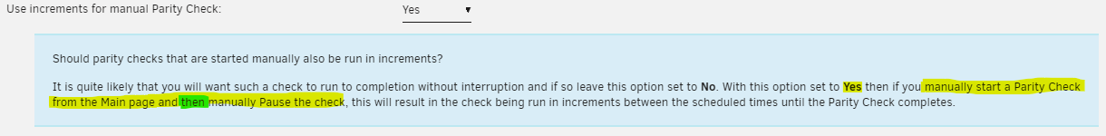

That is expected behaviour as the moment the plugin detects a Manual Check has been started and you have set the option to run manual checks in increments it will automatically pause the check if it is outside the increment period (ready to restart it when the next increment starts).
the only way you would achieve what you want is not enable the option to pause/resume manual checks until you are ready for the plugin to start doing this.
Oh ok, upon re-reading the explanation for the setting I can see how I misinterpreted it.
I thought that it only scheduled a manual parity check to continue in increments if two conditions were met: 1) a manual parity check had been started, 2) the manual parity check got paused. But I can now see this was only an explanation to demonstrate that the parity check would continue in scheduled increments and not a condition that needed to be met. Perhaps I could suggest an alternate description that may negate a misunderstanding like mine:
"With this option set to Yes; if you manually start a Parity Check from the Main page, the check will continue until the end of the next scheduled increment, and then use increments until the Parity Check is completed. Otherwise, if the Parity Check is manually paused, it will be resumed at the beginning of the next scheduled increment."
Feel free to use that if you want to change it or not if you think it'll just be more confusing or too long :)
Do you think it would be possible to implement the behaviour that I initially thought it would be without having to toggle the setting during a parity check? Without knowing how plugins, or the scheduler, or parity checks work, my initial thought would be to have some kind of flag parameter that is changed if a manual parity check is at any point manually paused. Then if this flag is set true, every time a scheduled increment starts or ends, it checks the flag and starts or pauses the parity check if it is true. Otherwise, if the manual parity check is then manually resumed, it sets the flag false. I'm not sure how difficult it would be to achieve something like this but I think it would be a very useful feature where you can run the parity check for as long as possible until you need better IO throughput, and then if you do manually pause it, it continues the check during scheduled increments until completion or until you manually resume it again. This way if you start a manual check at night with the intention of letting it run until midday where you might need to pause it, it doesn't automatically pause at the end of the first increment. I do see how this could be annoying for someone who just wants the manual check to be incremented, they could still achieve that result by starting the check and then immediately pausing it. I'd be happy to help in anyway I can if possible.

Parity check was already running due to manual resume so no start at 18:50 but it still automatically paused at 18: 55.
I thought maybe that I wasn't leaving enough time between the resume and start of the next parity check increment so manually resumed and waited ~35mins until the next increment start.
START - 19:30, END - 19:35.
Spoiler
Jun 20 18:57:39 unraid kernel: mdcmd (46): check resume
Jun 20 18:57:39 unraid kernel: md: recovery thread: check P ...
Jun 20 19:28:44 unraid ool www[3931]: /usr/local/emhttp/plugins/parity.check.tuning/parity.check.tuning.php 'updatecron'
Jun 20 19:35:01 unraid Parity Check Tuning: Paused: Manual Correcting Parity-Check
Jun 20 19:35:06 unraid kernel: mdcmd (47): nocheck pause
Jun 20 19:35:06 unraid kernel: md: recovery thread: exit status: -4
Jun 20 19:35:11 unraid Parity Check Tuning: Send notification: Paused: Manual Correcting Parity-Check (75.5% completed)
Jun 20 19:35:11 unraid Parity Check Tuning: ... but suppressed as system notifications do not appear to be enabled
It still paused the parity check at the end.
This is no big issue obviously but just thought I would share my findings. I finally have a UPS now so hopefully I can do less of these hahaha!
Edited by Swarles
@Swarles
The behaviour you should now expect is:
  • No action will be taken for manual checks unless you have activated that option within the plugins setting.
  • If at the start time for the increment the check is paused then it will be resumed
  • If at the end time for the increment the check is running then it will be paused.
  • if you have enabled the options to pause if mover/ca backup are running or overheating then this happens independently of whether you have manually paused or resumed a check.  The only caveat is that if paused due to one of these conditions AND manual checks are set for increments AND one of them caused a pause within the increment period then no resume is issued if they end after the increment end time.
if you manually pause or resume a check then as long as the above conditions are not met then the plugin should take no action.
I THINK this is what you described as happening?   I also think it will meet most peoples needs as the expectation is that you will set increments to run in idle periods when there is probably nobody using the server or looking at the GUI, and manually issue pause or resumes outside this time if you want them.
