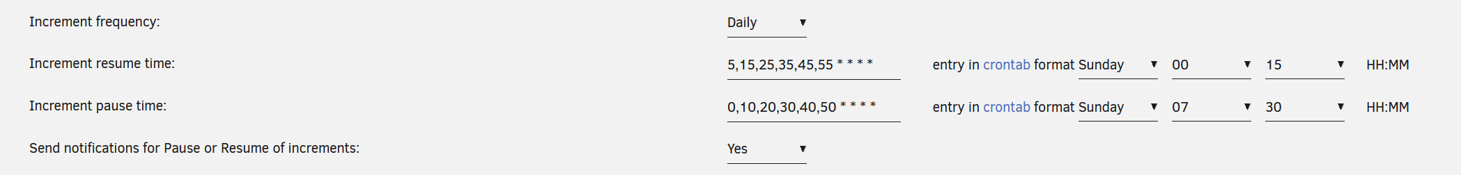

I'm not quite sure when this started, but my incremental parity checks don't continue to run after the first pause. When looking at syslogs, it says:
Nov 7 08:00:46 Unraid Parity Check Tuning: Send notification: mover no longer running: (type=normal link=/Settings/Scheduler)
Nov 7 08:00:46 Unraid Parity Check Tuning: Array operation not resumed - outside increment window: Scheduled Non-Correcting Parity-Check (25.3% completed)
But my custom cron job looks like:image.thumb.png.3a125be670ac6822434d97d5db1b1034.png

Nothing has changed recently in the handling around crontab.
The messages you display suggest that it is nothing to do with the increment pause/resume via crontab but instead to do with a pause being triggered by mover running and then the code that detects mover has completed deciding not to resume the check because it thinks it is outside the increment window.
If you not on the latest release then you could get this symptom when NOT using the custom scheduling option but as far as I know this is no longer the case.
The resume code that checks for current increment window is probably not working correctly when using the Custom option because I think it only looks at the increment start/stop times for the non-custom options.   It could be quite complicated to get it working for all combinations of the custom option so could you try setting the start and end times in the daily option to be the same as those you have set in the custom option and then see if it works as expected when you revert to the Custom option?  I may have to rethink how I am handling pause/resume around mover running so that using the Custom option does not break the resume.

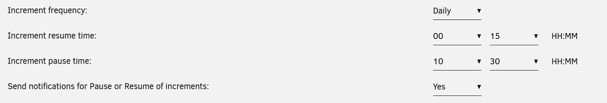

Anyway, I did try to remove the idea of a cron tab for now and changed the setting to be not custom but daily 8 - 11. Only problem with that is that it might run on the weekends, which his what i don’t want. But this is a start to the test.
It did run again this morning and continued properly:

the current code that checks if it is inside a timeslot after mover finishes does not look at the custom settings but only at those set on the daily/weekly option.    That was why I suggested you set the daily option to correspond to the timeslot in the custom option.    Having done that you can re-instate the custom option so that you do not even start increments at the weekend.
I think I have a solution for an alternative way of handling the timeslot checking which will also work when using custom scheduling, but I want to make sure it is well tested before I release it.
I have just pushed an update with the most notable changes being:
- Now improves handling of custom scheduling being used for increment pause/resume times
- Set most notifications to be at normal (green) priority.   The ones left at 'warning (orange) and error (red) level are ones where the user really wants to take notice of them.   I would welcome any feedback if this is an improvement or suggestions for changing the  priority of specific notifications.
Hopefully I have not broken anything, but please report any anomalies that are spotted.

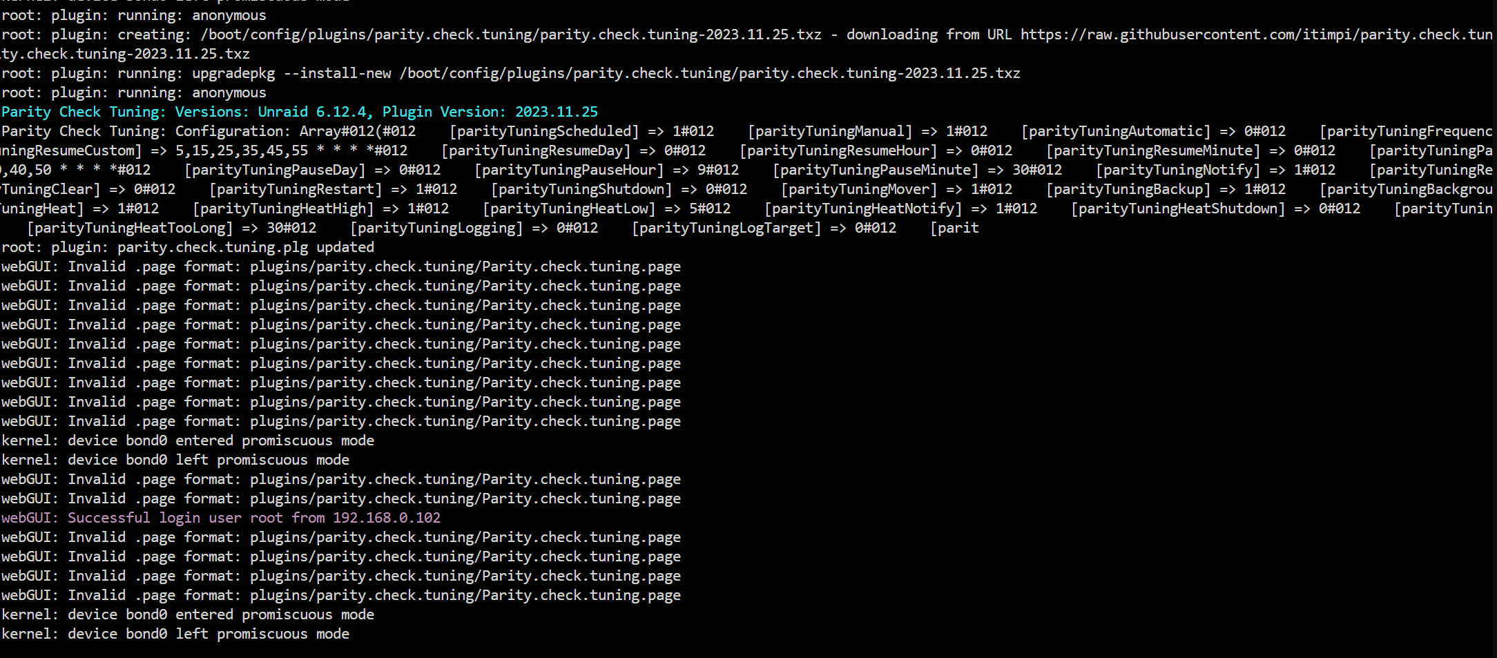

After last update , no plugin web page in schedule page :
After reboot still have this error:
Just reproduced that on one of my test environments - will look into why it is happening
Assistant page is working , but throw same error in syslog
Edited by Masterwishx
Appears some DOS end-of-line characters have crept into the .page files and this is upsetting the underlying language translation sub-system.    Just made sure that all files have Linux style end-of-line characters and am now checking to see if this rectifies the issues.
EDIT:   Just pushed an update that corrects the EOL issue as it fixes the problem on my test system.   Please confirm if it fixes it for you as well.
The effect of the problem was that the plugin was functioning in terms of its background tasks, but the Settings page was not displaying.
Thanks a lot, Working Fine now
