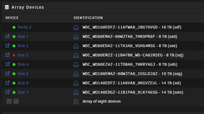

  5. Hey folks. Have an array with dual parity. Parity 1 drive died (replacement is on its way). System was working ok with it missing. This morning, disk 3 decided to disable out of nowhere: Attached are the diag logs. I've not rebooted yet as I've got a copy process with a couple of external drives in unassigned devices copying files off so i can preclear one of them). I'm not well versed in the logs info - anyone have any thoughts? Thanks! mediaserver2-diagnostics-20231202-1040.zip

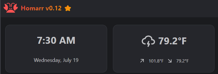

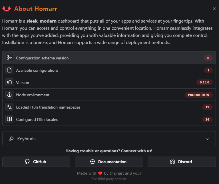

  6. Hey there! Homarr did have a docker update the other day, which was applied. Performed that update. Still running 0.12 (per my Homarr page): Having just now discovered the "About" entry on the hamburger menu (never really had use to hunt around/look at the hamburger menu lol), seems it has updated to 0.13: So it appears that the version info at the top left of the window just didn't get updated text-wise.
  7. I know it's available on github. The Homarr docker hasn't been updated to use that - thus my question. Unraid app store isn't showing an update available for it - I'm using the :latest tag as well...
  8. Any idea if/when the docker will be updated to the 0.13 version of Homarr thats on github?

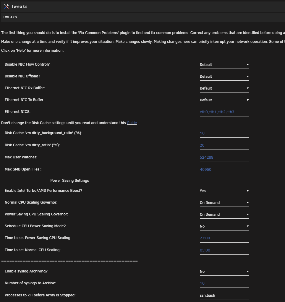

  13. Yup - that is the setting. Changed it to 1024000 and after a bit FIle Activity was seeing files. Thanks!
  14. Hmm - Is it the "Max User Watches" setting? If so, this is what I have currently:
