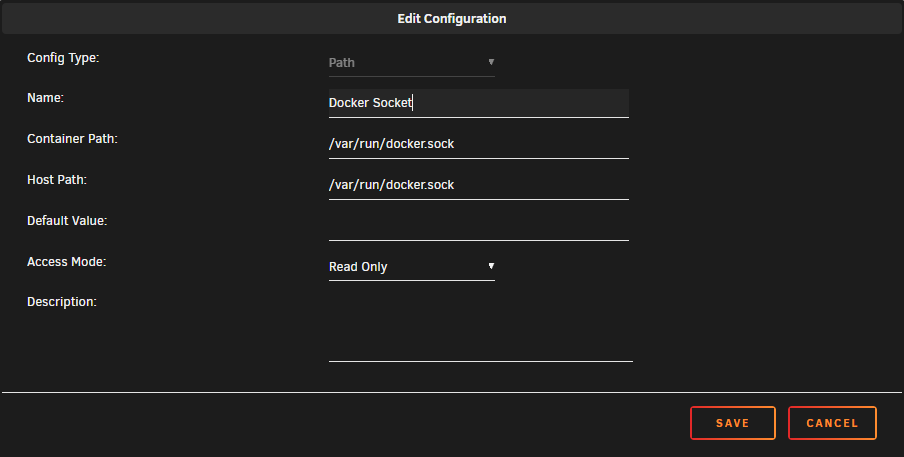

HI, I've installed Homarr but when trying to use the docker side of things I get the error 'Docker Integration Failed. Did you forget to mount the docker socket?'
I didn't forget as It wasn't mentioned anywhere. So how do I do this as I can't find any reference to it in the docs. I'm guessing I need to add something else to the image settings during setup but not sure what.

Same here. Just installed in unraid and getting this issue. Unsure what needs to be done to get this working?
Figured it out, we need to add the path /var/run/docker.sock for both host and container, set as read only. (found in the youtube comments of the IBRACORP video)
Just edit the Homarr container and click Add another Path, Port, Variable, Label or Device. Here is a pic of the inputs.
Nice, that seems to work.. I saw the youtube comments and what was said before but no idea what needed putting in configuration.. ty!
Thanks. Seems to be working now.

VERSION
v1.4 (2022-08-14)
- New: Added Docker Socket path to allow restart, stop, start, refresh and remove containers as well as add them to the dashboard (Homarr v0.8.0).
- Other: Added official website and documentation links to the support thread.
Edited by SmartPhoneLover
First of all, sorry to all of you about not updating the template. I was having an issue with my email client days ago, and I was not checking the forums for changes. Now it's updated with the latest changes.
@bobby @RyanServer711 @spamenigma @kri kri
The Docker Socket path is now added to the unRAID template. The template will be updated in a couple of hours since right now.
