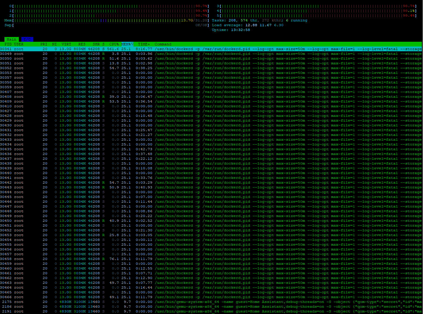

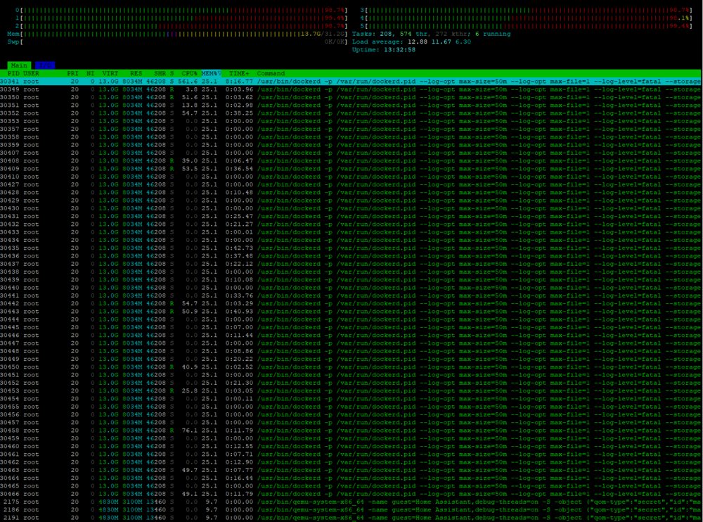

the script does not do anything eating ram. Some docker container seems to freak out. No idea why.
can you see with the docker command line of that affected process, which source container this is? htop should show some infos for that process.
Sorry, I didn't post the screenshot earlier. There is no one particular docker which consume RAM. Seems it is the docker itself, as all of the processes share the same amount memory.Zrzutekranu2025-01-01143338.thumb.png.7a635e4e90218fecb3c7a0f623ff8a67.png

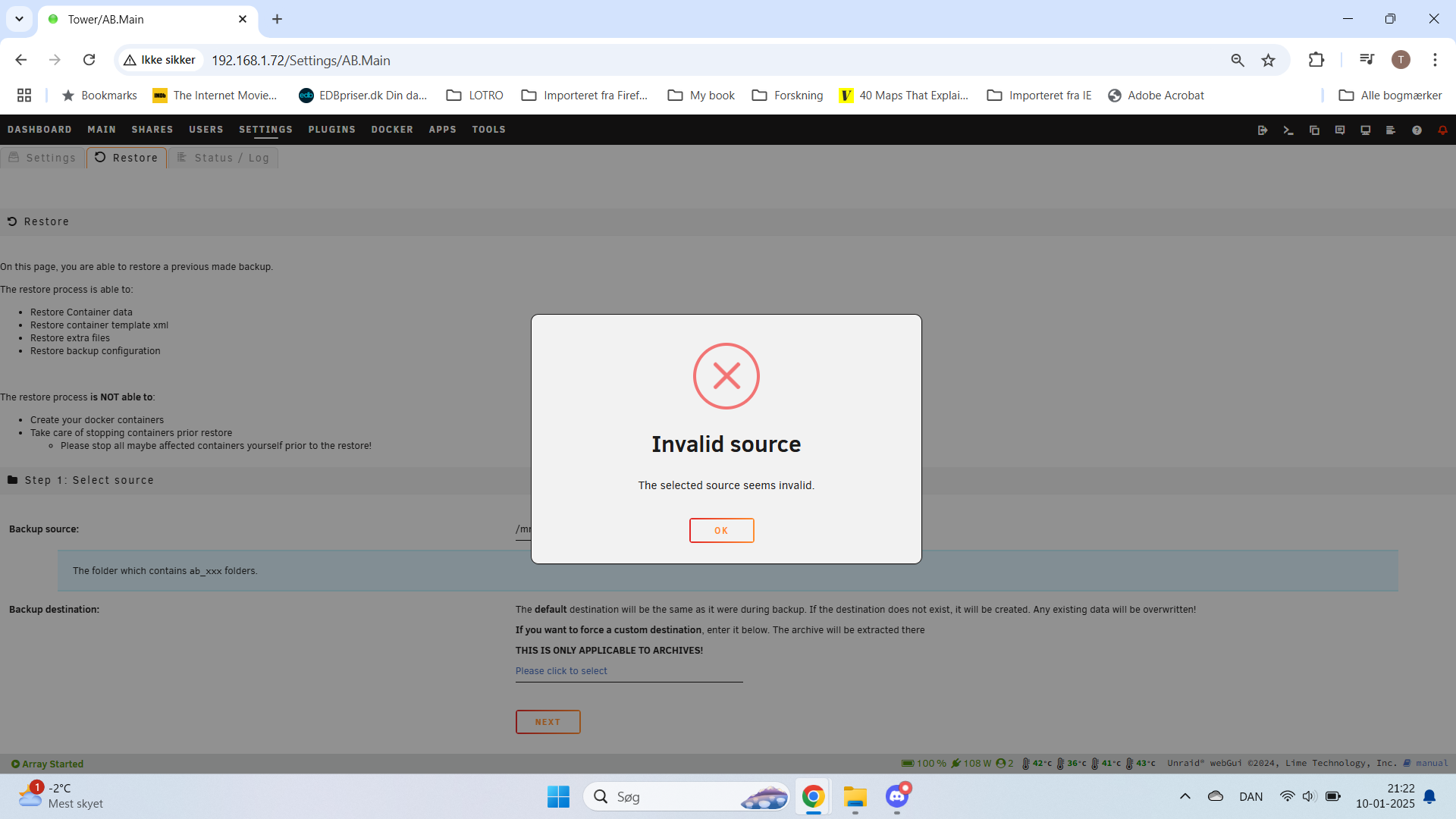

I have had problems with a spare cache drive I used to use. Now i removed it, backing up file before. Unfortunately all my appdata is gone. Have 2 backups from this app from last of december, but it says source seems invalid when i restore. There is nothing in log, as it does not do anything. Have can I switch it on? Anything else i can do? The files are in tar.gz format + the .xml and .bak files. Really desperate
Source really valid? Check help text, point to the folder with the ab_ folders inside.

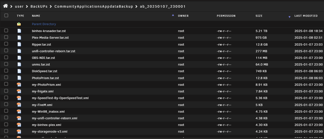

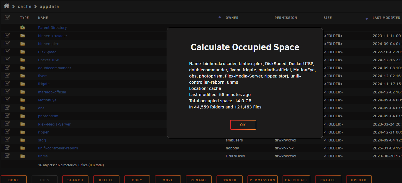

Hi so i was cleaning up things today and i noticed my appdata-backup backup file was massive!  around 6TB!  My actual appdata folder is less the 15GB!  Where are these extra files coming from?
The *.zst files for Krusader and Plex are surprisingly huge (5.2TB and almost 1TB respectively)...i don't even have that much in my media folder that plex looks too!  The backup files seem to have ballooned the last couple of backups, whilst nothing has really changed on the server!  It doesn't make sense that CA Appadata-backup is backing up my media (i don't understand how since its only pointing to the appdata folder...nothing else).  And how is the krusder backup pushing 6TB!?!?!?  that seems insane!
Again, the actual app data folders for these are tiny (as expected).
Trying to figure this out cuz its gobbled up my backup pool space!
THX!
Probably bad config where you made that container back up external volumes, or changed the appdata sources to include stuff it shouldn't so everything appears as internal
I have triple checked that the only thing that is being backed up is the flash USB, libvert, and appdata folder...and that folder is only a couple GB!  Is there a way i can open up that .zst file and see whats inside?  7zip, winrar etc do not recognise it (i kinda miss the old version that seemed much easier to look at the backups...or i'm doing it wrong).
Disable multicore and you have tar.gz. zst gets created when multicore compression is enabled.
However, check the log, maybe there are some hints. External volume backups? Whats the source paths configured?
Share a debug log, that should reveal the issue.
I did enable that (in hopes for smaller files)...is there no way (PC software) to open those file types?  is the compression even worth it?

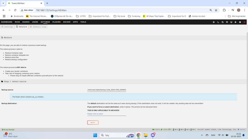

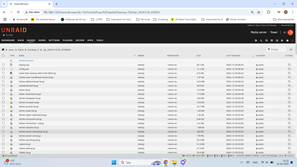

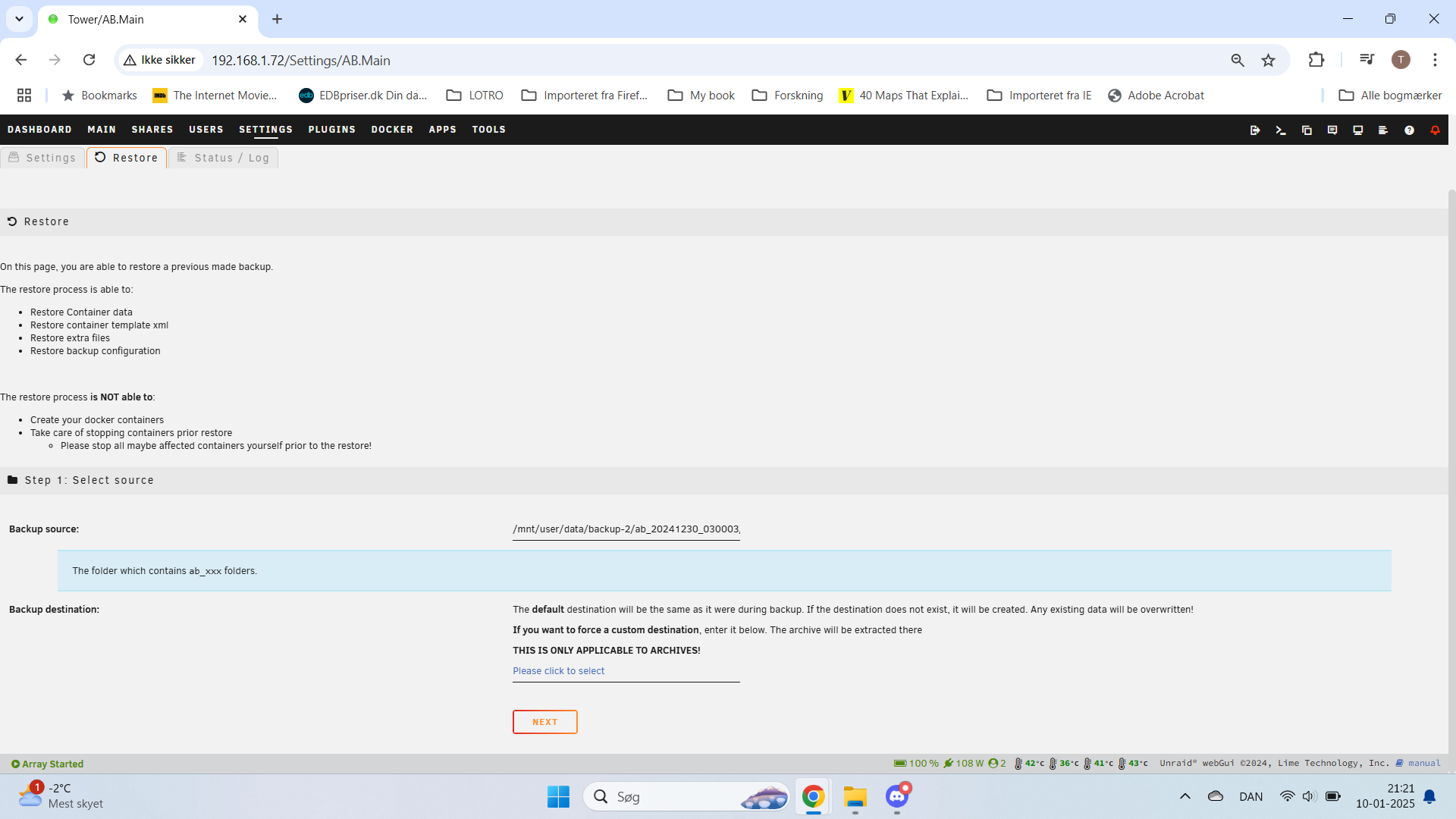

13 hours ago, KluthR said:
But it seems to have trouble to use the select parent folder. Could you share a screenshot with the restore UI and one with the contents of that selected folder?
The xmls are container templates and go in boot/config/plugins/dockerMan/templates-user
the .baks: not sure when unraid creates them, can probably be discarded.

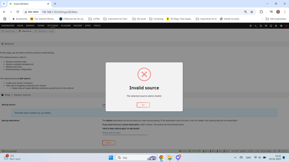

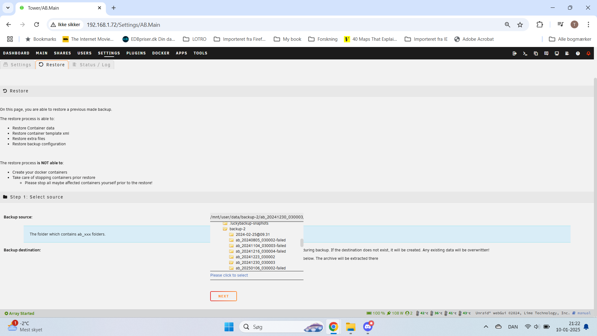

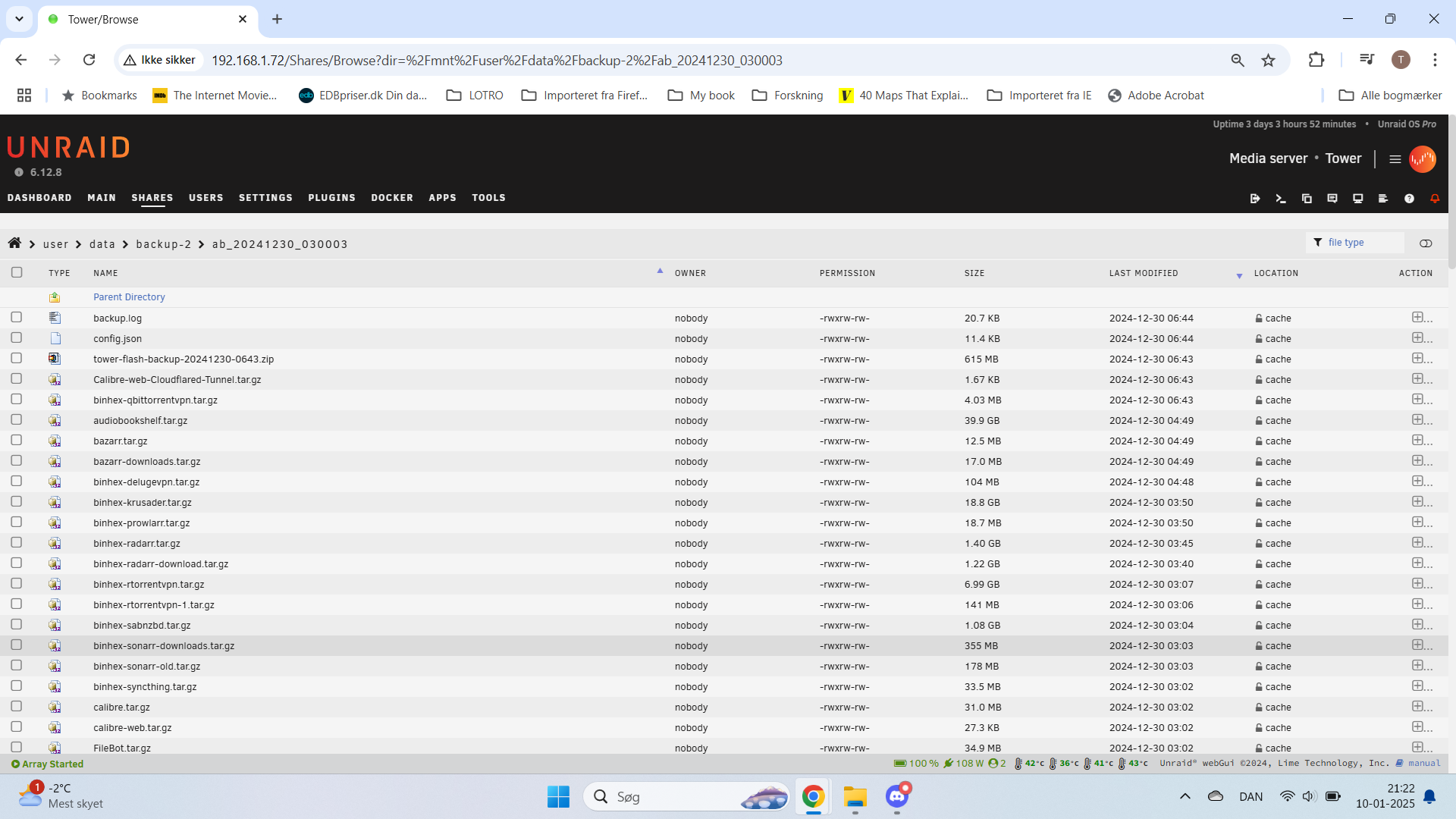

Thx for the reply. And struggling to unrar the files manually, seems I need to use console manually :(
55 minutes ago, Tyk said:
You must select the "backup-2" folder, NOT the individual backup. Next step will list the available backups to restore from.
OMG yes, did not see that it expanded below 🙈
It works. Just not sure what to pick after, do I restore backup config? And click all templates and containers?
Edit: Got it working, thank you for the help all, saved me tons of hours of work
