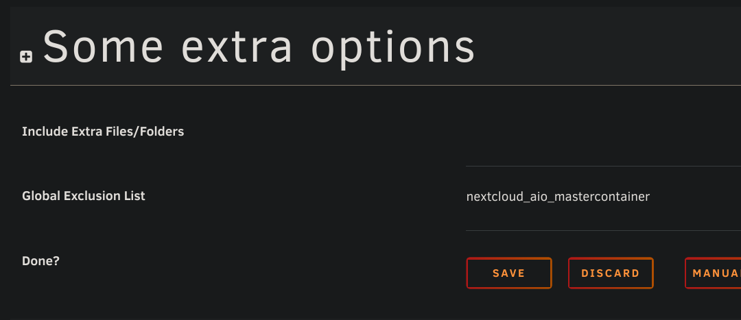

On 12/9/2024 at 11:01 AM, Kilrah said:
Yes, or put it as exlcuision under each container that has it separately. First is easier obviously.
That is not working!
The Log ID: ecb89b2c-77e1-4709-abf6-04b479d47422

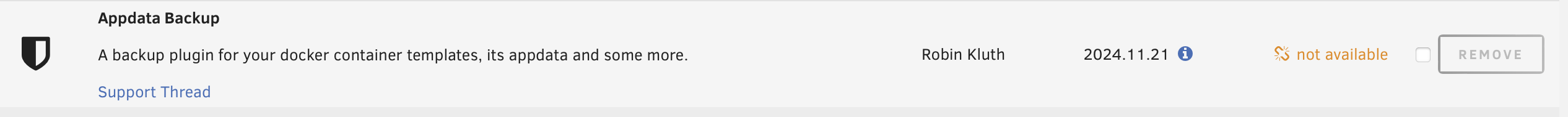

Out of the blue I get this error that its not available now. I haven't touched settings at all, it just has always worked correcly. Any idea what's going on?
Seems like an GitHub error. The plugin infos comes directly from GitHub repository.

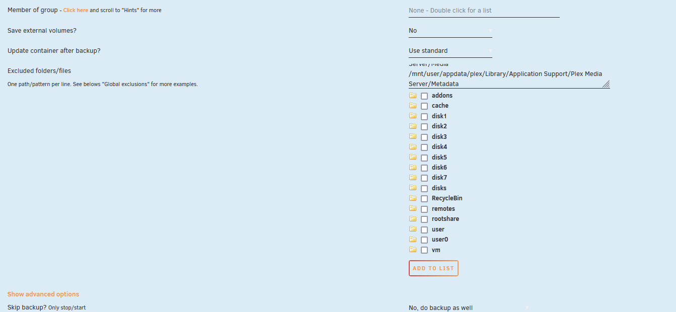

I noticed my weekly appdata backup was suddlenly HUGE 133gb per backup in size and it appears that the backup and restore appdata plugin is not ignoring the requested folders in Plex, its backing them up anways. Is this currently bugged?
Debug ID: 65e268a4-e3b3-457f-9909-2c259253839a
I did have to cancel the plex backup as I already left a backup running overnight which took an hour and a half to complete.
