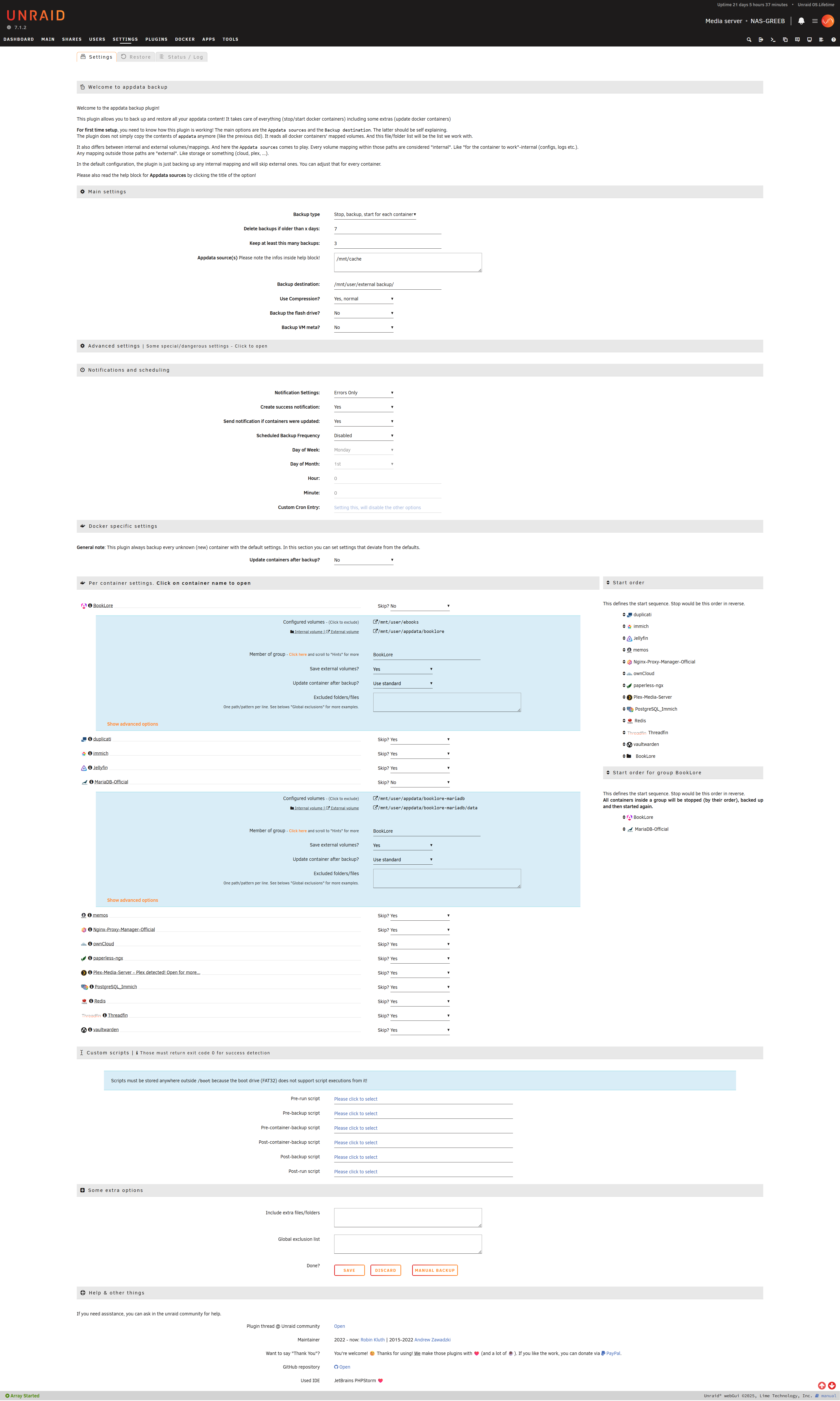

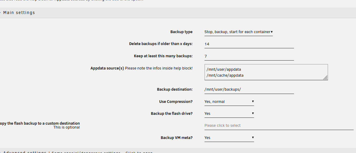

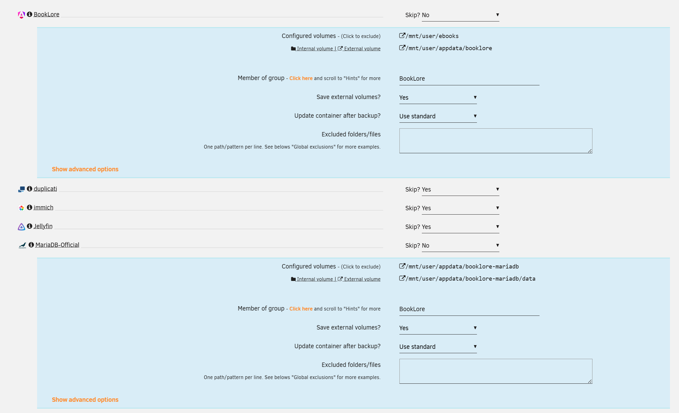

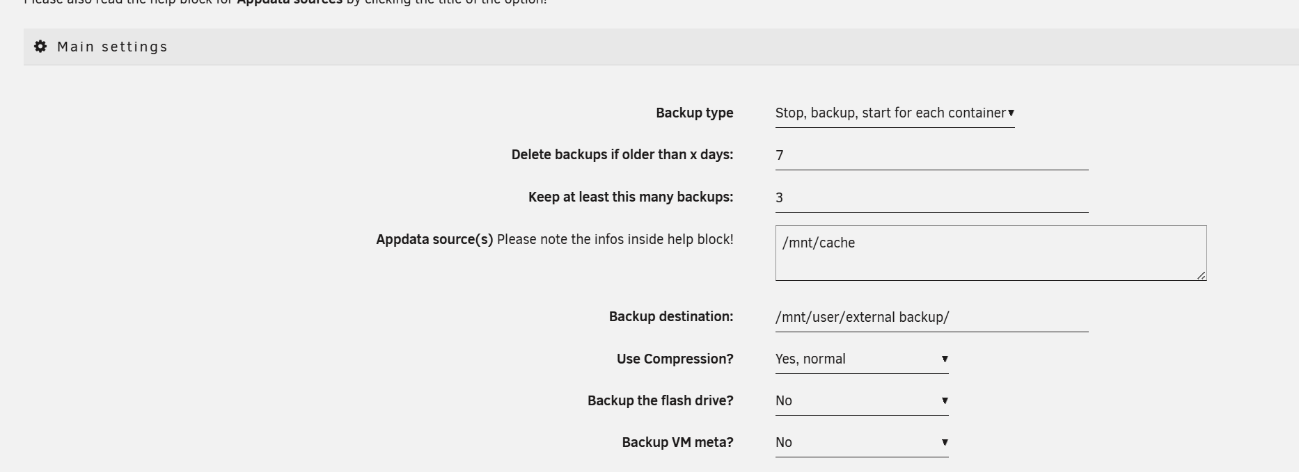

58 minutes ago, jensgreeb said:
/mnt/user/appdata/booklore-mariadb, /mnt/user/appdata/booklore-mariadb/data
Looks like you've for some reason manually added /mnt/user/appdata/booklore-mariadb/data as a folder to back up, even though it'd already be backed up since its parent is, and it's probably empty/missing hence the error
I also already checked this. I don't know where I manually should have added added /mnt/user/appdata/booklore-mariadb/data as a folder to back up.
Please find screenshot of my settings attached.
Can you help?
Many thanks.
Br
Jens
That's tiny and unreadable.
Edited by Kilrah
Upps, sorry, Please find better version attached.2025-06-26 13 21 36 (2).png2025-06-26 13 21 36.png
That would come from your booklore-mariadb container template.
But you've also changed the default appdata sources, which is why it's being detected as external instead of internal.
You fixed it - the default appdata sources were the problem.
Many thanks.
Br
Jens

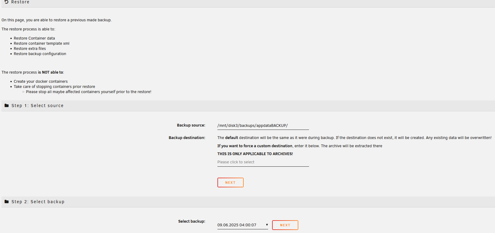

hi can anyone help me ?
following this thread:https://forums.unraid.net/topic/191384-unraid-working-strangely-lately-boots-randomly-and-now-parity-and-disk-1-missing/
i'm trying to recover my appdata, so i can recover the config of my dockers.
long story short, original ssd cache (where appdata and dockers where stored) broke, replaced it, and forgot to copy the appdata to array before giving the broken ssd to the company for repair....
now i'm trying to recover it with appdata backup but there are several things i dont get it.
you need to install previous installed apps beforehand ?
when i do so, the apps are not installed completely. by that i mean (so far what i found):
the configuration i had is gone
I do have my plex library, but the media files are not accessible
custom network is gone
ip adresses are not set
also do you need to install previous apps before doing the restore via appdatabackup ?
maybe i got it wrong but i believed that appdata was where you stored the config files of the dockers and that's what i wanted to backup.
also, if i set appdata share to visible, it doesnt show anything when i search it remotely via windows10.
thanks and take care
No, opposite. You want to restore appdata backup first so that once you reinstall from previous apps the files are already there. Otherwise the app would start a fresh install since it doesn't have its existing data.
well i changed something in the config of appdata because no backup is available... omg stop shooting at me i'm already dead :)...
i remember increasing the days to keep the backup.
Edited by tomume
What's in your backup destination? You need to select the folder that contains all the backup folders, NOT a specific backup.
found it:
backup destination was not the same:
dunno why i i put it in appdatabackup.
How can i show thoses folders/files on the explorer when accessing the server remotely ?

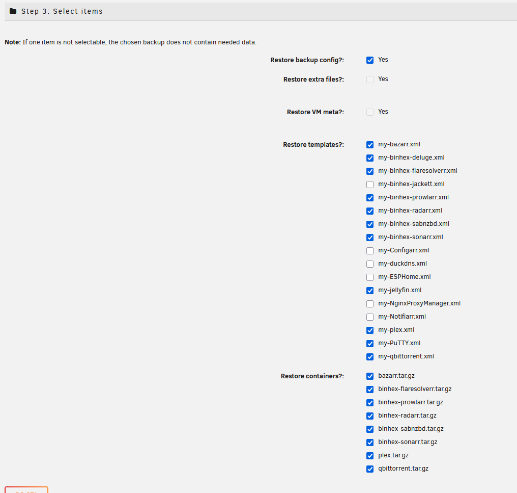

should i restore it like this (i don't care about unchecked apps) ?:
also what does it mean to restore container ? because you need to install the app after that right ?
Edited by tomume
"Restore containers" is what you want, that's the actual app data. Restore Templates is only needed if those were lost from the flash drive and don't appear in Previous Apps.
hi, thxs!
it seems they all work but flaresolverr and radarr.
flaresolverr:
radarr:
what can i do. i tried to reinstall it but it does the same thing. :(
thx a lot

13 hours ago, tomume said:
hi, thxs!
flaresolverr:
radarr:
thx a lot
for radarr, i deleted the database and restored from an old backup. that allowed me to keep the old config.
but for flaresolverr i have no idea. :(
