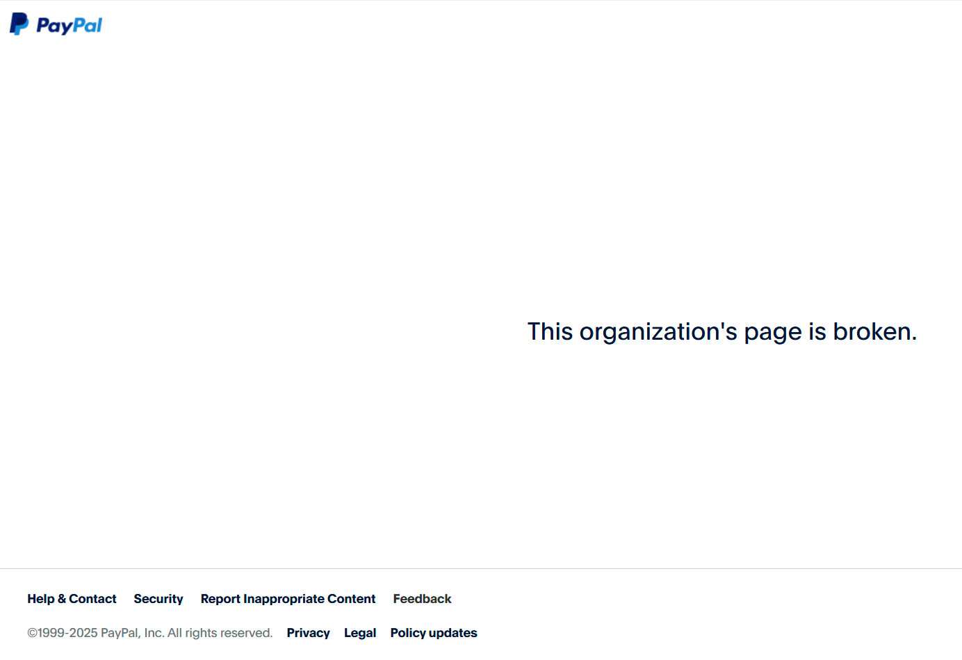

Just want to say thanks for continuing to maintain this awesome plugin! Just started using external volumes as well as backup groups and it just works! Thanks.
EDIT: FYI Your Paypal donate link is broken in the settings page of the plugin (https://www.paypal.com/donate/?hosted_button_id=KE7Z3KLEEY484)
Edited by cybrnook
