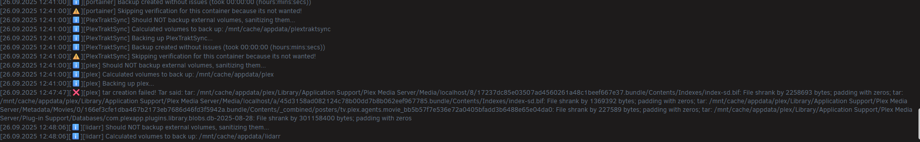

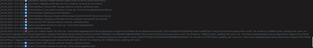

Plex backup isn't working for me.
"plex does not have any volume to back up! Skipping. Please consider ignoring this container."
I think the issue is this: "/mnt/cache/appdata/plex" is showing as external somehow.
Weird. I will look at debug logs next.

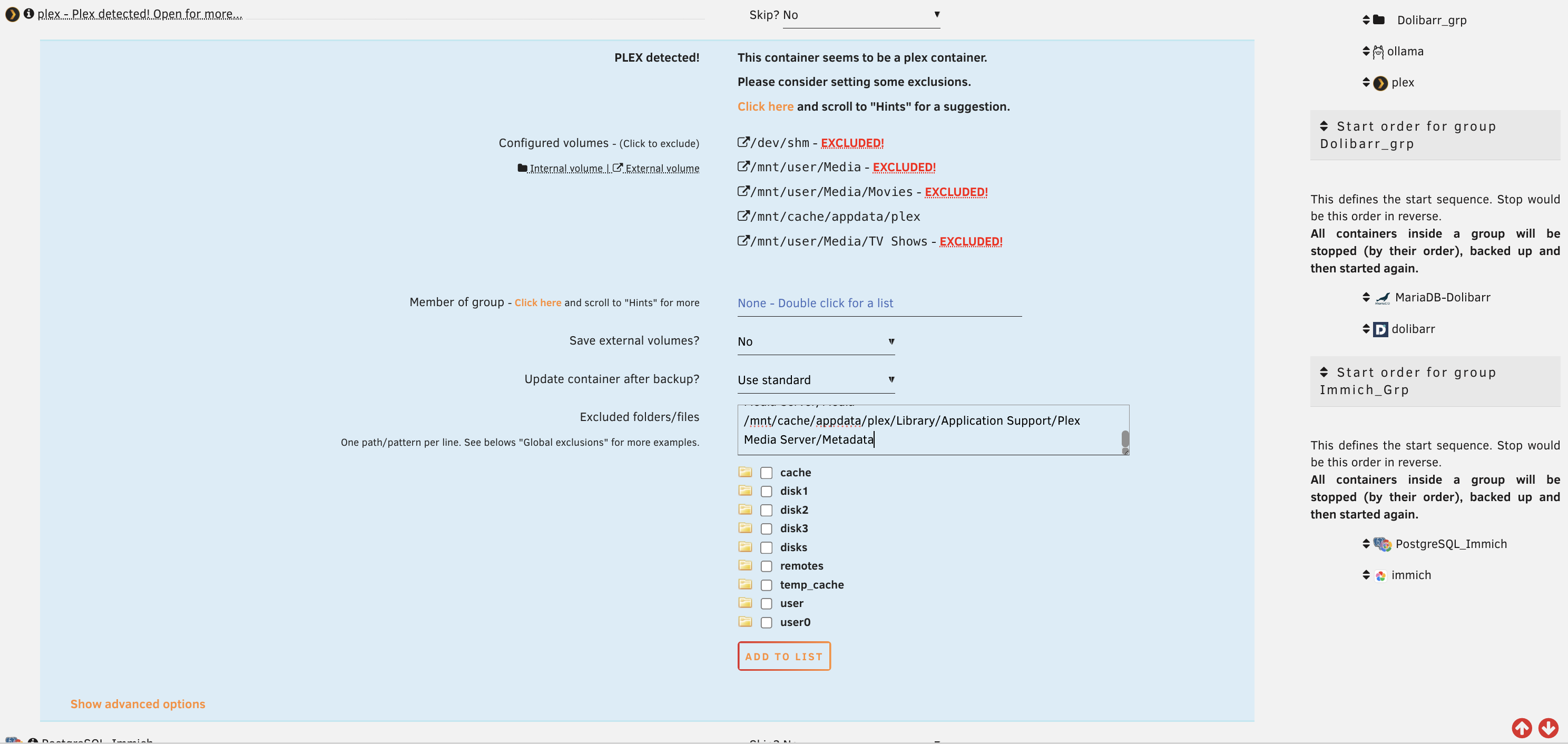

Also groups, you simply make one by typing text in the group field and hitting save. Current help text doesn't make a ton of sense. Hope that helps others.
That would mean that /mnt/cache/appdata is not included in the Appdata Sources setting.

@NathanR Yes, the grouping field is not that self explaining. I try to add some more text.
Agreed. However that is not the case as all my other dockers backup properly.
(I did not show that screenshot, but I have tried multiple source types in the settings box. Even going so far to list every plex sub-directory. All yield the same result.)

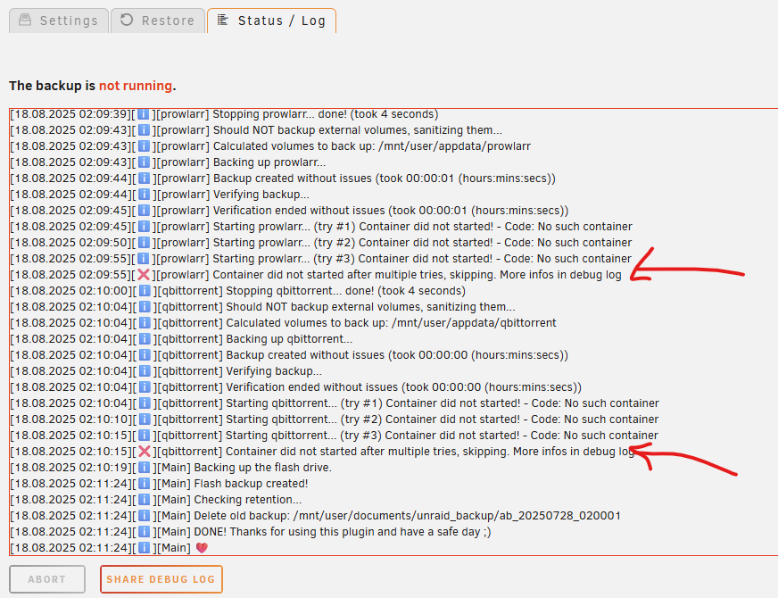

Hello all,
I got an error with my backup this morning and would like to read the debug log
However, I could not for the life of me figure out how to access the debug logs
I tried the "SHARE DEBUG LOG" button but all it does is send the log to the developer, and tells me that I can find the log at "/tmp/appdata.backup", which I have no idea where it is. I tried to look for /tmp/appdata.backup with krusader to no avail too
Can someone please tell me how I can access my own debug log?

On 9/15/2025 at 6:52 PM, Haskida said:
Does anybody know the answer to this?
Thanks in advance
Latest release has inplace button to switch logs.
Awesome! didn't realize a new update was available. I am able to see the debug log now.
Thanks!

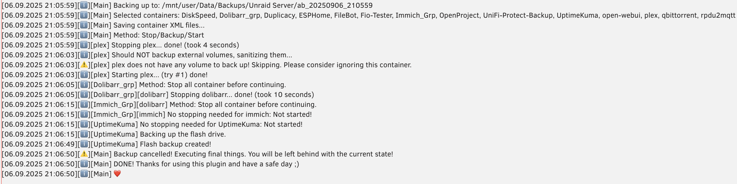

After updating to version 2025.09.17 the plugin throws an error after every backup. It seems to be caused by my use of folder groups (the FolderView2 plugin). It's done this multiple nights in a row now (set to daily backup).
It knows about the group, but ends up duplicating the group name as a container (i.e [backups][backups]. I have multiple groups, but there is one group that I've ignored two of the 3 containers inside and that's where the problem happens.
The debug log indicates that it hasn't identified the groups correctly; it only shows one, "backups", and my proxmox backup server container isn't in it. The other two (kopia and rsync) are set to skip.
ab.debug.log
Yea, seems like I maybe have messed up something there. Ill check it asap
I still dont see why the update triggered this (because I did not changed much within the grouping logic) but I found an issue regarding empty groups, which is your issue here. The plugin group is empty after resolving, because your only group member is set to "skip: Yes". Thats the only reason.
Please replace the contents from /usr/local/emhttp/plugins/appdata.backup/include/ABHelper.php with the contents from this: https://raw.githubusercontent.com/Commifreak/unraid-appdata.backup/bf027f6231487b8011573ca893fbc64f054f5b82/src/include/ABHelper.php
and let it run again. Please upload the debug log afterwards.

6 minutes ago, spyder said:
Your patch fixed it. Thank you.
The debug log confirmed it.
I make another test and will release a fix tomorrow morning. Thanks for testing!

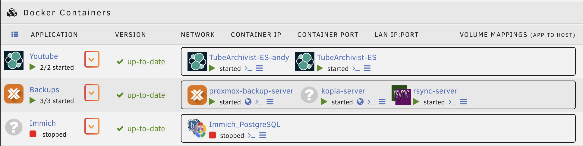

I've been having issues ever since i updated to the latest plugin. Plex fails majority of the time with similar errors. I've tried optimizing and cleaning up plex database prior to doing a manual update and it will give me a similar failure. Also tried deleting the offending file that it calls out but it then fails with a different file. Only source file I have backing up is /mnt/cache/appdata. For Plex specfically, i have /mnt/cache/appdata/plex as internal. My temp transcode and media folder is set as excluded.
Looks like multiple containers sharing a data folder but not being grouped for start/stop.
