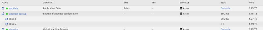

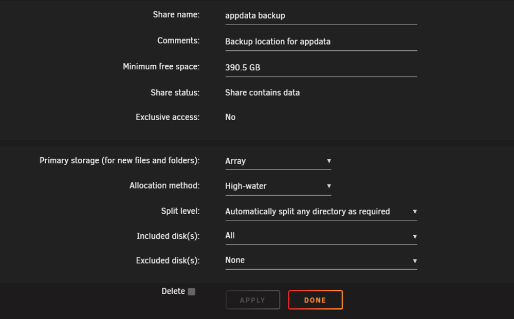

21 hours ago, Kilrah said:
Says no space, so check drive utilization and the min free space setting for that share.
Thanks @Kilrah
I spotted that, but was unsure which share this relates to... I have a "/mnt/user/appdata backup" share which I created to store these backups, but it has plenty of space...
Edited by SliMat
As mentioned you have to check the min free space setting of that share, e.g. you may have 5TB free total on the array but if the min free space is set to 2TB and no single disk has more than 2TB free the share will appear as full.
Apologies - I just realised I was logged on to the wrong server, so the above readings are wrong... this is the server with this problem...
The minimum space is set to 390.5Gb and the share has 850Gb space... so should be OK, I think!
Incidentally, I checked the size of the backups and the folders are about 15Gb in size.
Edited by SliMat

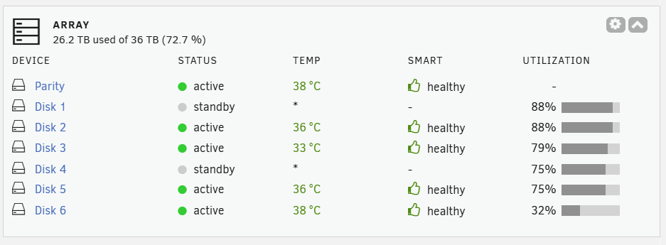

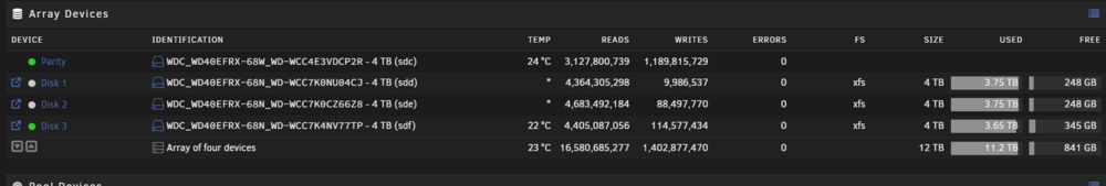

Still missing the list of the free space of each drive from the main page...
I had a warning from unraid saying one of my disks was getting full, which was weird cos I should have had several TB of empty space on that disk.
Turns out it was because the appdata backups were taking up huge amounts of space.
I have it set to delete all backups older than 7 days, but I instead have several months worth of backups in the folder lol. I'm manually deleting them now, but is this a known issue and is there a fix?
Are they marked Failed? If so that's intentional, when backup fails old ones are not deleted to avoid losing all last non-failed backups over time.
33 minutes ago, SliMat said:
So there you go, no disk has more free space than your set minimum of 390.5GB, so there is no disk suitable for storing more data for this share. Adjust min free space.

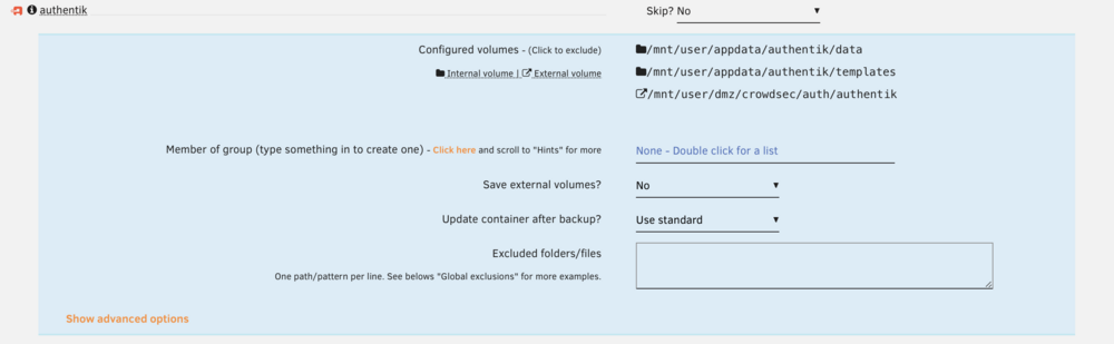

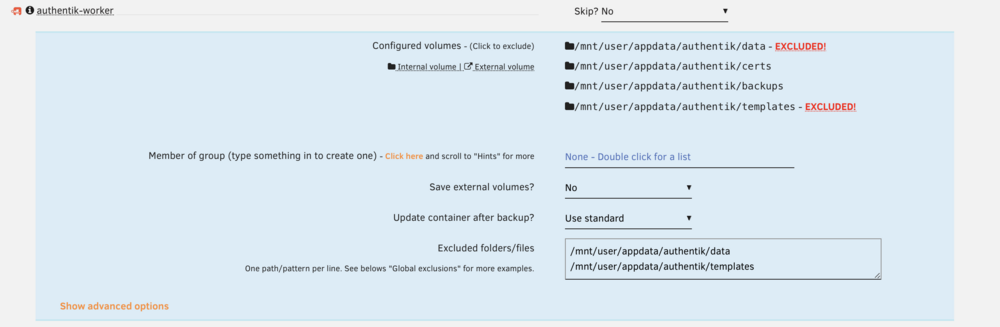

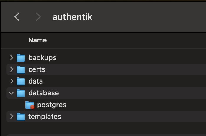

Hello everyone, hoping to get some help with a multi-mapping error
As far as I can tell, my other containers are backing up fine except my authentik appdata folder which is mapped to two containers authentik and authentik-worker
There was a recent update in folder structure to add a data subdirectory which works well but I think is causing issues on the backup side. I set some exclusions but I'm still getting errors.
Questions:
  1. What's the best way to solve this?
  2. In the authentik appdata folder there is also a database directory that holds Postgres data but doesn't show up in any of the configured paths. how do I ensure the entire folder is backed up? I assume it is a permissions thing but I am by no means an expert. just going off what I see when I look at the files on macOS
Please see my screenshots and log below
Thank you!
[21.01.2026 09:43:29][ℹ️][authentik-worker] Stopping authentik-worker... done! (took 1 seconds)
[21.01.2026 09:43:30][ℹ️][authentik-worker] Should NOT backup external volumes, sanitizing them...
[21.01.2026 09:43:30][ℹ️][authentik-worker] Calculated volumes to back up: /mnt/user/appdata/authentik/certs, /mnt/user/appdata/authentik/backups, /mnt/user/appdata/authentik/data/media
[21.01.2026 09:43:30][ℹ️][authentik-worker] Backing up authentik-worker...
[21.01.2026 09:43:30][ℹ️][authentik-worker] Backup created without issues (took 00:00:00 (hours:mins:secs))
[21.01.2026 09:43:30][ℹ️][authentik-worker] Verifying backup...
[21.01.2026 09:43:30][❌][authentik-worker] tar verification failed! Tar said: tar: Removing leading `/' from member names; tar: /mnt/user/appdata/authentik/data/media: Not found in archive; tar: Exiting with failure status due to previous errors
[21.01.2026 09:43:31][ℹ️][authentik-worker] Starting authentik-worker... (try #1) done!
[21.01.2026 09:43:33][ℹ️][authentik] Stopping authentik... done! (took 0 seconds)
[21.01.2026 09:43:33][ℹ️][authentik] '/mnt/user/appdata/authentik/data/media' is within mapped volume '/mnt/user/appdata/authentik/data'! Ignoring!
[21.01.2026 09:43:33][ℹ️][authentik] Should NOT backup external volumes, sanitizing them...
[21.01.2026 09:43:33][ℹ️][authentik] Calculated volumes to back up: /mnt/user/appdata/authentik/data, /mnt/user/appdata/authentik/templates
[21.01.2026 09:43:33][ℹ️][authentik] Backing up authentik...
[21.01.2026 09:43:33][ℹ️][authentik] Backup created without issues (took 00:00:00 (hours:mins:secs))
[21.01.2026 09:43:33][ℹ️][authentik] Verifying backup...
[21.01.2026 09:43:33][ℹ️][authentik] Verification ended without issues (took 00:00:00 (hours:mins:secs))

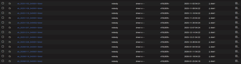

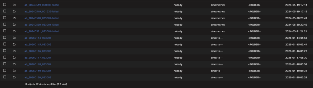

Hi all,
My cache SSD failed and I replaced it.
I'm trying to restore my Appdata but I just realised all my back ups have "-failed" against it.
But when I open the failed folder:
It actually has a lot of stuff in it.
Is there anyway to fix this "-failed" folder?
Check the log files inside them. If nothing special caused the error, remove the -failed suffix and they should appear in the restore assistant.

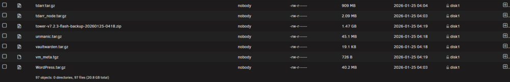

I checked the log and the only error was at the end:
[25.01.2026 04:18:51][ℹ️][Main] Backing up the flash drive.
[25.01.2026 04:19:56][ℹ️][Main] Flash backup created!
[25.01.2026 04:19:56][ℹ️][Main] VM meta backup enabled! Backing up...
[25.01.2026 04:19:56][ℹ️][Main] Done!
[25.01.2026 04:19:56][⚠️][Main] An error occurred during backup! RETENTION WILL NOT BE CHECKED! Please review the log. If you need further assistance, ask in the support forum.
[25.01.2026 04:19:56][ℹ️][Main] DONE! Thanks for using this plugin and have a safe day ;)
[25.01.2026 04:19:56][ℹ️][Main] ❤️
4 minutes ago, KluthR said:
Thats a summary. Somewhere in between must be another error.
You are right.
[25.01.2026 04:04:42][ℹ️][tdarr] Verifying backup...
[25.01.2026 04:04:57][❌][tdarr] tar verification failed! Tar said: tar: Removing leading `/' from member names; mnt/user/appdata/tdarr/logs/Tdarr_Node_Log.txt: Mod time differs;
This is the only one. Not a major issue if I don't have that one.
