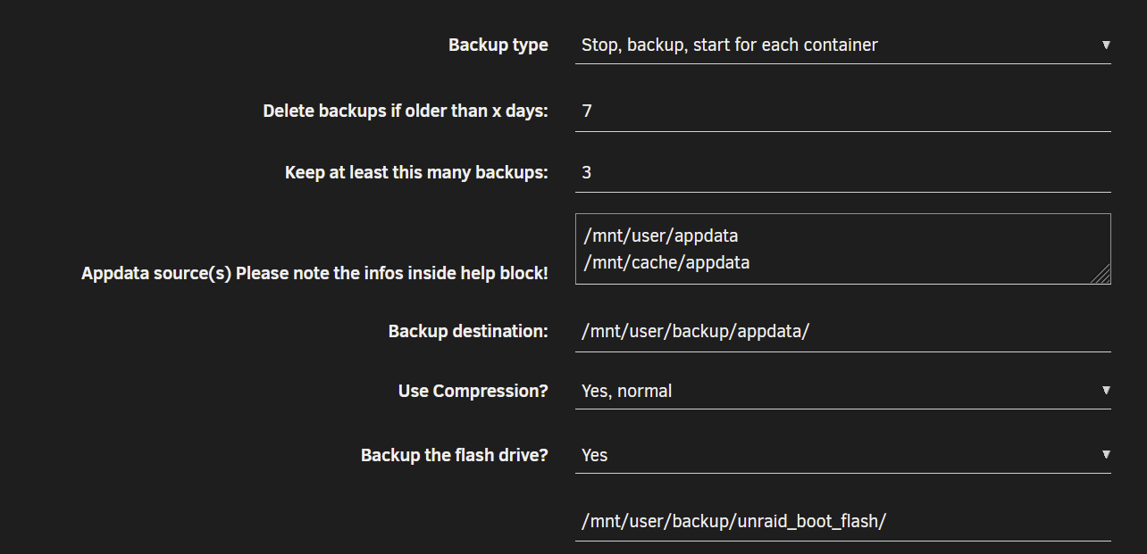

Is the retention policy intended to also apply to the automated flash backup?
I just realised that whilst my appdata backups are beautifully adhering to the 7 day retention policy, I have hundreds of old flash drive backups -- looks like they go back to when the server was set up and the plugin was first installed.
I can't see any errors in the logs, and the script seems to be only applying the retention policy to the appdata backups, so I suspect my install is working as expected, but always aware I might have screwed something up!
If this is planned, is there a recommended way to apply a retention policy to the flash drive backups?
Ps - Thanks to the creator/maintainers for all your work on this!
The flash backup is stored in the backup folder with the rest so as folders get purged it goes with them.
Problem is you filled the optional "also copy it to another location" field, and that is not managed.
Edited by Kilrah
OK this makes sense - I didn't interpret that path field correctly, and assumed that it meant that the flash backup would be stored in another path but subject to the same retention policy.
Hopefully it's not too common a mistake - I had hundreds of GBs being consumed by duplicate backups. All sorted for me now tho thank you!!

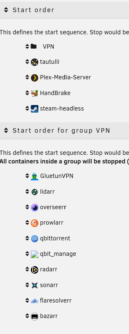

Try disabling auto-updates. AFAIK when the VPN container updates the others then can't find their dependency since the container got replaced by a new one. The Docker page update button takes care of that but maybe not this plugin.
Could be that your manual tests are always close enough to the previous one that there haven't been updates inbetween, but there is after a week.
Edited by Kilrah
The auto-updates are a useful feature but I have turned it off for now so we can at least see if it is potentially the problem. I also tweaked the start order in case the apps like Bazaar that are stopped are for some reason tripping up other app VPN apps. It is worth noting that when the backup fails, "Start All" in the Docker tab will not restart the apps. I have to restart the Server, Docker, or each App one-by-one. I have rebooted my server (and updated it to Unraid 7.2.0) and manually completed a backup. Will report back after the scheduled backup next week.
