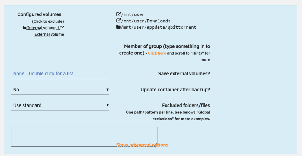

So after struggling for a few days to figure out why the plugin kept erroring out on a couple of my containers (specifically binhex-krusader and qBittorrent) I finally discovered the root cause.
They both have mappings to /mnt/user, for obvious reasons.
Having /mnt/user as an exclusion will cause the plugin to ignore everything in /mnt/user, which includes the container's appdata folder, even though the appdata folder is explicitly chosen to be backed up.
For anyone else who comes across this issue, the proper way to handle a container with a /mnt/user mapping is to not set an exclusion for those but instead set "Save External Volumes" to No.
Also on version 7.2.0, I'm assuming due to the new responsive WebUI backend, the option boxes for the plugin are a bit discombobulated, so make sure you're setting the correct option (the middle one) to No.

There is absolutely no reason to backup mnt/user That is what causing problems. I assume you have added that path to the docker container, but you should remove it. There is no need to map it. The two other paths are fine though.
Normally no container should have a mapping to the whole of /mnt/user, only the required shares under it.

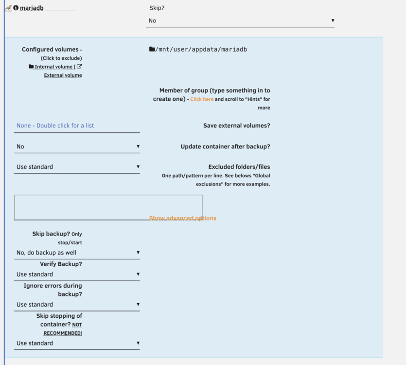

Layout is messed up on 7.2, normally the fields should be at the right of the labels.
Hopefully @KluthR will find time to do the 7.2 fixes at some point
Edited by Kilrah

Hey @KluthR have you noticed the broken layout since 7.2?
image.png?ex=6939a0a5&is=69384f25&hm=6b9d678838ca4114400282d415c689d7e22e77556ebd5cfa3c7441e533790c22&=
