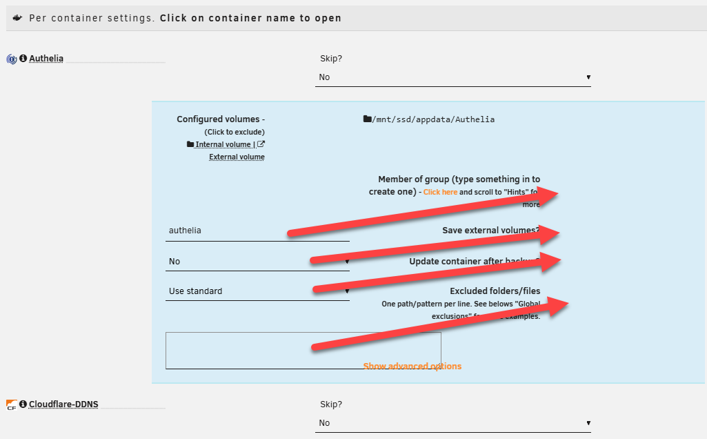

FYI On unraid 7.2.0-RC2 the layout is broken.
Absolutely understandable with the new responsive UI but still broken :P
